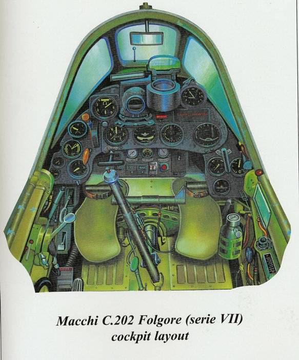

Hey Guys,
Sorry, had to revamp the page to get it to sit nicely.
I have a question. Has anyone got a good photo or detailed cokpit drawing. I have one that i'm using but a couple of other references would be great.
I'll post this on my site when I've finished drawing it.
One other question, what do you guys use for the dash backing, i was thinking of g-10 (pcb board), instead of ply or balsa. I can see the balsa would give a grainy effect and ply???probably the same problem.

Old 07-25-2003 | 01:03 AM
Joined: Jun 2002
Posts: 64
From: Gwynn Oak, MD,
Default macchi 202 folgore
Do you have this one?

Hi guys,
Firstly, I would like to appologise to RAGZ for hijacking his thread.
Secondly, I have updated my Macchi link with the former locations as requested by Scale aero.
Third, I have placed cockpit detail, canopy , undercarriage and lots more in the pages located within the Macchi directory.
I believe this is all useful stuff. I have used the cockpit file to complete most of my own cockpit.
Thanks Scalefan4, i put these pictures up for others on my site. These are from aero detail???
Happy building
Michael
Old 07-25-2003 | 12:25 PM
Joined: Jun 2002
Posts: 64
Some were from "Macchi 202 in action", the other was from this Russian book.
