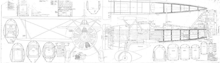

Here is the data on the planset already introduced into this discussion:
Power 2-5 HP Weight 24-26 lbs
H.P. ranges exceeding 100% of minimum recommendation would in my opinion be a red flag with respect to
weight ~ performance and the experience required for the design. BobH is correct, however there are other
contributing factors to raising a red flag this early on in your R/C trek. Building light weight equates to flying
more easily with fewer "landing" issues.
[link=http://plans.aerofred.com/data/media/38/Curtiss_P-6E_Hawk_Wylam_1of4.jpg]P-6E Hawk Fuse View[/link]
[link=http://plans.aerofred.com/data/media/38/Curtiss_P-6E_Hawk_Wylam_2of4_2.jpg]P6E Wing[/link]

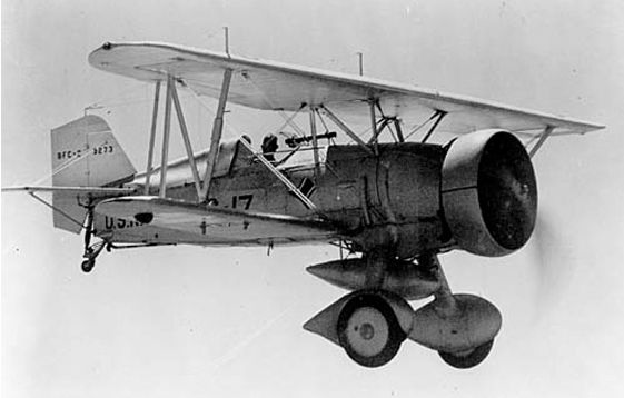

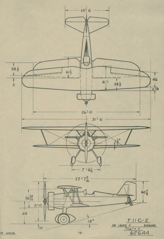

That F-11C-2 multiple view drawing is online and I recommend you downloading it...link is below the
image on its page.
You will notice there is a rather big difference between what appears below and what you saw when
you clicked the above link and downloaded the drawing you found there. Details...its all in the details
or in this case...disclosure.

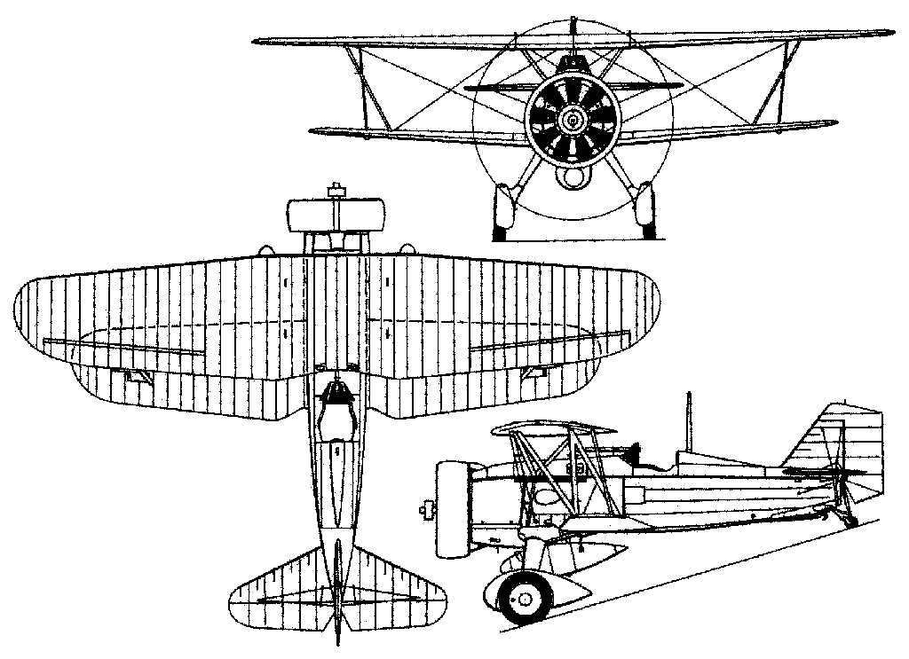

What all too often happens is you find an airplane you are attracted to. There's no definition for it, other
than what I call gegaw factor. Its the same reason a competitor selects a subject to build and fly in scale
contests. Its emotional...which should send a huge red flag up right away :^O
In other words if you are making a subject decision based on the bottom multiple view drawing... never
make a decision without at least two more multiple view drawings of the subject before you decide.
[link=http://plans.aerofred.com/data/media/38/Curtiss_P-6E_Hawk_Wylam_4of4.jpg]Second Perspective Of P6E[/link]
F-11C-2 is a radial engine version of the 'tween the wars F-11C-2 which provides all the gegaw
factor you could ever hope for.
[img]{akamaiimageforum}/upfiles/15437/Mk25768.jpg[/img]
Here is some useful documentation...depending on the version of the F-11C-2 you desire to build, build
docs first.
