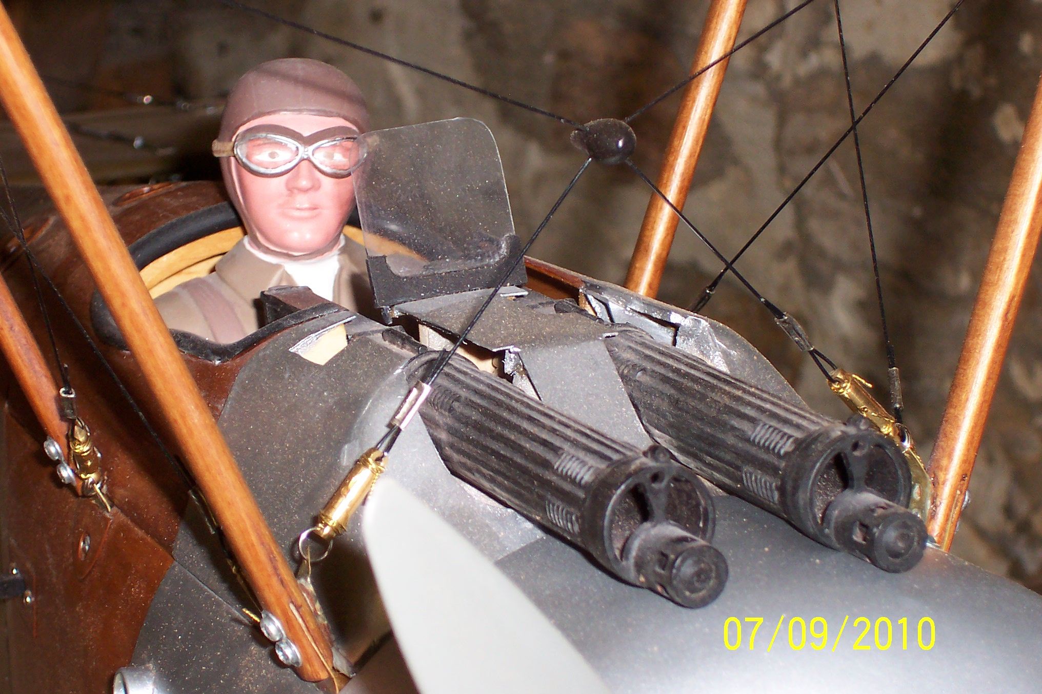

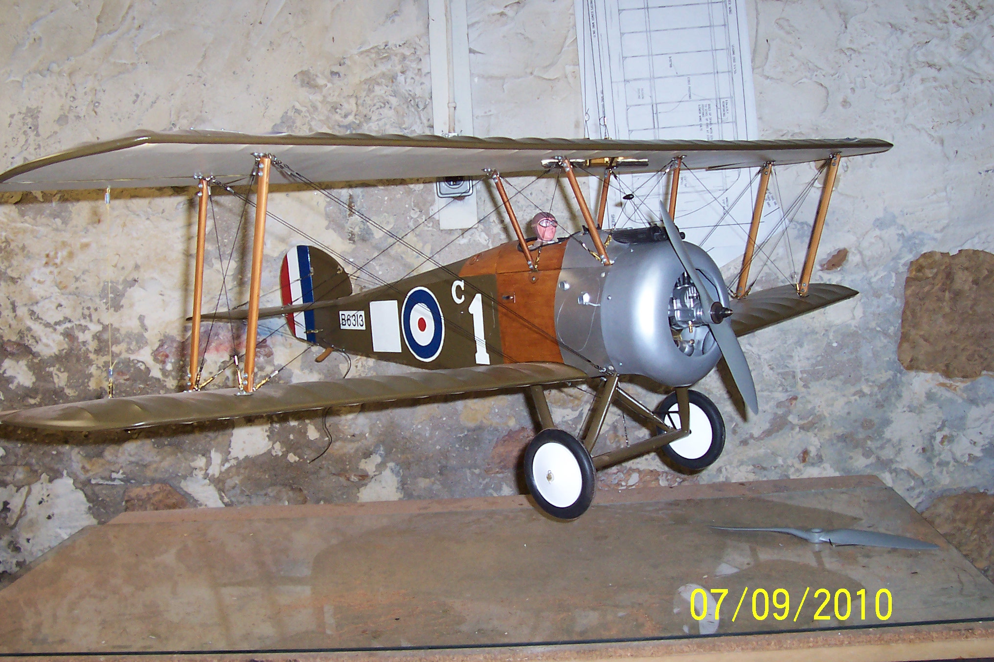

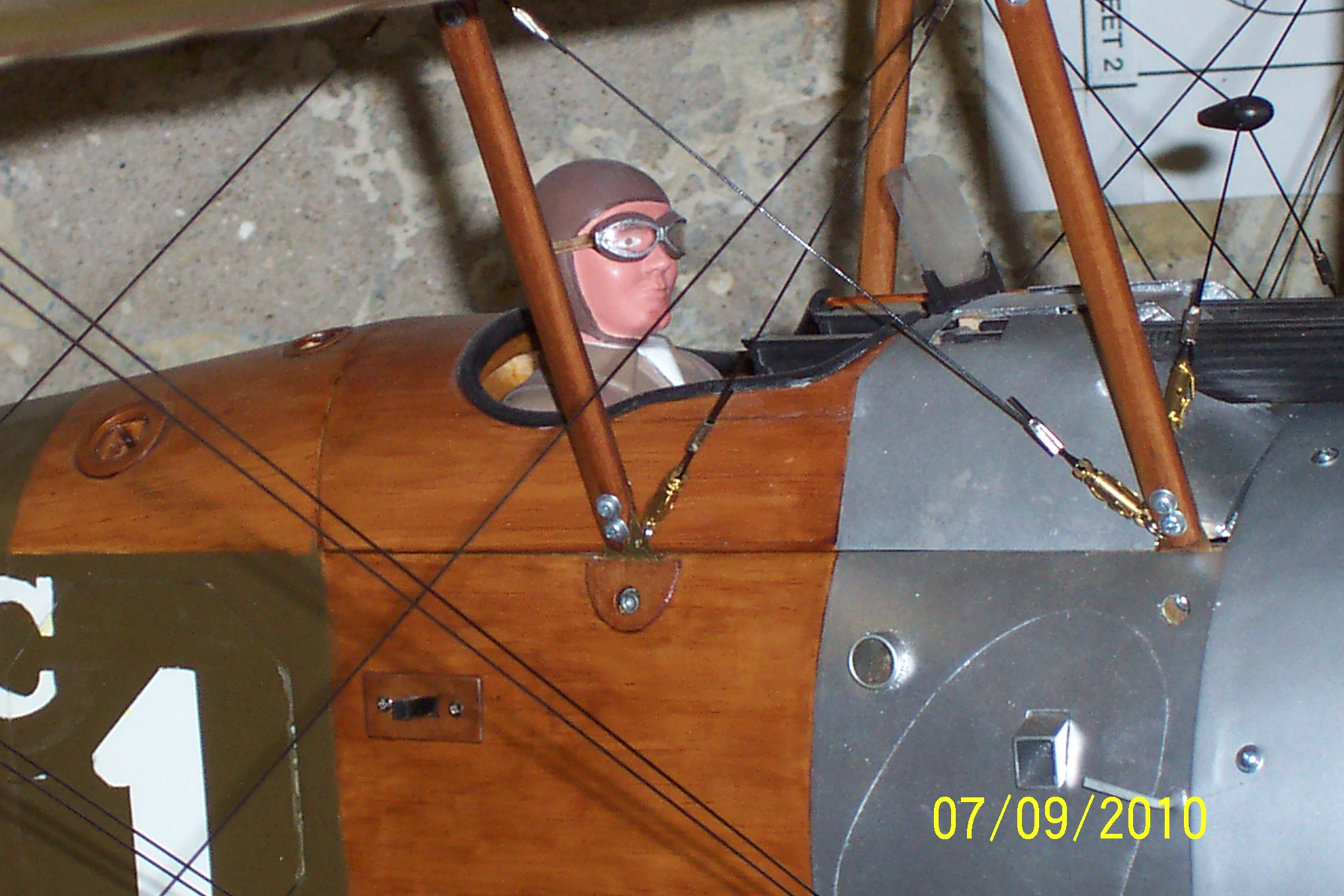

My first scale project and first scratch-build is FINALLY complete and awaiting maiden flight.
1/6 scale, 56 inch span. Weight 9 lbs 2 oz. Powered by Saito 56 turning a 12x6 APC prop.
This is of course William George Barker's B6313 in the colour scheme she had in November 1917 when he joined 28 Squadron.

ORIGINAL: eagledancer
whos kit?
No kit, scratch built from plans. Got the plans from Aviation Modeler International in the UK. I have construction photos on my website at [link=http://www.mts.net/~mhultin/]Phil's Airplane Pages[/link].

I enjoyed the build photos! Best of luck on the maiden. My guess would be that it'll be a fine flier in the air but a bit of a handful on the ground. Like most short-nosed models. Good luck!

Short-nosed indeed! I had to put 38 oz of lead in the inside front of the cowling to get her to balance! After trying to build light, it was a bummer to put all that deadweight up there but what can you do?

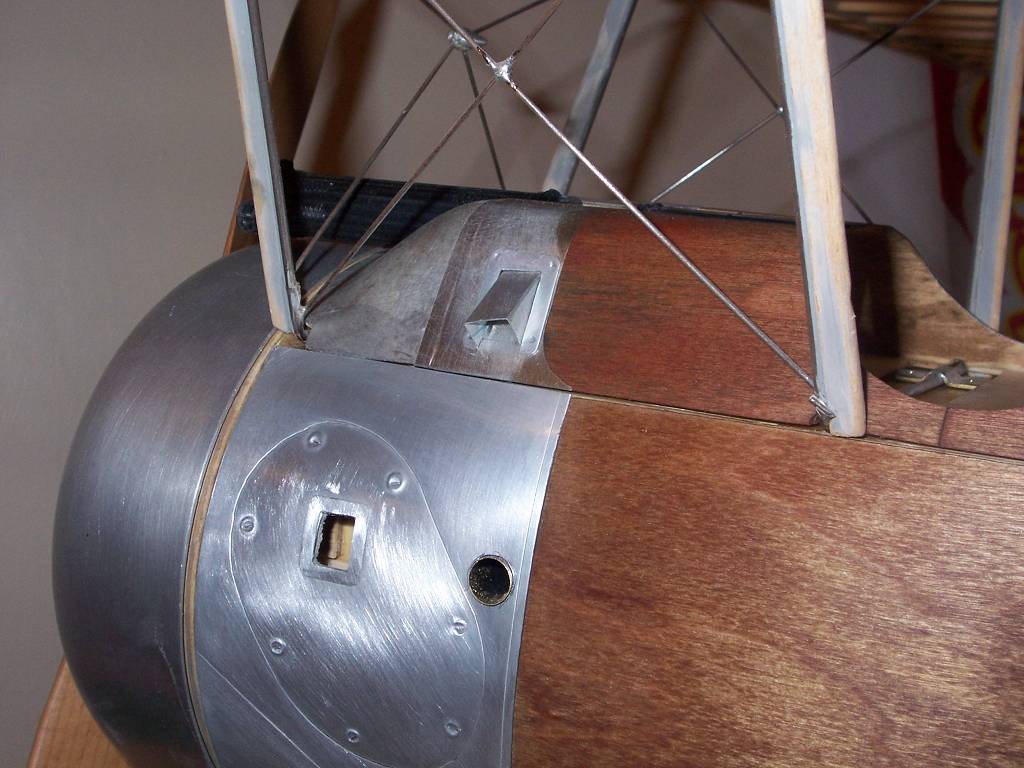

Hi,that's a excellent job you have done there !good luck with the maiden,must find the time to finish my one ( 5 years and counting ! ) and from the same plansas you.

Jeffski:
I see you used metal for the nose and cowling, and it looks really nice. I am not experienced in working aluminum, so I did my cowling as a fibreglass layup, and the rest of the metal work is actually 1/64 plywood.
Now that I know I needed so much nose weight, I would go with real metal in the future.
Also, I see you put in a more scale number and spacing of wing ribs. I would do the same if I built from these plans again.

ORIGINAL: fledermaus
The "metal" panels are so light that they are probably even lighter than the 1/64 ply that you ends up using, particularly once you add in the weight of all the paint and other finishing needed to make the ply look like metal. And really for the most part, making aluminum panels out of 0.3mm sheet is dead easy.
And there's just no avoiding the added lead up front with models of these sorts of short-nosed aircraft. I have 800g of lead just behind the dummy on my 1/6 scale Snipe! All you can really do is build the entire model as light as possible KNOWING that you'd going to have to add a lot of lead as part of the normal flying weight of the model.
