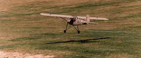

I just flew my old Dennis Bryant Storch last night. What a blast! I've had this plane for years and it's still going strong. I like to do STOL touch and goes. Start up high with full flaps and point it at the runway. Then you flair out at the last second and touch down. When you apply power it rolls about 3 feet and up she goes again. I also like to point it into the wind (full flaps) and throttle back, working the rudder and throttle to try and make it stand still in the air. You have to work the rudder hard to fly this plane because it can get so slow.
I blew up the .40 size plans to 102" and put a G23 in it. This was before the 94" one was available. Push gallery button below to see pics of it.
Good luck and have fun with it.

Thanks. Mine weighs about 14# and the G23 hauls it around pretty well. Yours will be a little smaller so I think the 120 should do fine. There's lots of drag on these so don't expect much top speed or aerobatics. About the only thing I can do with it is a loop after a little dive.
Dennis Bryant plans are awesome. There's lots of little bits to cut out but they all fit together nicely. Did you get laser-cut parts from Holman? That'll really save some time. I covered mine with SuperCoverite, which I can't seem to find anymore, so Solartex would work too. You can get it from Balsa USA.
I'll take some digital pics and send them e-mail. I'd be interested to hear your progress on this as it goes along.

Vincent how about some pics. ? Theres a fellow in a local R/C club actually who also owns a Svenson as well, building a 2/3 scale home built, i have been meaning to contact him and go have a look apparently its almost done complete with German style camo. cant wait to see it fly!
Storch etc.
Vincent- nice pics.
Re- your Storch, be careful with weight in the tail, 'wanna keep it light'
- I placed my elevator and rudder servos under the cockpit floor.

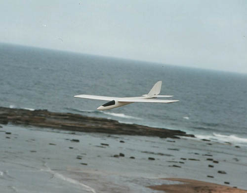

I have to ask about those awesome soaring pics in your gallery. I have done lots off coastal slope soaring in Sydney and east coast of Australia, and I just started drooling when I saw that mountain back drop... where is the location? I want to try that : )
amazing!
amazing!

There are actually two servo's for the elevator placed in the tail, also the rudder servo is there as can be seen in one of the pictures.
This is the url for the soaring paradise:
www.alpedhuez.com
This explains why this place is famous in Europe.
This is the url of the modelclub there:
www.pilotage-modelisme.com/
I assume that you know a little bit of french because you are from Canada.
I will post some more great soaring pictures in the near future of that trip. (taken by my girlfriend).
You also have some nice pics. I also really like jets, but for the moment they are to expensive. Hope you like the Avonds jets.
