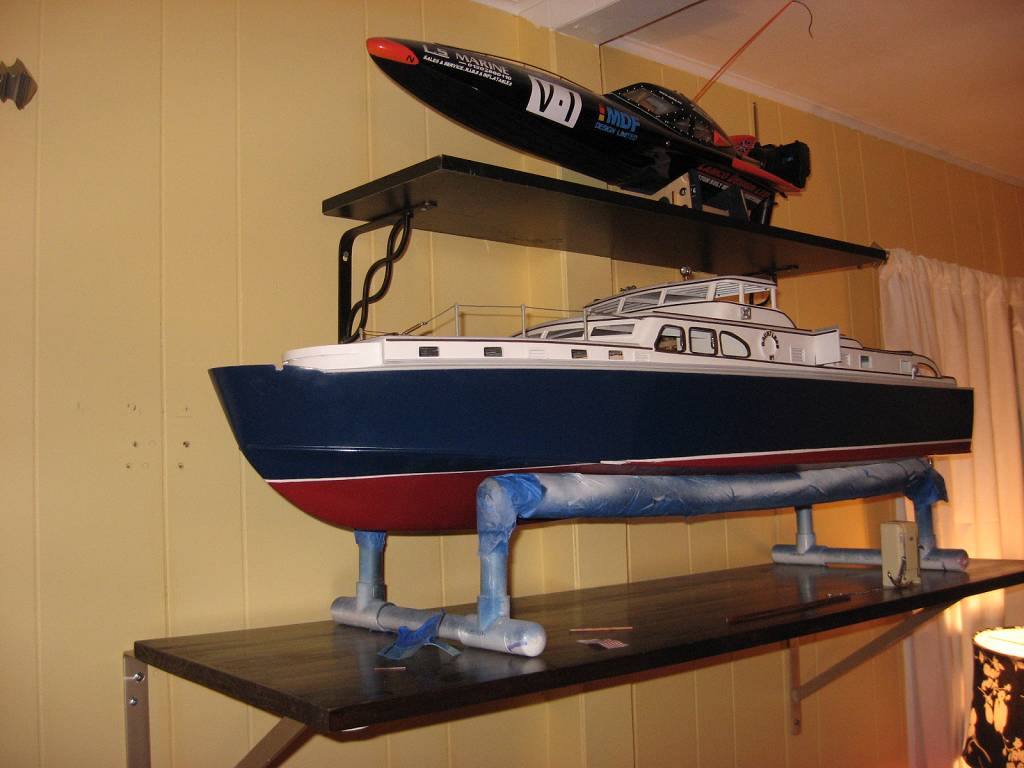

I WAS WONDERING IF SOMEONE COULD POST A PIC OF THEIR STAND THEY KEEP THEIR JERSEY SKIFF ON.IM LOOKING TO MAKE ONE FOR MYSELF OUT OF PVC.THANKS CHRIS

Hi Chris,
Below is a picture of a PVC stand that I am using while building my boat. This boat shares the basic hull style of a Jersey Skiff.
It was made from PVC pipes from Home Depot. There is also a two part glue for PVC that should be used. I also covered the PVC with foam pipe insulation as a padding.
I coveredthe foampaddingwith painters tape bacause I was painting.
-Rich.

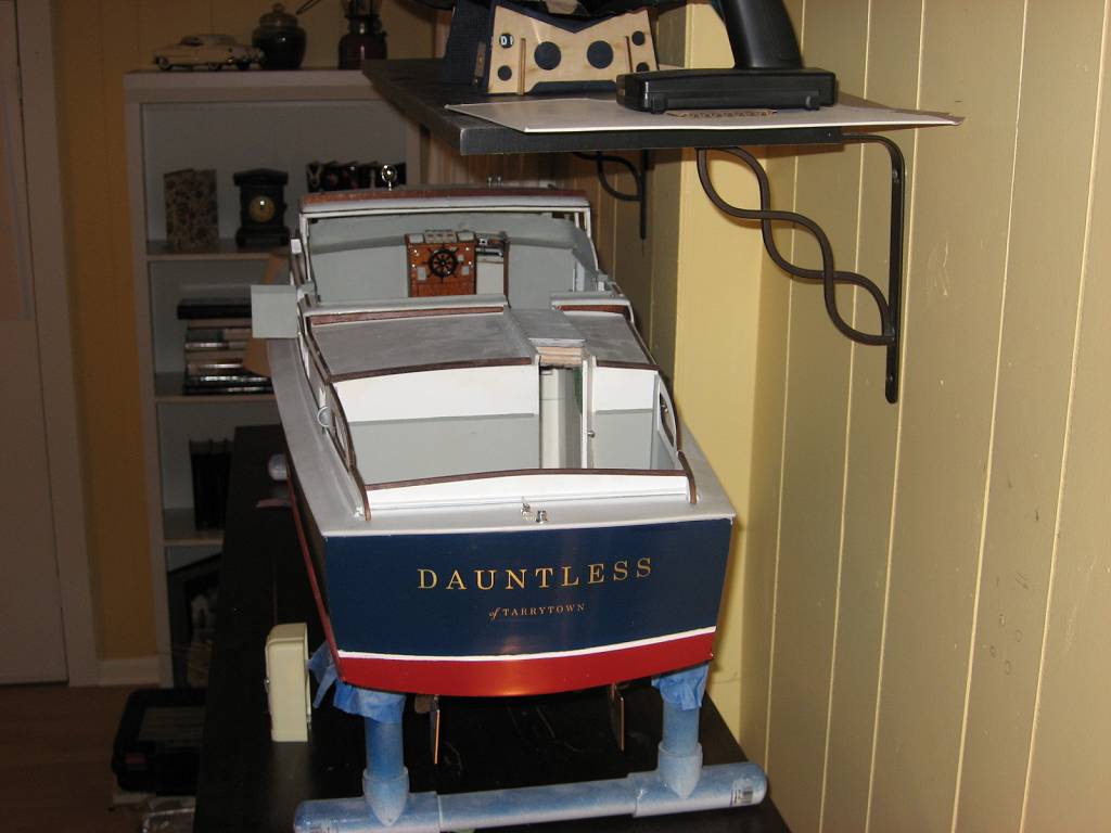

Hi Chris,
Here is another angle. This shows how the simple structure comes together. The PVC can easily be cut with any saw.
-Rich.
