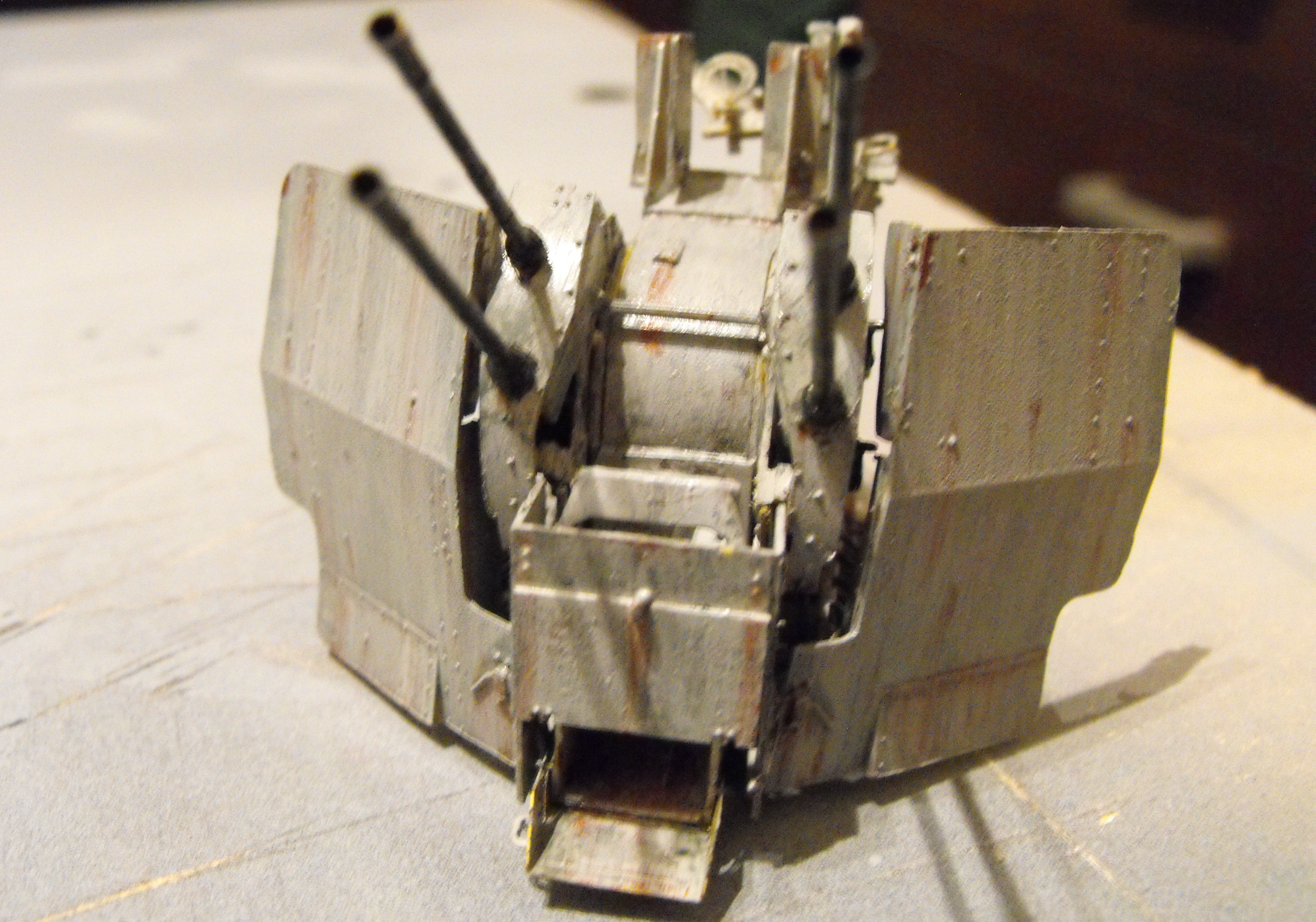

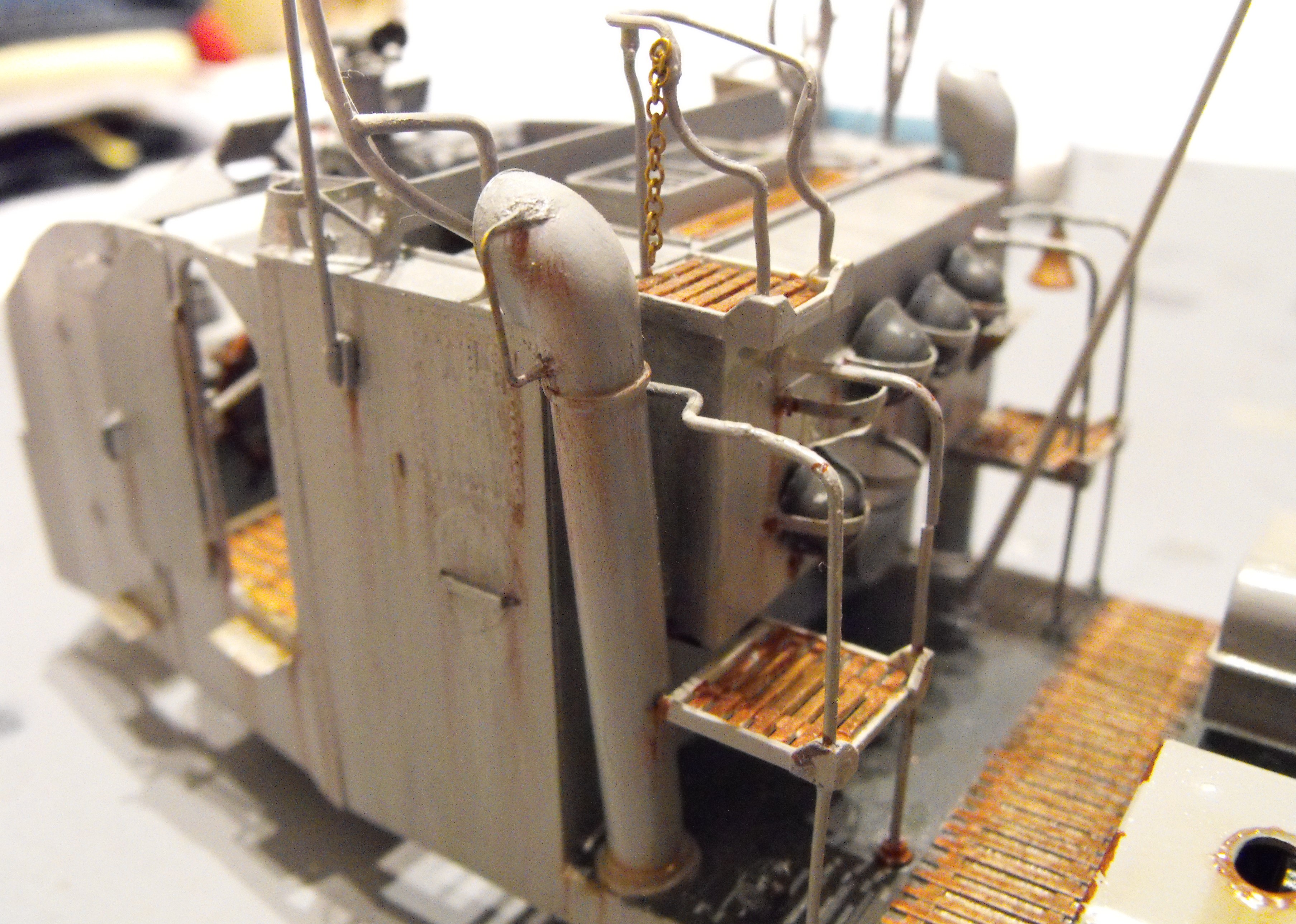

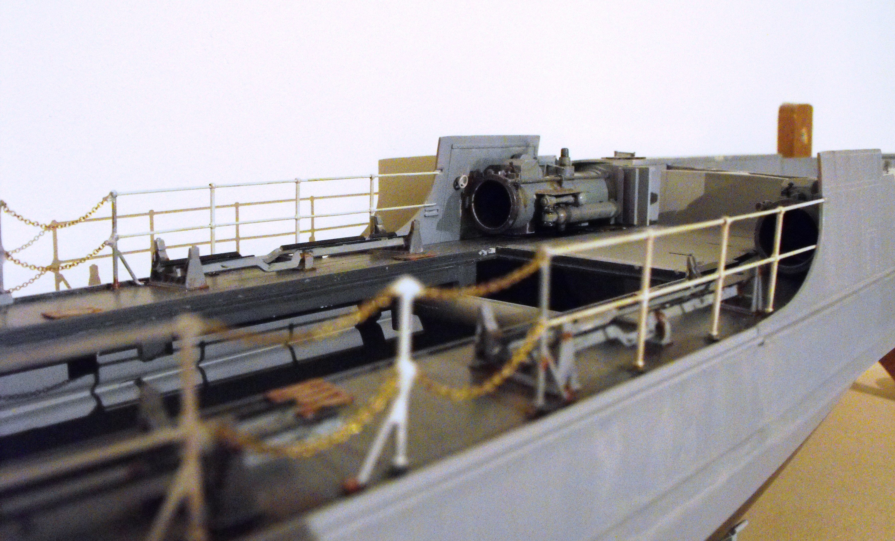

Old 09-25-2013 | 05:53 AM
  #27
Joined: Mar 2013
Posts: 65
From: Hull, UNITED KINGDOM

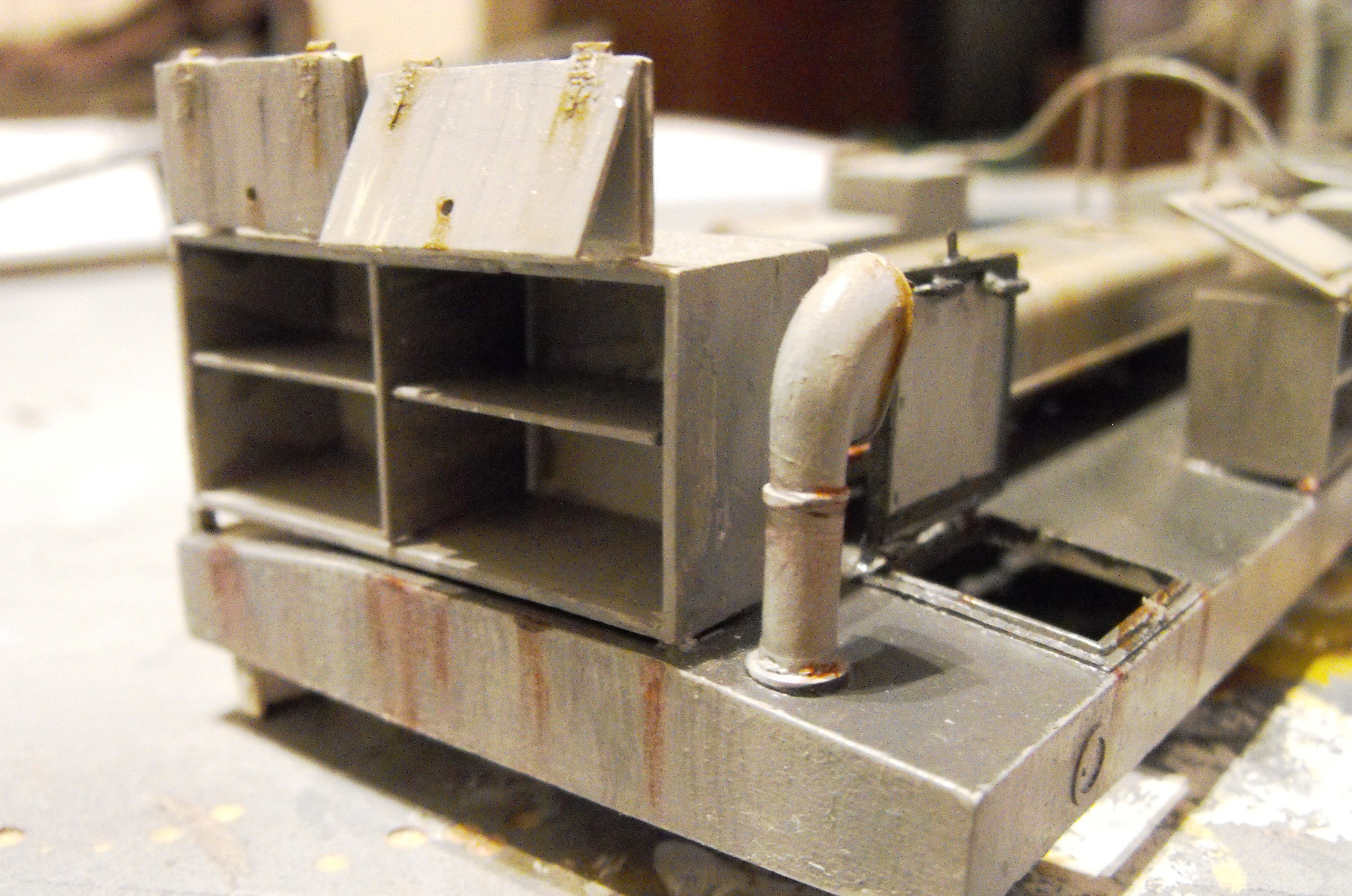

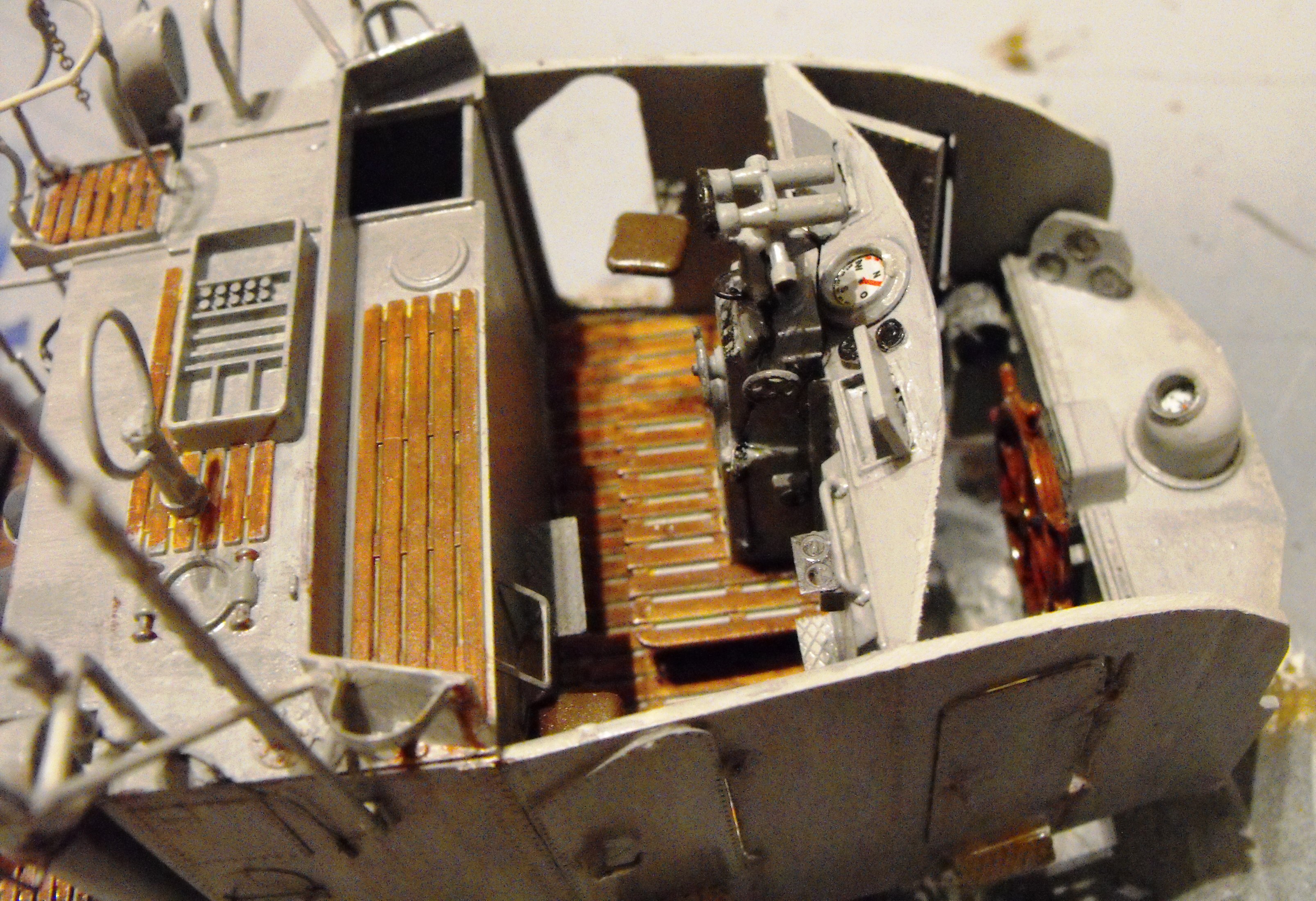

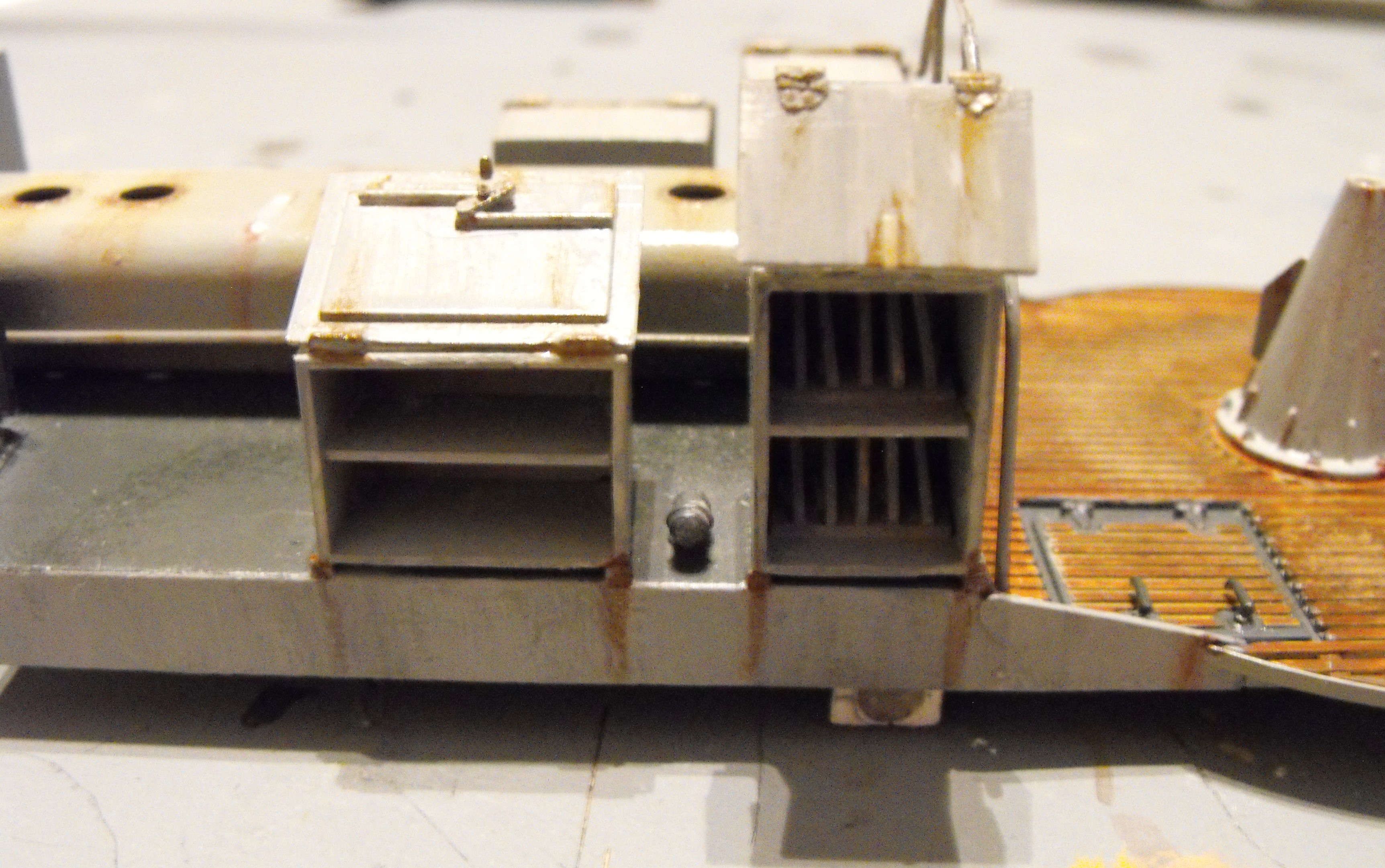

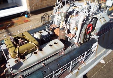

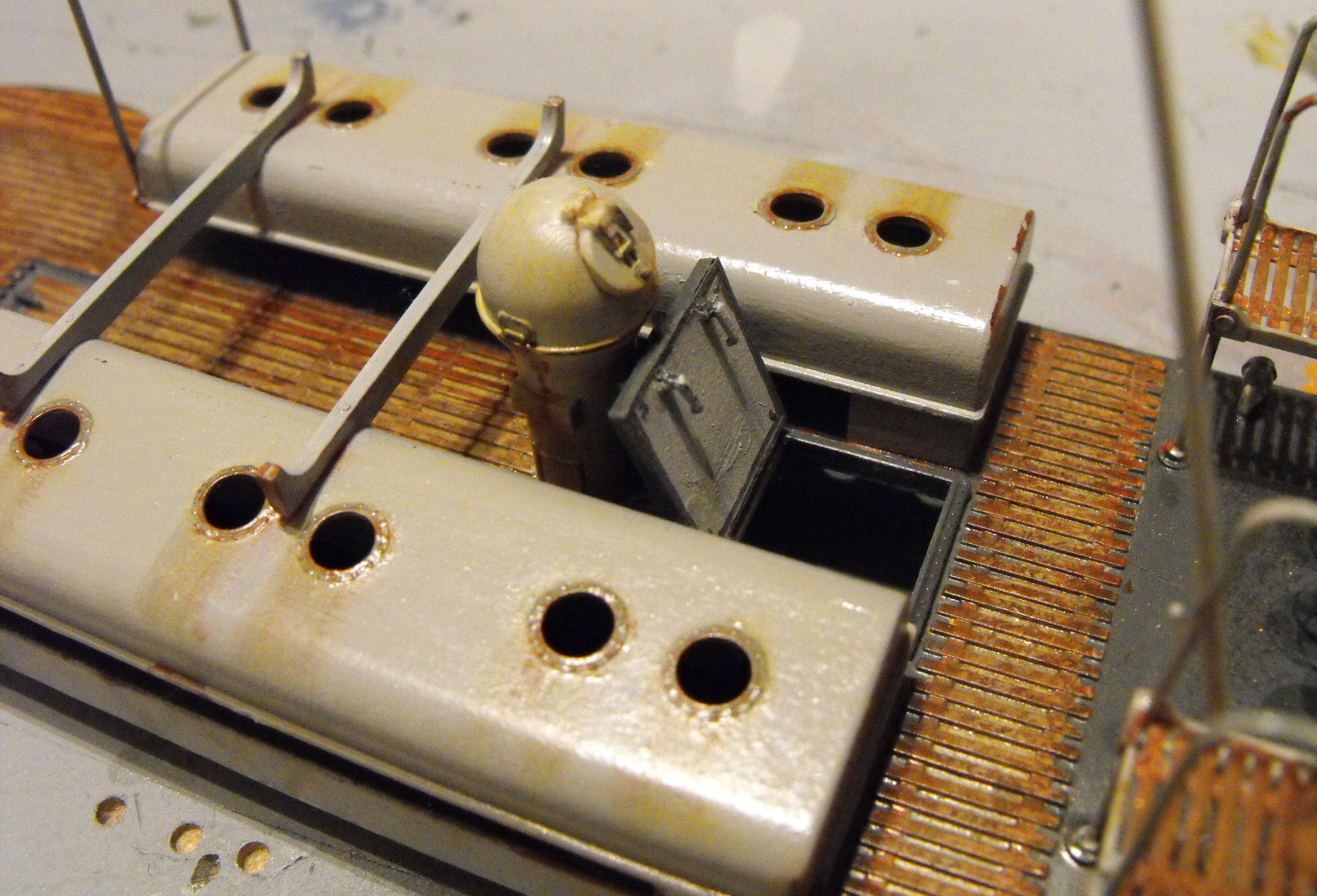

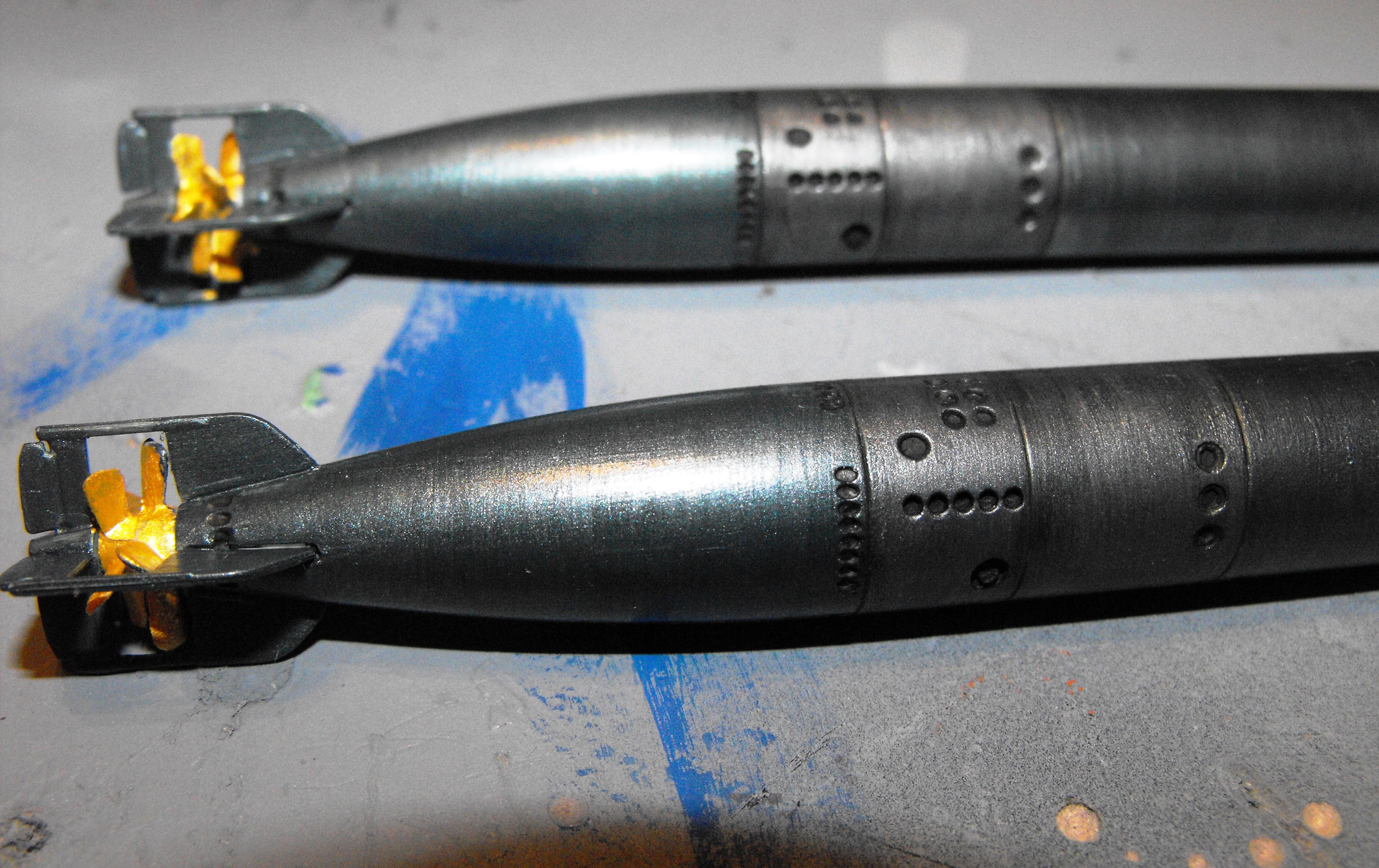

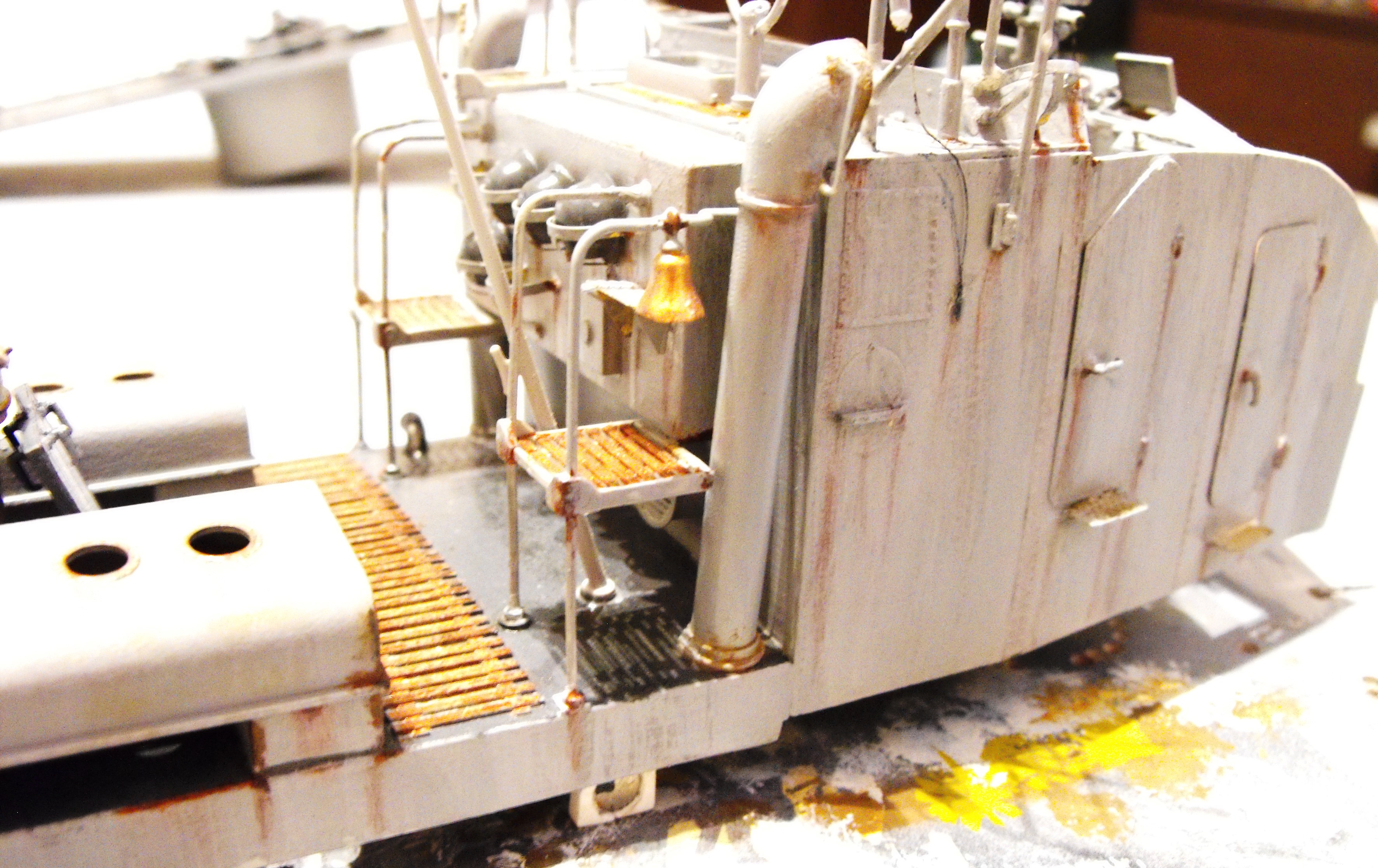

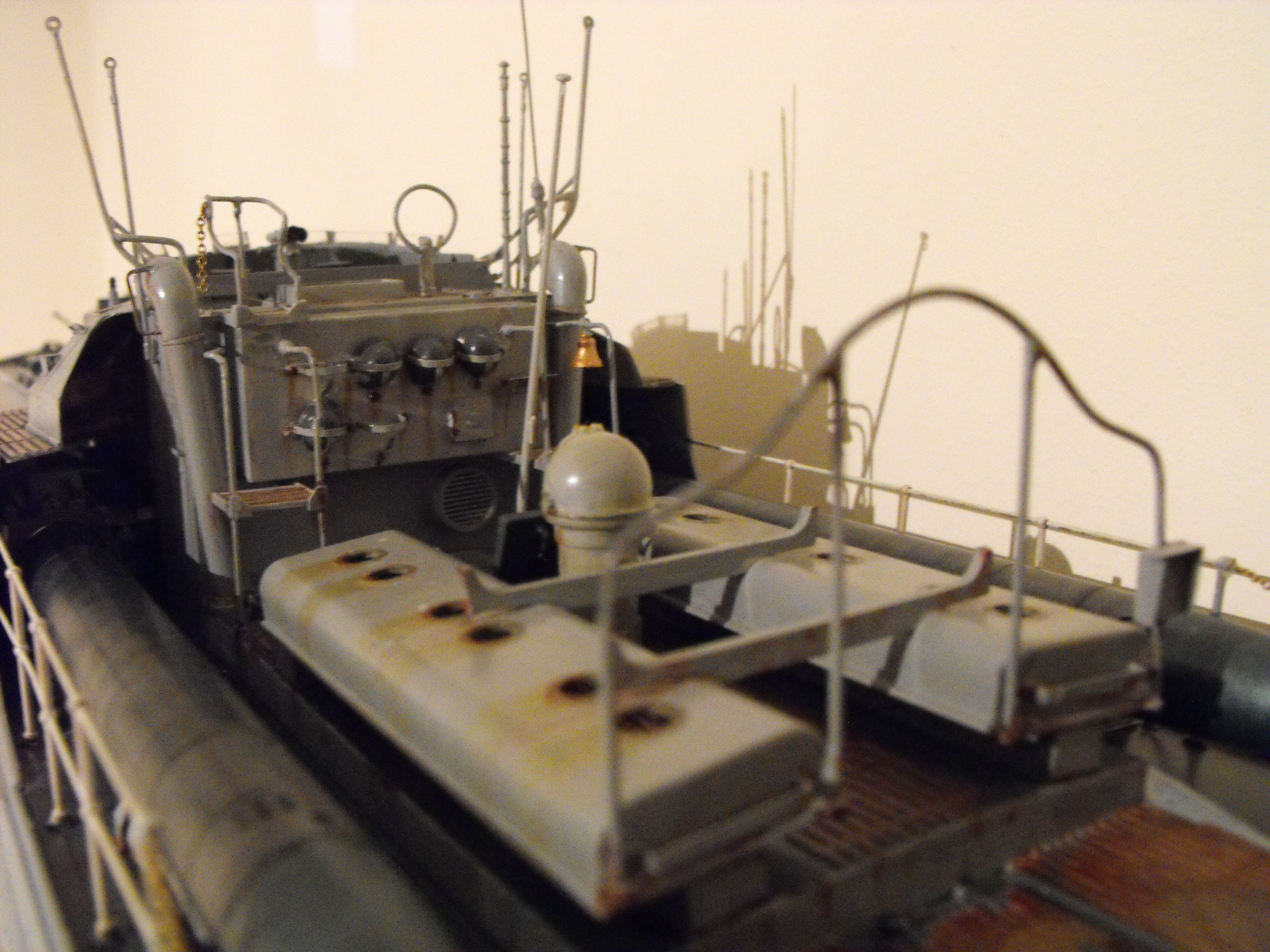

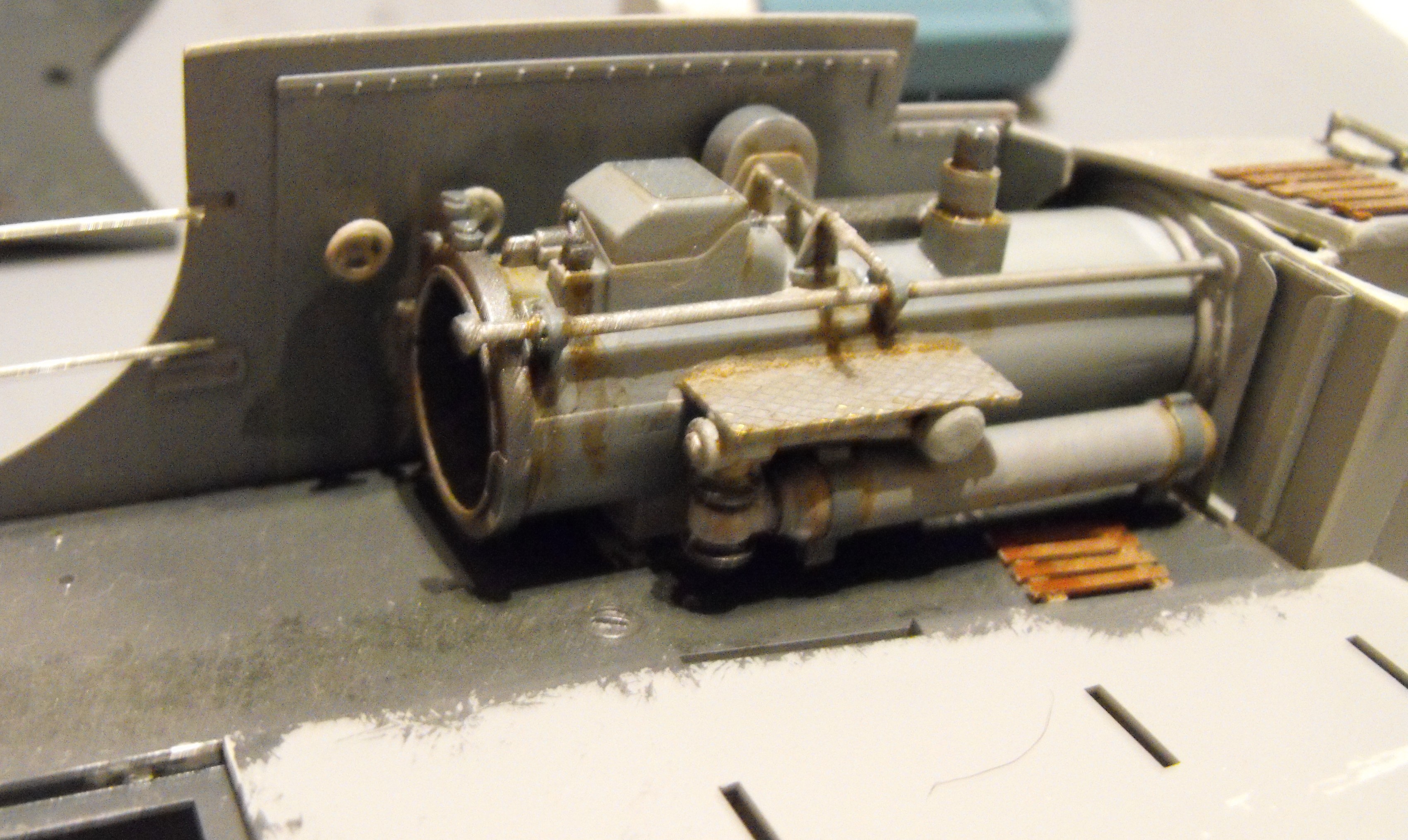

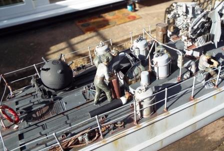

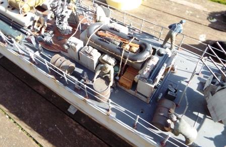

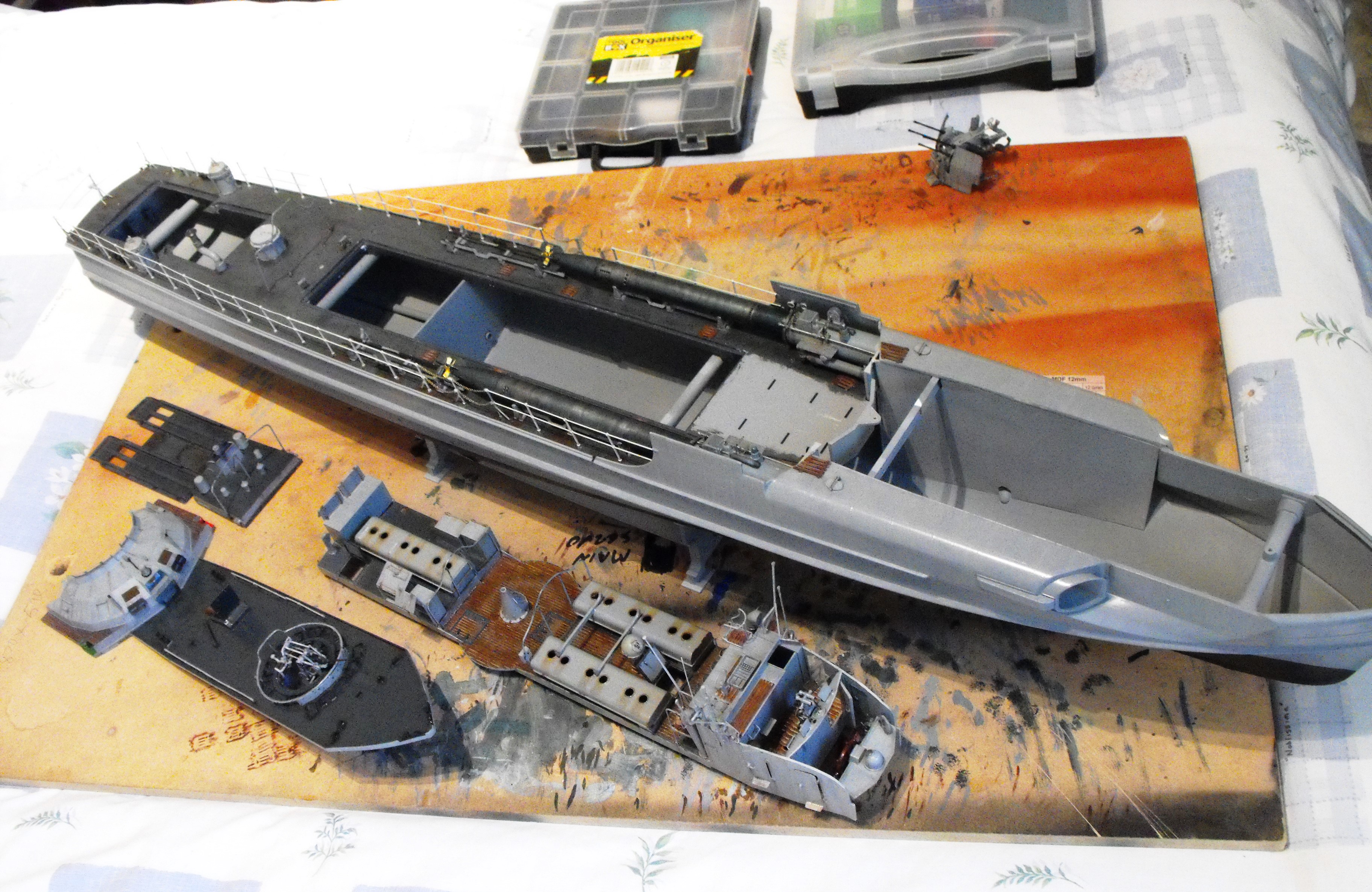

Some updates of weathering, fitting brass fittings etc!
Gregg

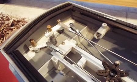

Old 10-28-2014 | 09:36 AM
  #28
Joined: Mar 2013
Posts: 65

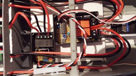

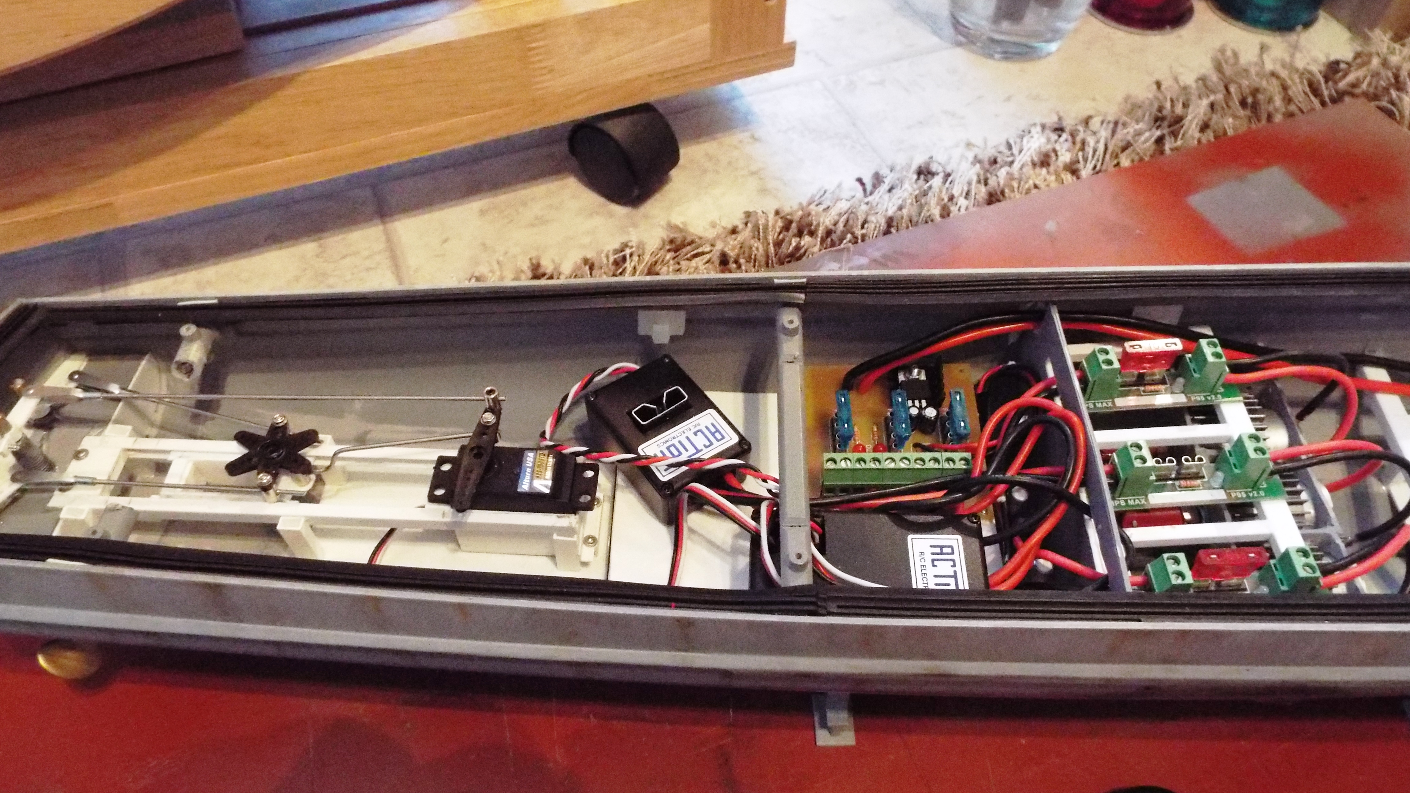

All electrics installed & working, not without a few hitches but got there in the end.
Finalised the crew positions, all waterproofing sorted.

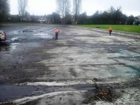

I was hoping to get it in the water this summer, unfortunately our local parks department chose this year to clean out the boating pond.
Apparently it is 25yrs since it was last emptied.
As there is no date for re-filling I am starting on a R/C build of a 1/72 Gato Class submarine.
Hopefully I will have it completed for next summer and can take them both together.
Watch this space
Gregg

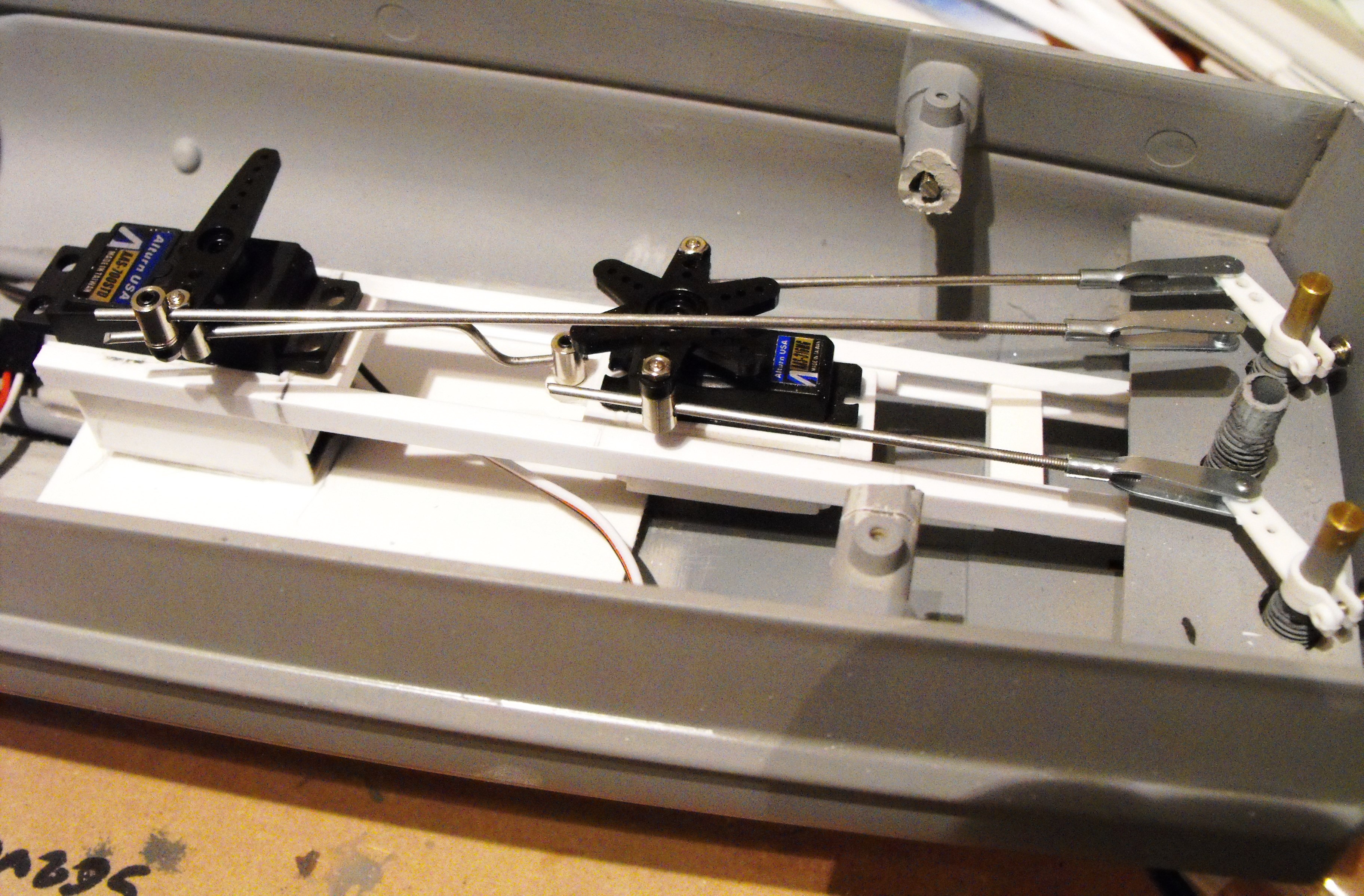

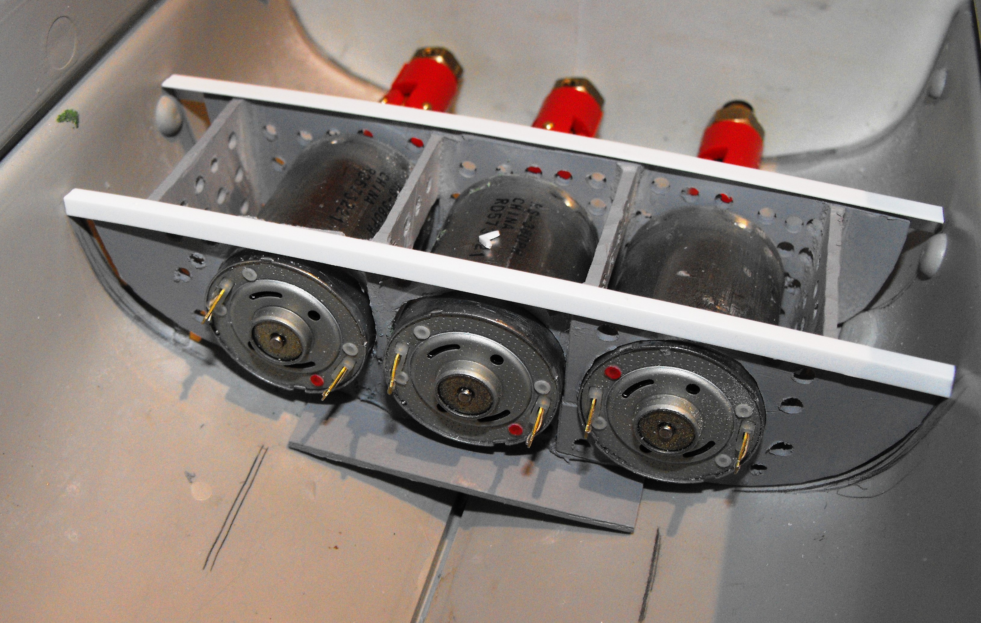

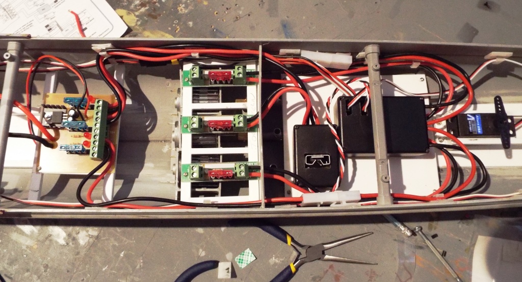

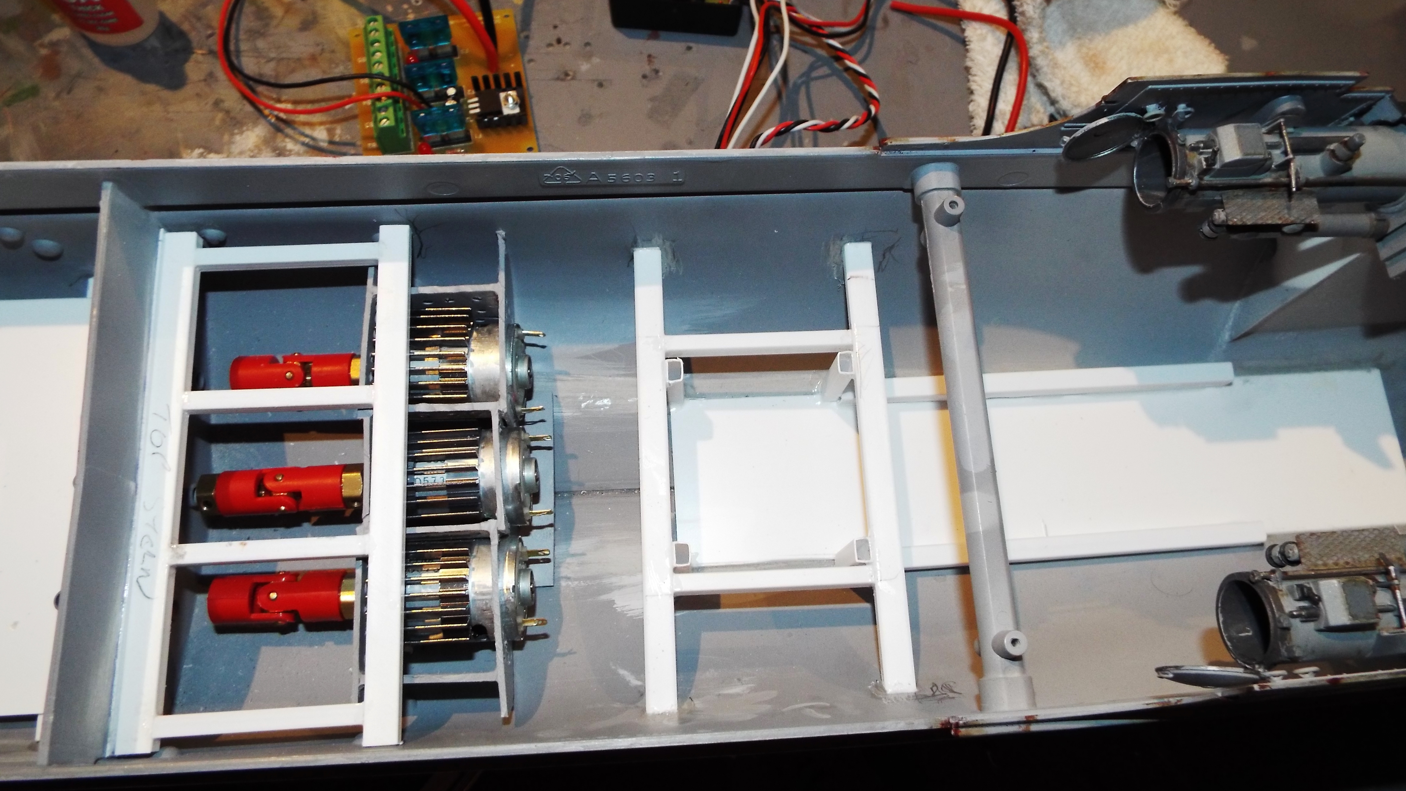

Ojay can you post what kind of electronics you have in this so others can maybe follow your example. Like battery, motor types and how many.
Old 12-08-2014 | 01:49 PM
  #31
Joined: Mar 2013
Posts: 65
Default Electronic Details.
The power is 3x380 normal brushed can motors.
ESC, Mixers & Distribution Board all supplied by 'Action Electronics' (now The Component Store) They build them to order for individual models.
If you google you can download all their diagrams for many individual model kits.
Servos are ordinary 2 x Mini Servo's
Transmitter/Receiver is Planet T5 2.4GHz
Battery is 3800mah Nihm.
Hope this is of help Deathwish.
Gregg

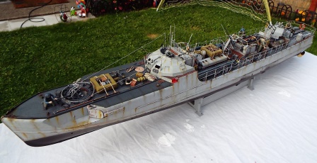

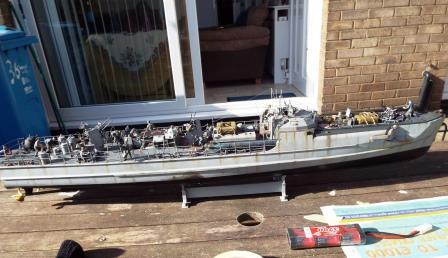

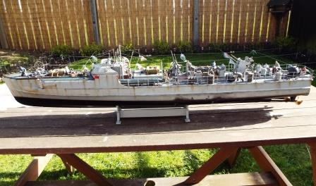

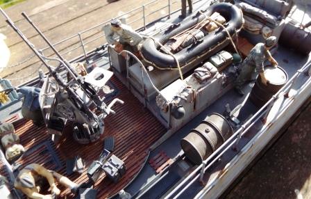

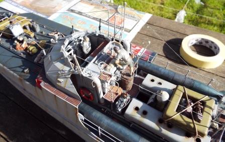

Old 05-11-2019 | 07:22 AM
  #36
Joined: Mar 2013
Posts: 65

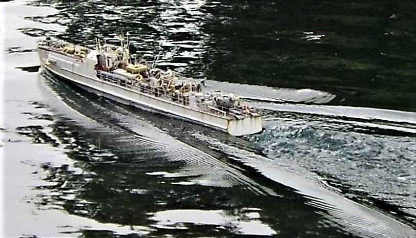

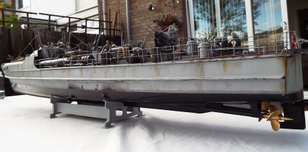

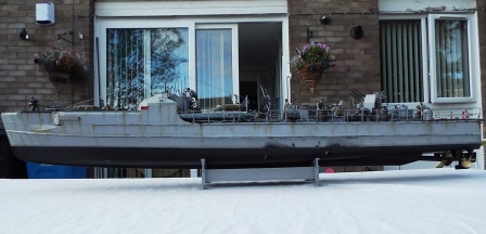

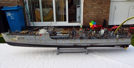

Long time in coming, but finally got her on the lake.

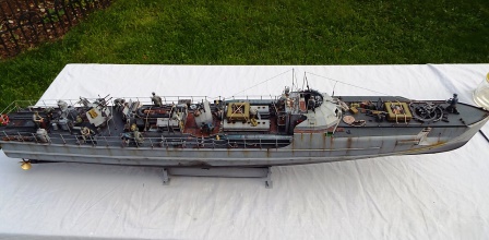

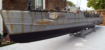

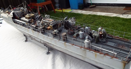

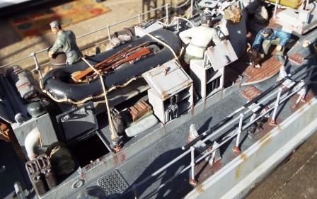

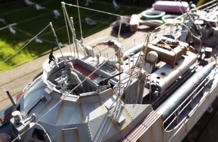

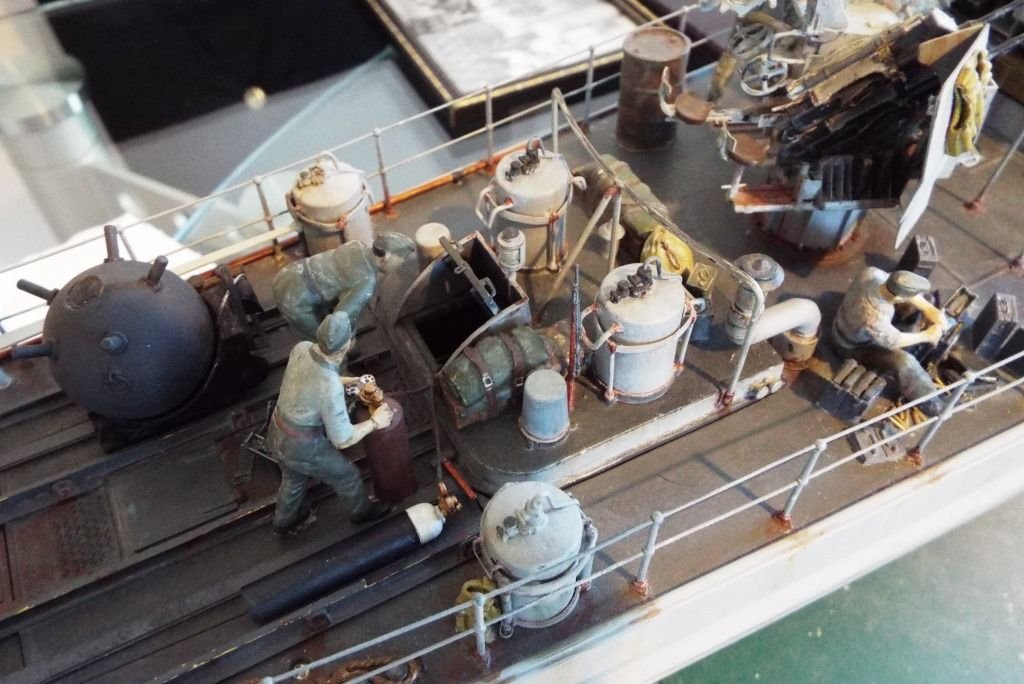

Old 08-28-2019 | 03:08 PM
  #37
Joined: Mar 2013
Posts: 65

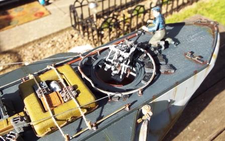

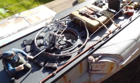

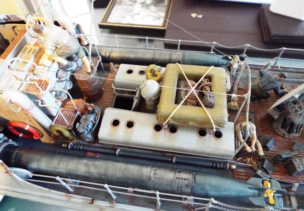

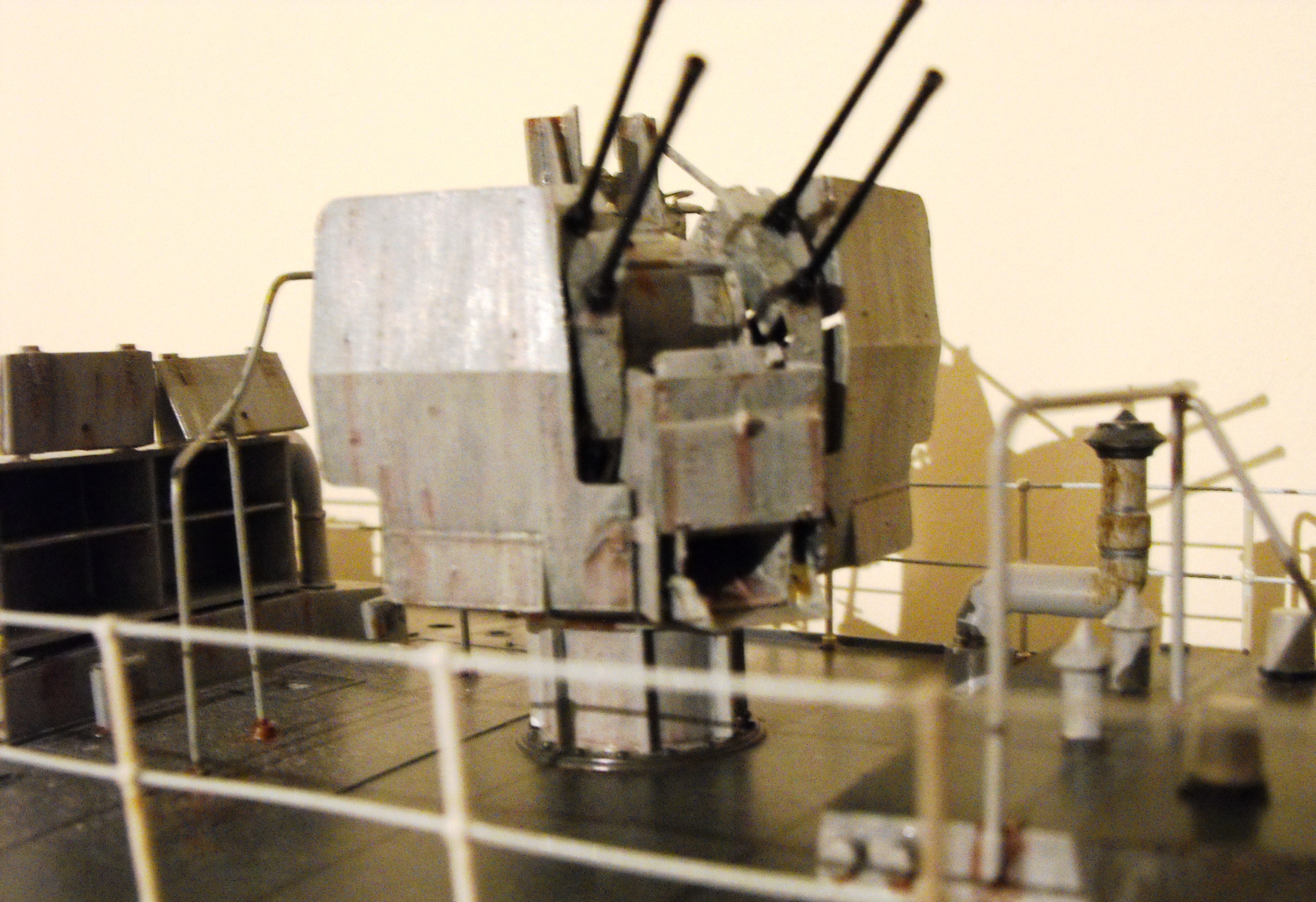

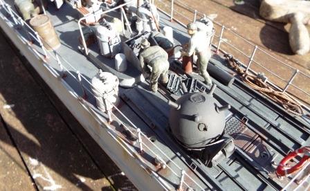

A closer view of some of the details.

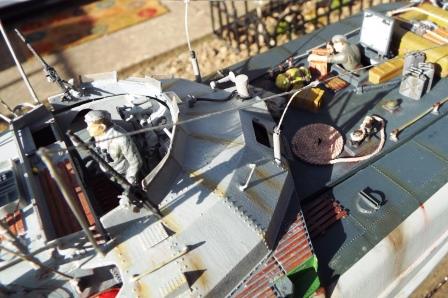

Old 08-31-2019 | 07:34 AM
  #38
Got RPM's Avatar
Joined: Nov 2006
Posts: 857
Received 11 Likes on 11 Posts
From: AZ
Cool
I love all the detail, but even more I love the weathering effects. On thing which bothers me a lot with so many scale boats is their “fresh from the builder’s yard” look with no dirt, no rust, no bumper marks, etc. And while weathering can be carried too far, your model depicts a Med E-boat the way I’d expect it to look towards the end of a deployment. Good job!
Old 09-07-2019 | 07:55 AM
  #39
Hydro Junkie's Avatar
Joined: Nov 2004
Posts: 10,629
Received 139 Likes on 132 Posts
From: Marysville, WA
My issue is you have over-detailed the boat. If it was sitting at the dock, between patrols, all would be fine. To have all of the boxes, barrels, crates, etc, on deck while underway just wouldn't happen. In a combat situation, the boat needed to be ready for action at a moment's notice with the crew able to be at action stations in seconds. With all the things on deck and the crew's attention else wear, such as petting the cat, the boat could be heavily damaged, or worse, before it could be able to return fire
Old 09-07-2019 | 12:23 PM
  #40
Joined: Mar 2013
Posts: 65
Thank you for your comment, however
The MODEL sits mainly on a SHELF in my autistic grandsons BEDROOM, therefore one could say that it is DOCKED.

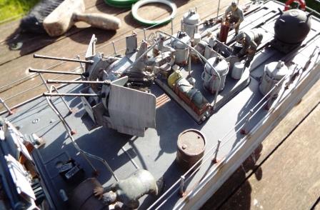

Old 10-05-2019 | 03:18 PM
  #41
Joined: Mar 2013
Posts: 65
A last play before moving on to a new owner.
I couldn't get the Lurssen Efekt using the original motors, so changed them to higher revving ones.
It worked, there is a decidedly different stance when applying the Lurssen servo at high speed.
I have accomplished what I set out to do, and I need the space and funds for my next project.
