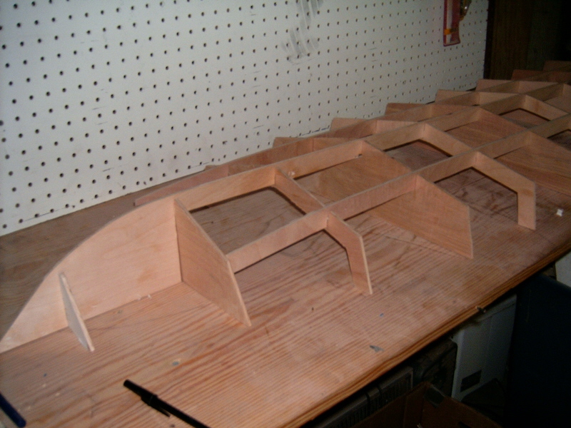

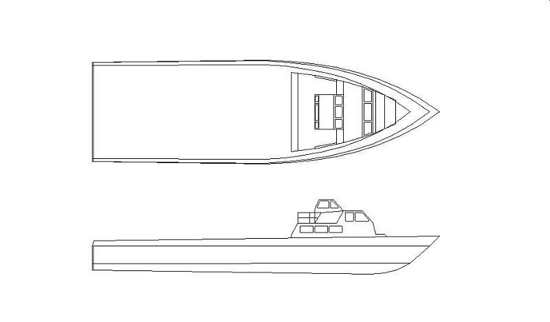

I'm in the process of building a 1/24 scale crew boat, that I will power it with 2 electric motors. I have built several nitro and gas boats, but never an electric powered. I'm thinking maybe a pair of Dumas 12v. Any input on this type of setup would be helpful.

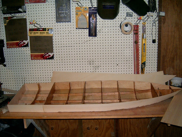

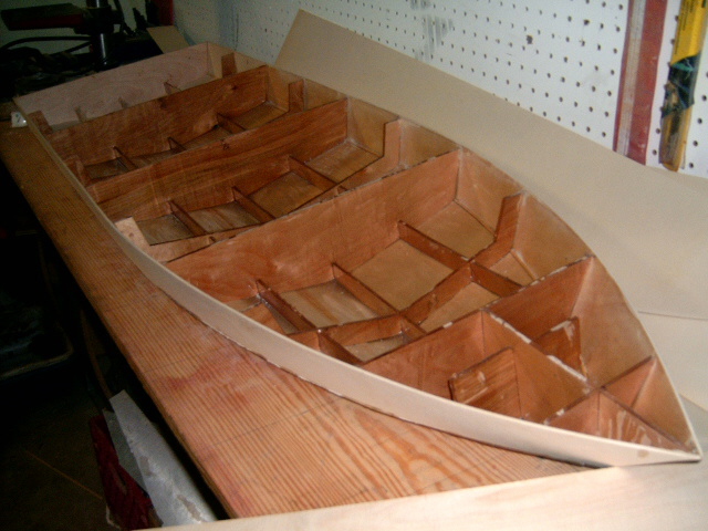

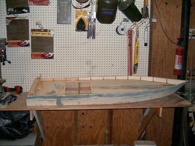

Today I got the frame work and the bottom and sides in place. Glassed the inside.

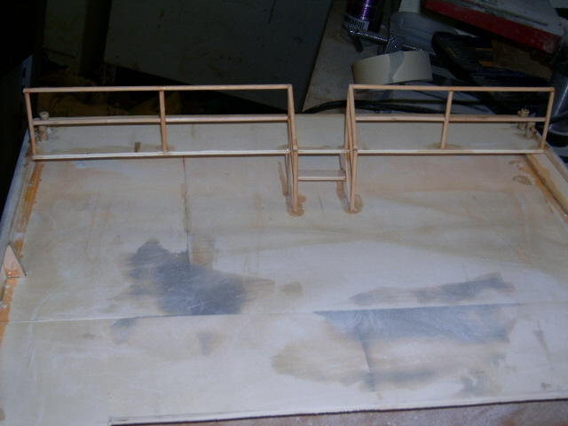

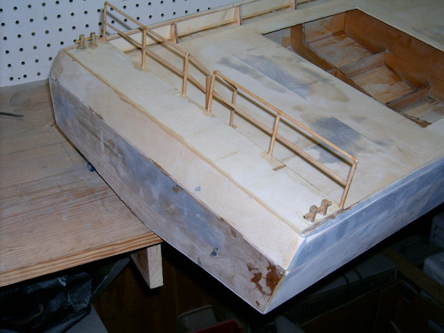

Installed the deck, bull works, gunnell, aft deck, aft handrails and bits. Glassed in the seams and wood defects. Now I'm waiting on more wood to arrive.
I did not cut the hatch for the laserette, before I installed the aft deck, now its going to be a fight to cut it out and install the rudder system.

That's some nice progress on that hull. It's looking really good. Next time I bet you get everthing done in the hull before you install the decks. I'm dealing with that right now on my destroyer and refusing to install the mid and aft decks until I've had it in the water and tested. It's so much easier to work on with no deck installed. I don't want to run into something that has to be done and now I have a deck in the way. I look forward to seeing your boat done. Keep up the thread and posting pics, it's fun to see what others are doing.

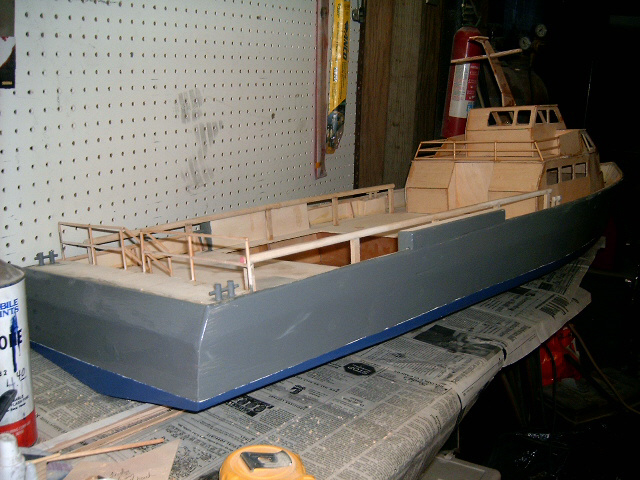

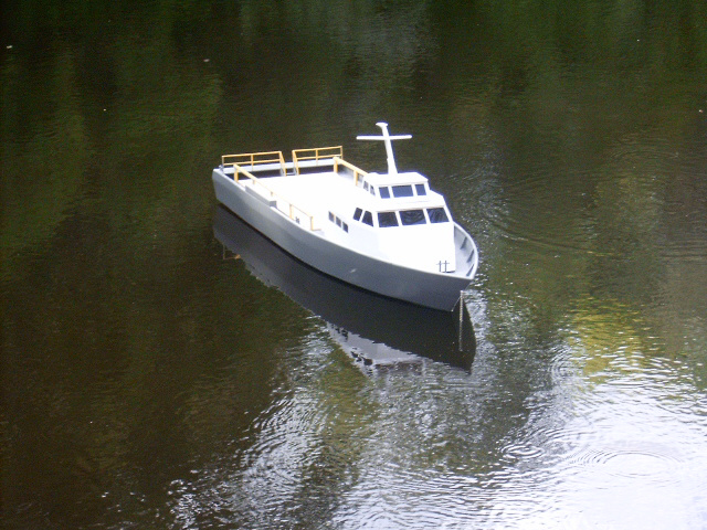

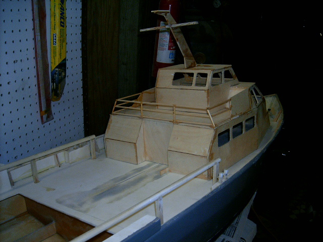

Waiting on UPS for more wood. This morning I was able to install the cowling for the engine room. The mid bits and the bow bit. My step son (10 years old) made the anchor for it, and did a fine job on it. I'll post pics latter today.
Back to the advice thing. I was once told, A dumb man; one that thinks he knows, that will not listen to anything new or different. A smart man; one that knows he will never know what he needs, and will hear out any one with a new or different idea.
And this is why I hear myself telling know it alls,"Don't tell me how long you've been doing this, show me what you know".
Back to the boat,

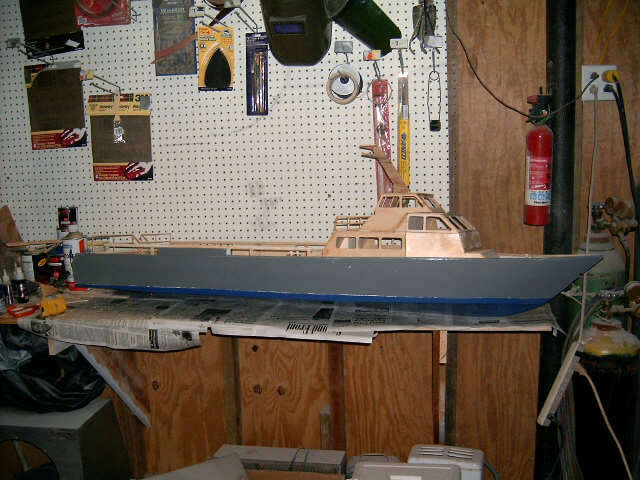

While waiting on the wood to arrive, I painted the hull. Wood arrive, back to work. Built the cabin, pilet house, the mask and installed the handrails. Cutting out the windows is a pain in the ass, seamed like they would never stop coming. Will not be able to work on it for a few days, the job is calling me.
Here are a few pics

WOW, your really moving along on your project. I've never built something as fast as your going. I'm impressed. Looks really good too. I still haven't gotten any work done on my destroyer this week. To much going on to get to it. Maybe I can get a building session in tomorrow, we'll just have to see. I'm still waiting for the props so I can test run and then install the deck. I've been waiting for about 5 weeks now. They must be coming from europe or something, their back ordered.
Once again, nice job there.

I'm gonna have to slow down before long. LOL the wife told me I must sell on of my toys to get the money to buy my motors and hardware. 5 weeks on waiting on a part, man that would kill me. Could you use a prop from a diffrent company?
This afternoon I removed all of the paint(scraping and sanding) I was not happy with the results. Got most all of it repainted, just have the handrails on the aft deck and the cargo rails to repaint.

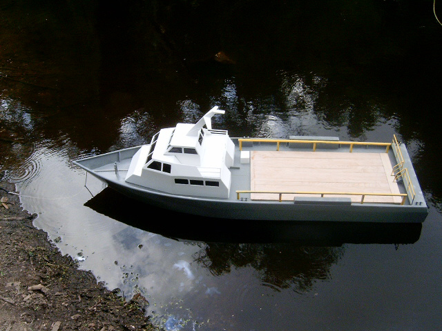

Installed the doors on the cabin, the handles and knobs was a pain. The windows I used plexy-glass and painted the back side wide a gloss black to give it a tinted window look. The next crew boat I build, thinking about going with clear glass and putting detail inside of the cabin. I got the wild idea of building the life rafts from wood, cutting and sanding to shape them, this is taking some work. Also thinking about cutting the wheels from wood(I must have lost my mind, LOL).
Made all of the deck boards for the cargo deck, this really help a lot on the looks of it being a crew boat.
Thanks Tim, all of my hulls come together fast, then I get to the finish work, then it slows way down. This hull I have a little over 60 hours into it, counting designing and making the layouts. AutoCad really helps out a lot on the time it takes off of building. It takes out about 95% of useing a tape meassure and pencil. I just print it out 1 to 1, spray some glue on the back of the print, stick it to the wood and cut it out. Takes the worry out of having the lines drawn wrong, and the parts come together exactly right. Some parts I don't try to lay out, but I scribe them as needed(bottom and sides)
Again thanks, this is some of my better work, I'm proud to say I'm building it.

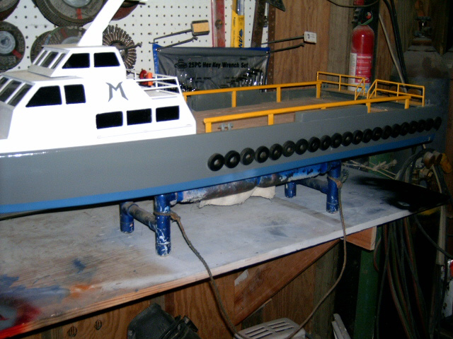

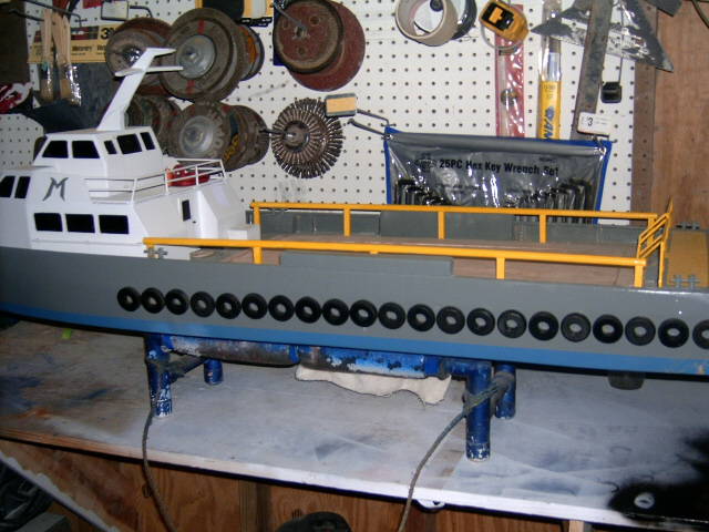

I made up my mind on what I'm useing for the tires. Just spent the last 2 days cutting out tires. Useing 2 1/4" sheets of ply, cut the outter edge with a hole-saw, then used a belt sander to shap, then drilled the inner hole, then used a rasp to shap inside the tires, dressed, then painted. So much for one side, now the other side and transome. This is hard on the old back.

Wow, that's a lot of work making tires but they look to have come out pretty good. Nice work there, I would have not thought to make them out of plywood.
