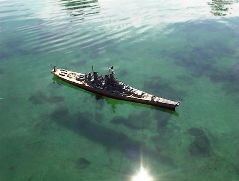

I want to add a few more to that list
Revell of Germany also has the USS NewJersay and USS Missouri which are excellant ships at 1/350 scale.
Linburge has the HMS HOOD, which does make a easy built ship 1/400
HELLER makes a KMS Scharnhorst 1/400
Nimacho? makes a 1/250 scale of the Musashi 42 inches

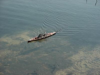

Acadamy? make s the Tirpitz and Bismarck in 1/350 scale..which I built over 12 years ago and still take out to this day!
depends how well you want to complete a project on a idea!

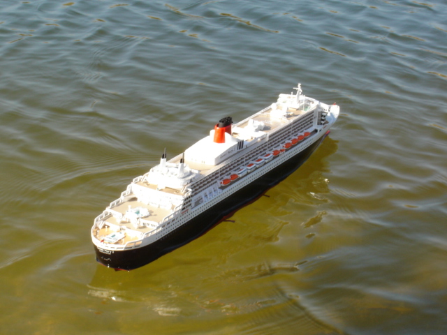

Hi
I did this with the Revell 1/400 Queen Mary 2 kit.
I just used a 2 ch radio, one for steering and on for an esc
She works a treat
She works a treat

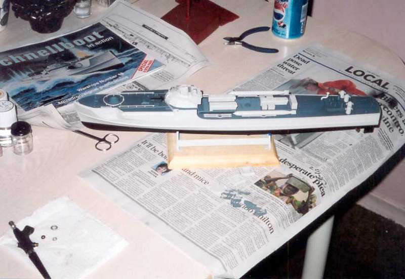

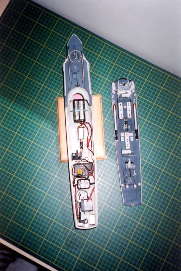

Hi
I looked all over for the pictures I have of my Schnellboot running and can't find them
Wednesday is my club's run night so I'll take some then,if you don't mind waiting until
the end of the week?
The cat recently knocked the deck of the table so I had to buy another kit to get some spare part's so there might still be some stuff missing.
I'm posting a couple of shot's taken when I was building the kit,one of the basic paint scheme
and the other of when iI was checking the water line with the radio gear in it, the motor in the picture is not what I finally used and the fishing weight's are to take the place of the speed controller which I didn't have yet.
Bob

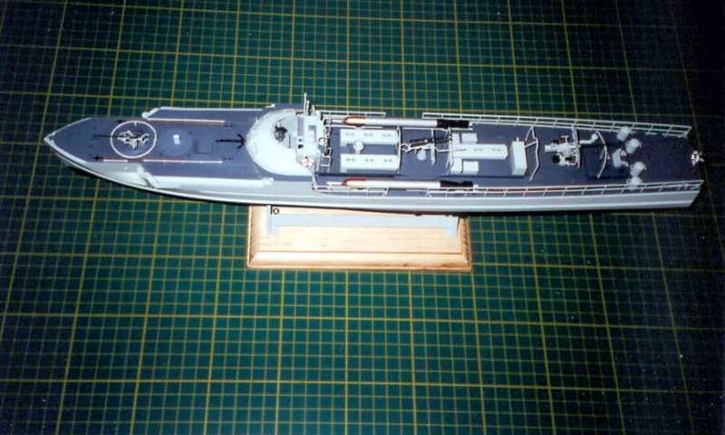

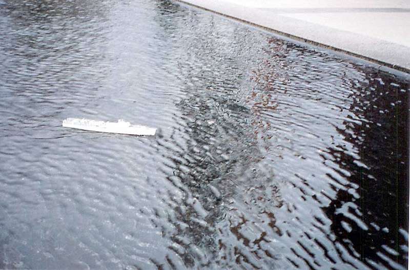

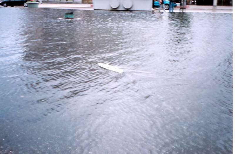

Hi Mark
Yes I still have the cat,I once told my wife and daughter it was that stupid cat or me,they
wanted to know where to forward my mail to!
Anyway I got some pictures of my boat running did'nt come out that good and conditions were
terrible really windy and thunder and lightning so I had to make it quick
Here's what I used for radio eqipement and running gear
Mini servo for the steering mounted on it's side
Speed control is a Mini-con 4 from Hunter Systems in England, Proportional forward and reverse
The receiver is a standard Futaba 2 channel
I don't know what the motor is or where it came from It was given to me
I'm using 4 AA NiNH 2100 mah batteries
The U-joint is from Graupner and I had to sleeve that with brass tube to get it to work
The stuffing tube and prop shaft are home made as is the rudder
The Prop is a 20 mm Graupner
In the Photo's the boat is running about half speed,on smooth water at full speed the bow
wave comes up to just below the torpedo tube ramps in front of the door's.
