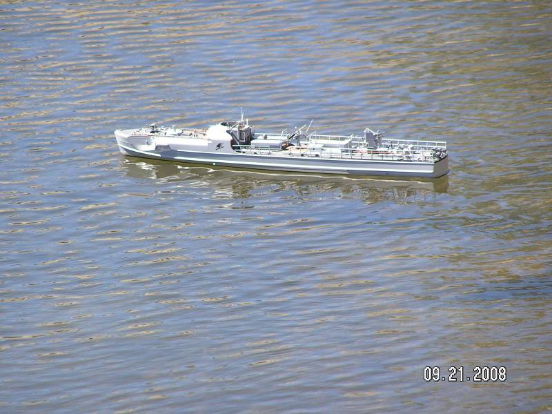

Well I finally got the S-100 finished and out on the water. Thanks to Bobslr and his pics I just had to build one. Took it out on the local ( 25 miles away) lake this last weekend. Water was a little choppy so I didn't get chance to run it up to speed.

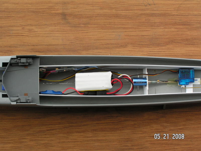

I used an losi motor ( same one they use for their 1/35 cars) and ESC, the little blue packet is the voltage reg for the Lipo battery. Around the inside of the hull is a bulkhead about 1/2" from the hull, that I filled with that spray insulation foam in a can to help stop any possibility of sinking.
