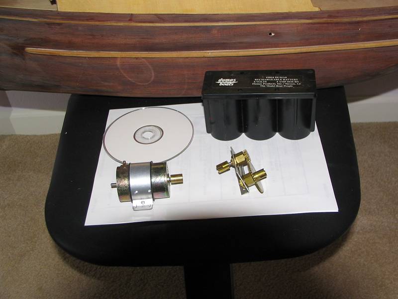

Dumas recomended that I use their 6 volt motor and gear box. I did buy their speed control, but it seems really old tech, and wonder if there is a better "Boat" speed control I can use.
I will be using gel cell lead acid batteries...any comments on this? I'm using these batteries because I will need weight in the boat to get it down to the water line.

As for a water proof servo, I don't know if anybody makes one. If you have built the boat correctly you shouldn't need one. I have one boat that has a 1/2" of freeboard to the main deck. All of the electroncs and hardware are below the waterline. I have yet to see a drop of water insde the hull.
I have become a fan of the Proboat speed controls since High Tech stopped selling their 610 model. You can't beat the price of $40 for a waterproof electronic speed control with reverse. If you want to go high tech, I like Vantec, they are pricey though. I would stay away from the old Dumas mechanical speed control, they can generate a fair amount of heat when used for a long time and are prone to failing.
Gel cells are a great way to go, last a long time and make great ballast weight. You can't be in a hurry to charge them up though, overnight is the way to do it. The 6 volt 5 amp ones are a perfect size and can be found at Home Depot or Lowes with the emergency exit lights. I will admit this though, due to the amount of batteries/boats that I have, buying that many chargers would have been expensive. When buisnesses remodel, they throw away the old emergency exit signs. I get a hold of them and remove the charger circuit boards. I have built a charger box where I can charge up to 12 batteries at once.

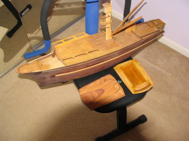

Thank you for the information and I will take a few pictures of the hull and deck. I had some pictures of the build, and I tore my attic up looking for them ( I just put a pine floor in my attic and placed all my pictures and stuff up there...now I can't find a darn thing any where).

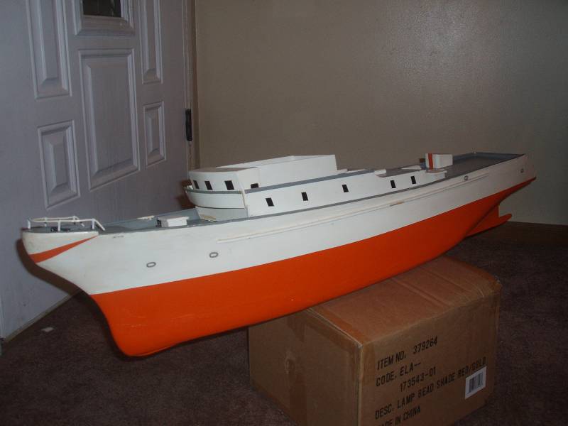

I think that I have one of the Dumas tuna boats hiding in the basement somewhere. I got it at a yard sale years ago. It is missing some parts and the cabin roof, there is no motor or electronics either. Out of the box she is kind of bland, Dumas didn't do much in the way of detailing to make her look appealing. Since I live in an area that doesn't have any fishing vessels, it is hard to find any kind of real life reference to go by. All I have is pictures on the net to go by and sometimes that is like trying to find a needle in a haystack. Now if I could find some pictures of one in real life to go by, I might be tempted to pull her out of mothballs and finish her like she should be.

Thank god your home safe and out of that sand box. Sorry to hear about your boat though. It seems that we put so much time and effort into our boats that they become an extension of ourselves or almost one of the family. Can't forget the amount of money that goes into one of these boats either. It is heart breaking to leave one behind Sorry that had to happen but sometimes flesh is worth more that wood and glue. We still will try to grab for the falling X-acto knife with a new blade in it to save what was just glued down regardless of the consequences.

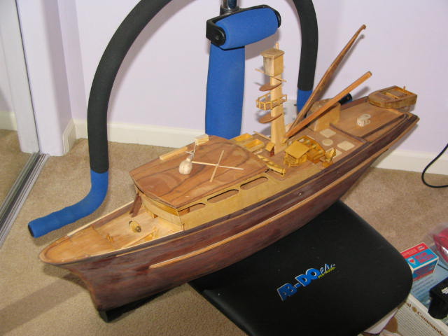

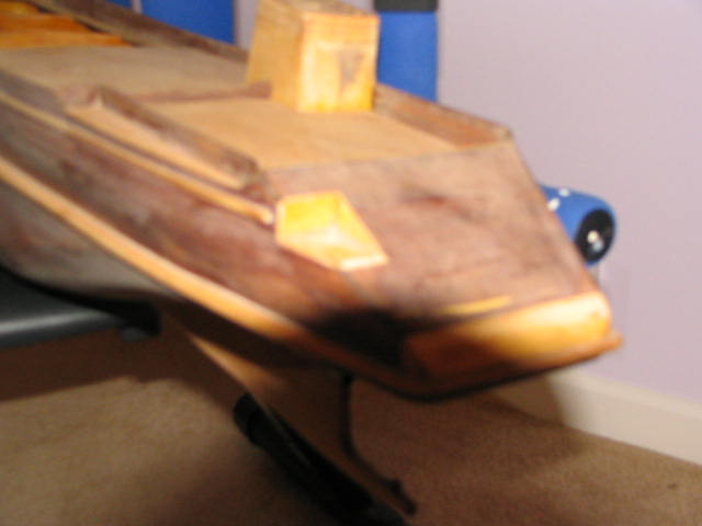

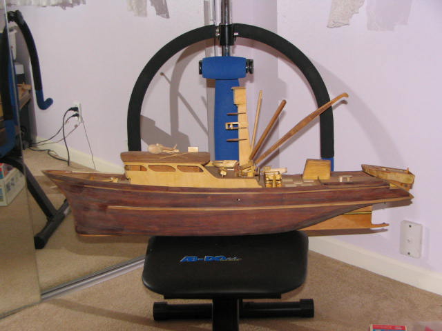

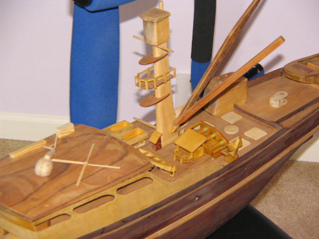

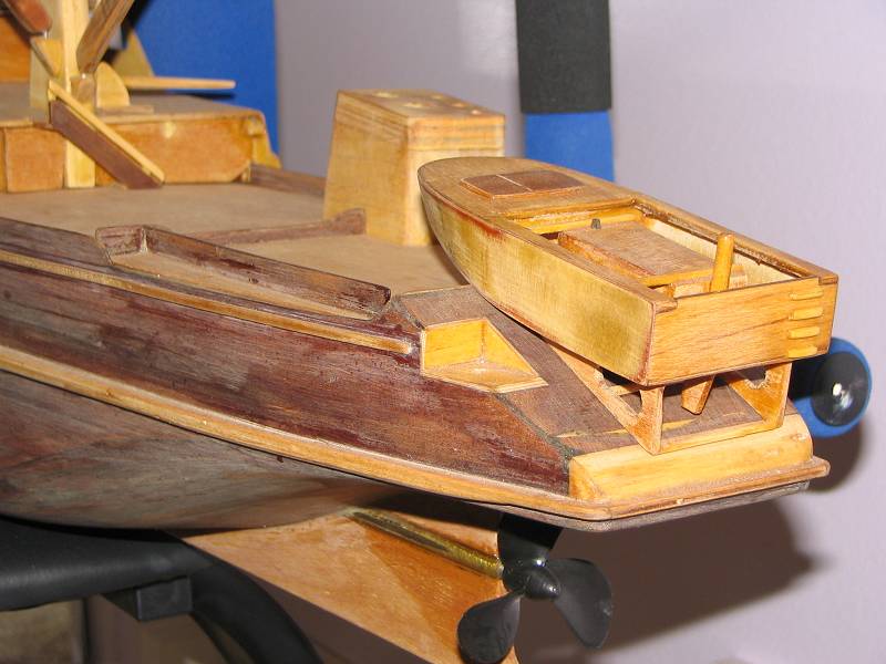

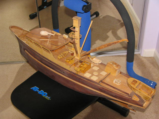

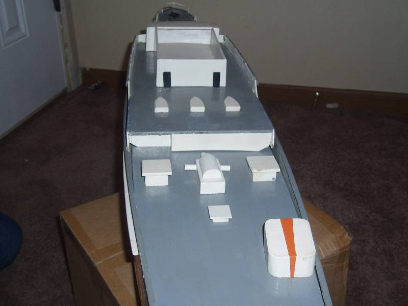

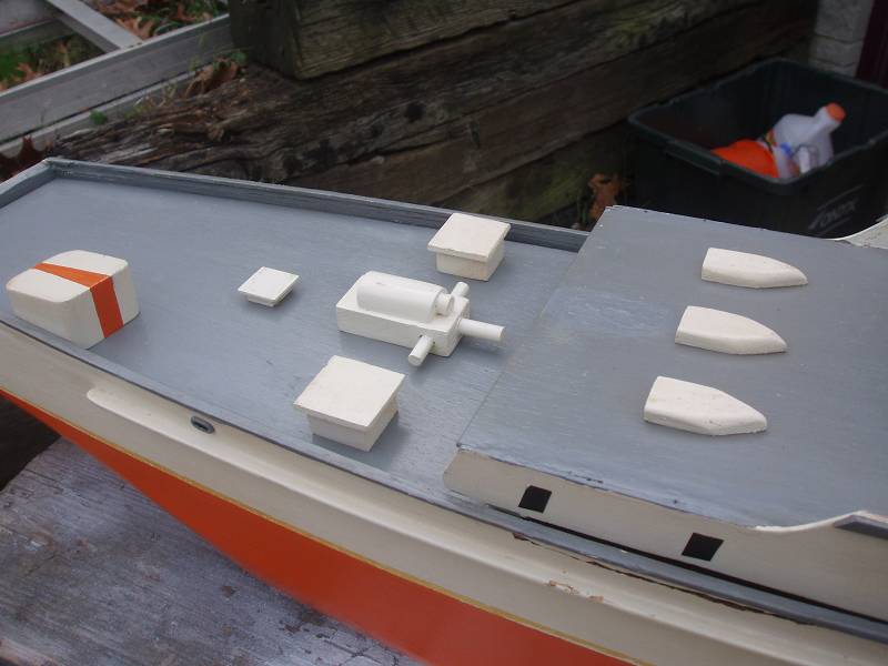

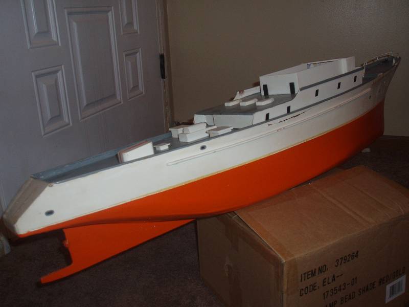

I managed to pull my tuna boat out and dust it off. I then managed to pull all the other stuff I have for it to. I took some pictures of the hull and just set a few deck details on the decks... I need to finish some upper deck details and install the bow thruster. I need to final the batteries...and maybe buy three more...I'm going to have to figure out where to place them too, and keep balace. I am going to need a good speed control, and I've not decided on the one I'll use yet. Dumas sold me an electric motor #2004 6v. unit. and a gear box for the electic motor. I've hooked up all the drive train, and it works nice. The bilge pump is set up, but I may need to move it to place the batteries.
I've yet to make up the net pile...and will need to fabricate my chains, net and floats for the boat.
Then paint...
I've some pictures for you now, and I will dissemble the hull and show you the inner hull in a day or so.

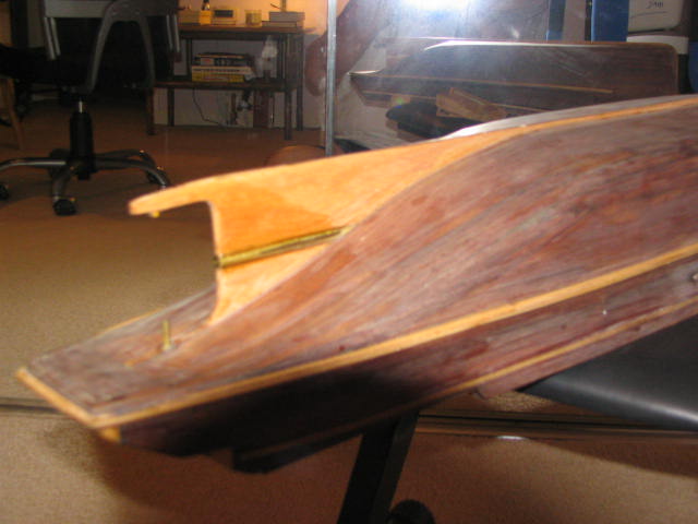

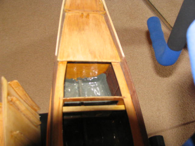

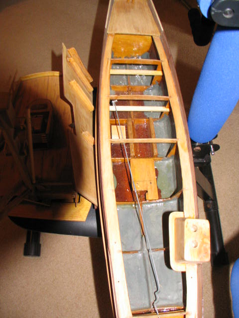

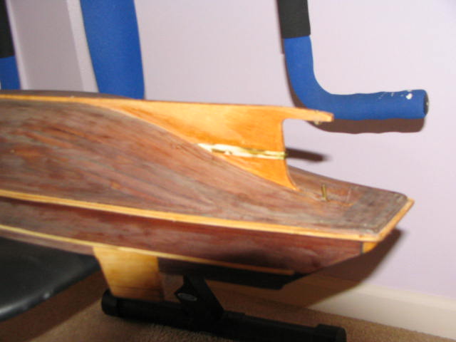

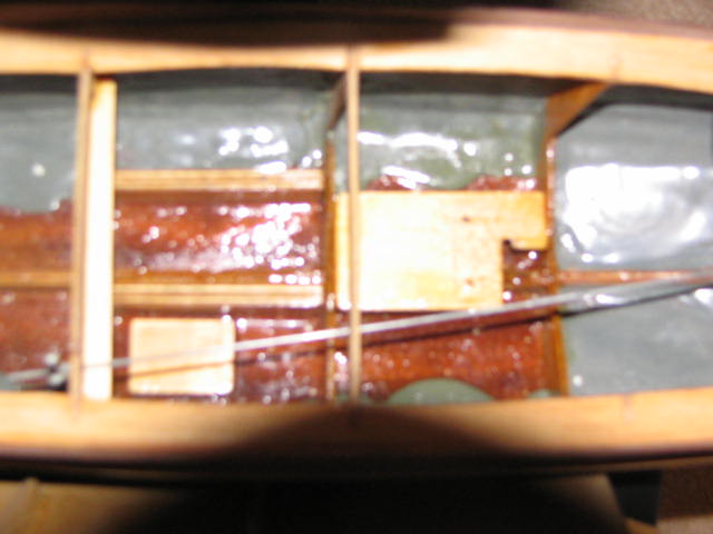

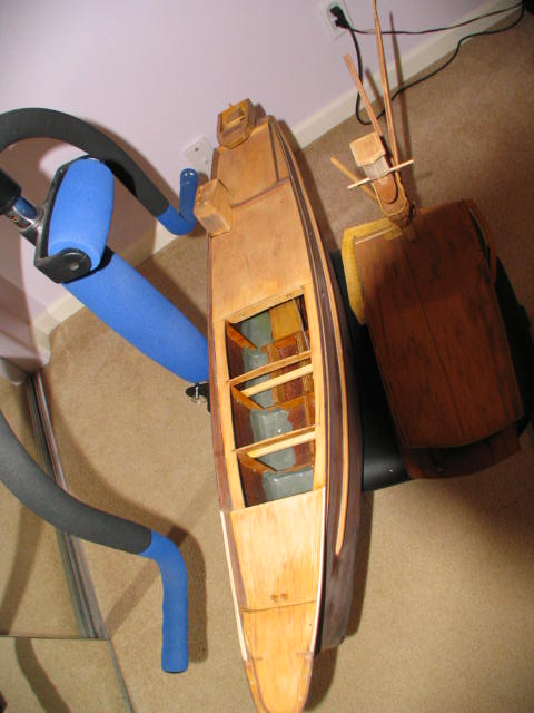

I'm enclosing the photo's of the inner hull for you. It was a trip building the hull, and it was my first planking experience too. Dumas... was almost close, in cutting the wood for the kit, and there was just not enough planking material to do the job. Since we made port in General Santos City to off load our catch, I was able to run down the wood needed. I ran out of 1/64 th. ply, and where do you find this in Papua New Guinea. It was a trip and no pun intended, but I made many port calls over the years. From Christas Island, to Thailand. With the Salomon Islands the best port of call.
You will notice some grey stuff on the inner hull, and this is aircraft structural epoxy. My sanding kind of wore out the wood and felt I needed to make this area rock hard and strong. Having a full shop of aircraft grade adhisives helps when at sea, for there are no hobby shops any where accept Honolulu and Guam. I built this boat at sea while fish spotting in the South Western Pacific.
The drive line came out perfect the first try. But having all the drive gear helped me...I just started with the scale location for the drive shaft and assembled everyting to mate up to it. It works smooth and I took the time to make the rudder stearable with a r/c servo. I was going to mount the rudder survo fwd., but now going to place it aft real close to the rudder contol post. The exit port for the bilge pump is mid hull, port side, above the water line. I've the anchor bow light poll made, all the radar gizmo's (pre made and I found them in Jeddah), and full bow anchor windless assembley made. There is a lot of stuff on a boat...and I had a lot of time on my hands...so why not.
I've a voltage box that can give me smaller amounts of power of different voltages. I may need 12v. but I'm trying to stay at 6v. for everthing.
There are not fresh water ponds any where near where I live...but there is a whole bunch of ocean. So I will have to wait for a dead calm sea, and launch it from shore near my home. It will be a real sea boat...

Looks great, a vast inprovement over the Dumas "out of the box" version. It looks like you did a good job of sealing all of the wood inside and out.I can almost feel the inspiration in me to get mine into drydock for a refit. I've found my camera and have taken some "before" pictures of mine. Now if I can find the cable to the camera to load them up to the computer I'd be in luck. We just had new carpet laid in the house, 4 rooms and a hall, and all of the stuff had gotten stashed in an extra room. I know what box it is in, I've just got to find it. As soon as I find it I'll post them.

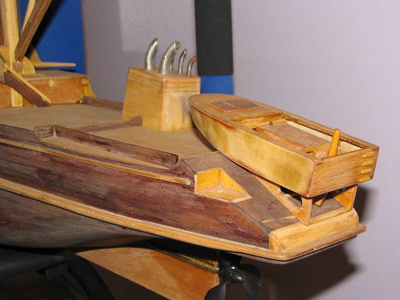

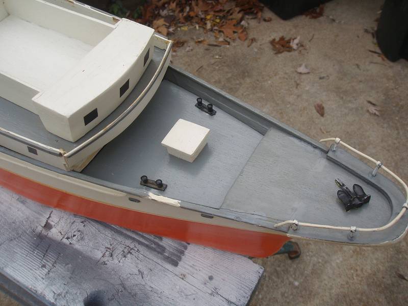

I found some spar vanish on my last ship, and I used this to water proof the model, both inside and out. I have at least ten coats on her and I sanded between all coats...a very smooth planked hull. The aircraft structure adhesive I placed inside the hull dries rock hard and I needed to place it on the hull where I sanded the planking to thin. I'm not realy worried about the weight of the model...for I will need to add ballast as it is. I did manage to get a near perfect transition to the stern, from the main hull center section. Since this ship has a displacement hull, it will not be a fast boat in the water, but none realy were. Our ship made a good 15 knots when we were going full speed...maybe 16 if we were lucky. We usually cruised at 12 knots. Steaming against the trade winds could put a 30 kt. wind over the top deck...and that is where my bird was and where had to work on my helicopter. Believe me, flying a helicopter off these ships took patience and skill...And working on the top deck all the time had it's ups and downs. But when the weather was good, awesome. I've yet to finish my Hughs 500 for this model, but I will and place it on the top deck. I've ordered my extra three 6v batteries from Hobby Lobby and my bow thruster, and as soon as they arrive I will begine to finish this model. I am also going to send my radio Tx to Ace, and make it a seven channel radio...it's five now. I've the Ace Natical Commader Tx and Rx for this boat. I've one strong 1/4 scale servo in my collection of airtronics gear, and will use this for stearage. I am also thinking of placeing a boats horn in the model, and running lights.
There are a lot of scale items I did not show you I've made for the ship. I've my main engine and ships generator exhaust staks (made from s.s. tubing), stenchon lines, windlesses, and a host of other details I've made for the model.
I would love to see your model...
I would also like to build another ship...not sure what type...but is there anywhere I can find a lot of kits that are r/c and other then Hobby Lobby or Dumas ? I would love to build a model that would have sails and steam power too. I love scale ships.

The Dumas motor is a good one, low current draw which means long run times and a fair amount of torque. Even if you find a used one it is worth getting, built very well. I'm not too fond of the Dumas hardware do to the fact gears are noisy. Yes they make a simple and easy setup but I either install a large enough motor to go direct drive or use timing pulleys and belts. The last Vantec that I bought was 4 years ago and it cost me $80. Technology has made them smaller and a little cheeper. There are several club members in the club that I belong to that still use them, still going strong after all these years.

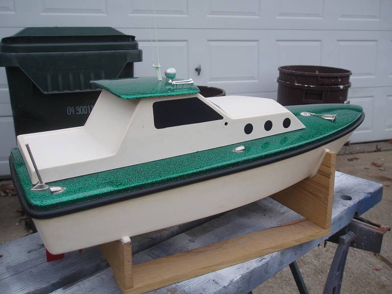

I have an old Sterling models Lumba-Lumba boat, a little bigger than the Tuna boat you have. It has a single Dumas motor in it with a 6 volt 4.5 amp gel cell in it. I can run that boat all day on one charge. For 3 batteries it's hard to say just how long it will run, I would say that it could outlast you. Keep you batteries mounted as low as possible even if this means cutting out the floor in the bottom of the hull. With you having to run your boat in the ocean because of no ponds available this would be highly recommended. The lower the center of gravity the more stable your boat will be.
As for laser cut, 40" w/l sailing vessel that is r/c-able kit, that may be a tough one to find. Here are some more places to try.

I finally found the cable to the camera. Here are some pictures of mine, mind you this is not a representation of my work. After looking it over, the $54 kit looks better and better. There are too many pieces missing and cracks in the hull.

Hay Green-boat,
By the way...how did you manage that handle...?
I received my order from Hobby Lobby, but my bow thruster was damaged. The three gel cell's kind of bounced around a little and broke one tube. I will be e-mailing for a repalcement unit. Now that I have the gel cell's here...I'm not sure I can use them...bummer. But time will tell.
I'm installing the electric motor, gear box, drive shaft and survo now. Then I will know if the gel cell's will fit. They are flat...but larger then I realized. I should have made a template first...you live and learn.
Your bow is different then mine...I've a more nerrow bow...but it could be the picture angle too.
You have a great looking ship...but I would love to get a picture of your inner workings and how you set up your power system. I would also like some close ups of your decking...and equipment. The kit had little shown in the pictures...but I've a ton of picturs I took on board my last ship...if I can find them up in my attic. How does it sail under power...?
Neat boat...and now I am driven to get my ship sea worthy.

Bob,
My "handle" came from one of my boats. It is a modified Dumas "Mucho Macho". It was put out for amusement parks, put the quarter in and run the boat. Dumas made them in 16 different metal flake colors and sold them to other companies that fitted them out and resold them. Some were single screw with a rudder and some were twin screw with no rudder. I got mine before it had been fitted out. As of today I have 8 different colors, still looking for the other 8. They were made in the early 80's so finding the rest is a challenge. I'm not a collector of them but it would be nice to have one of each. The boat had never been named and just got refered to as the "green boat".
As for the inner workings on my Tuna boat, there are none. I got the boat at a yard sale and it looks like someone had built it as a static. Thats why I'm wondering if I should get a new kit from Dumas or strip this one down and rebuild it. The hull sheeting is cracked in places, no stuffing tube, no rudder tube, wood grain showing on the superstructure and deck................

That is one great looking model boat...and you have so many of the same model, abit different colors. If you have an extra one you want to get rid of...let me know.
I found a kit of the Sterling battle ship model, but when the price hit over $300.00, I let it go. I will build from plans if I need to, and I've yet to investigate this area of the hobby...boats built from plans.
I've yet to reveive the replacement bow thruster from Hobby Lobby, but it should arrive soon enough. These folks have been good to me so far.
I did not put my propeller shaft in until after my hull was build. So you can still do it if you want, but to build a new hull will be an experience. The kit is not that good in the "parts fit department", but it is cheap at $54.00 buckaroos. I modified my hull, so the upper deck is flush to the sides of the hull, like on my last ship. I also added the stern tie down point on the port side, and set up my net pile area for my chains, net and corks. I added a stair way from the fish deck to the bridge deck on the center fish deck and one in the bow area. The cap to the deck was sanded from 3/8" marine ply, and has a tripple tapper. It's warped a bit, but will still work. It was the only wood I could find to do the job, and did that ever take some time hand sand to shape. The fit for the decking isn't perfect either, but considering my first attmept at boat building, acceptable. I also installed a rub rail and wet deck rail on the hull...all like on the Lone Wolf, my last ship. I've inclosed a few more pictues of my boat hull and net boat I built for my seiner.
Safe port always,
Bobby of Maui
