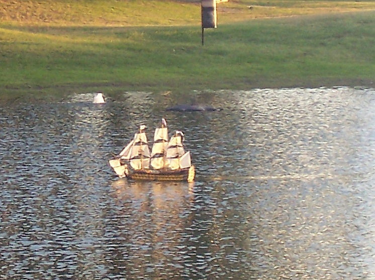

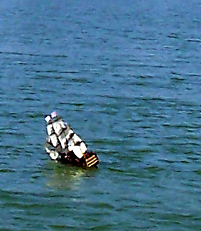

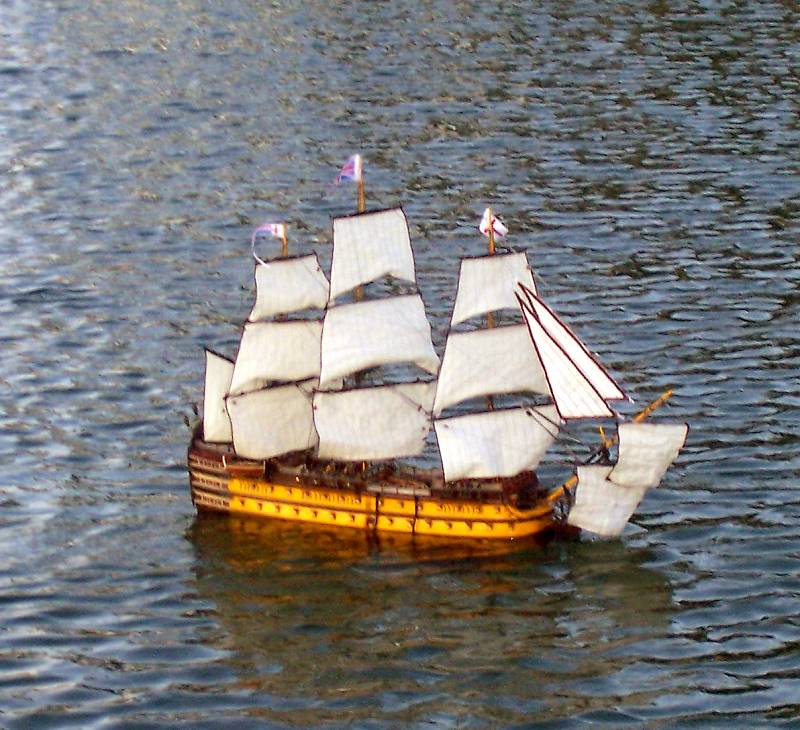

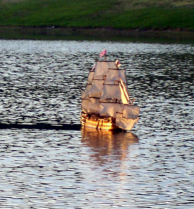

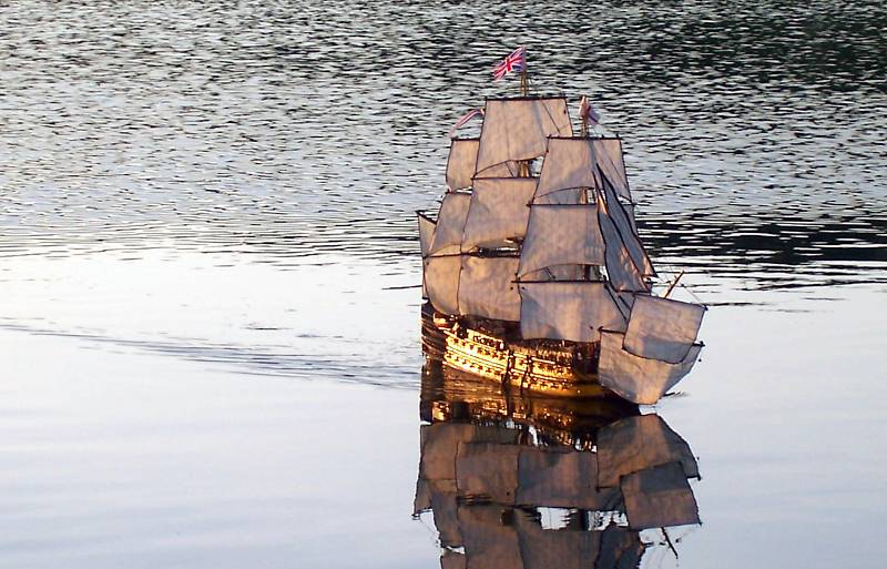

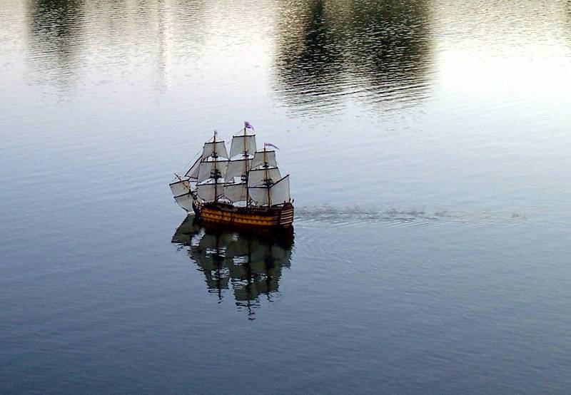

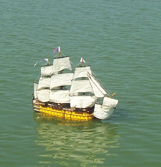

THE HMS VICTORY SAILS AGAIN. SHOTS ARE IN LIGHT AIR TO 10/12 MPH UNFORTUNATELY, HOWEVER, THE SHIP PERFORMS PERFECTLY IN LESS THAN 5MPH WHICH IS UNUSUAL FOR HEAVY MODEL SQUARE RIGGERS. 60 POUND SHIP, 45 INCHES LENGTH OVERALL.
saildog,
I think I feel a 'crying spell' coming on. You just had to show something like that, didn't you? Knowing my building skills, can I borrow your boat for a few days?
- 'Doc
very nice!
- 'Doc
very nice!

Thank you for the kind words. My building skills when I started amounted to a monkey with a razor blade...Perserverance, plus 1 ruined ship and 2 sunken ships finally paid off. Once you have the technical aspects down the building is just time and energy. Its the technical aspects of these that was so hard for me (balance, keel size and rudder, center of effort, sailability etc., etc.,). I asked a million questions from those who knew about square riggers (there are very few in the world).

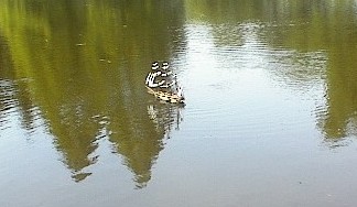

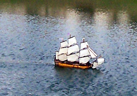

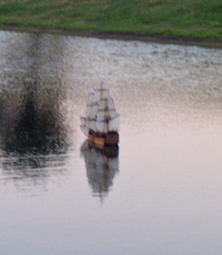

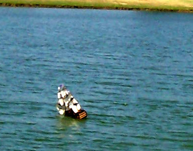

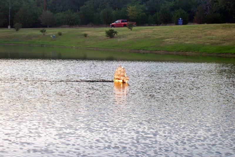

Heres a few more in higher wind....Wind here went from nothing to 2 shots shown which are in about 25MPH wind gust (ship is heeling). Welcome to Texas wind in the summer. The ship will probably take 35-40MPH with the main deck just dipping the water, but waiting for that key windy day for testing. Won't it sink? No, I learned the hard way, its filled full of styrofoam for the most part.

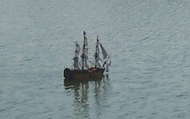

today my Napoleon made her maidenvoyage,
still without extra keel- I think I have to learn the hard way...
fortunately the wind was very light and still she heeled up to 45 degrees.
Your models are very impressive, did you ever consider to RC them?

Yes, some of my ships are RC like the USS Constellation shown in this photo attached.
