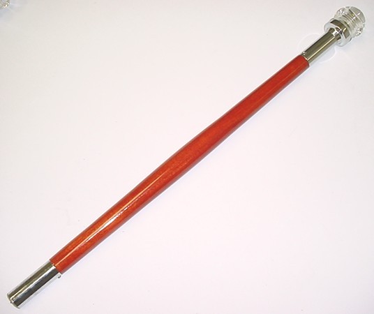

I made my flag mast/stern light base today. I turned a piece of aluminum rod and then bent the tip at a slight angle. I need to find a suitable lamp to attach to the top of it.
All that is left detail wise, is a deck navigation light and the dashboard.

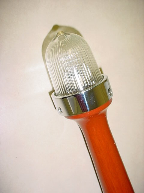

I also got my jackstaff stern light installed.
