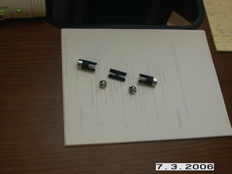

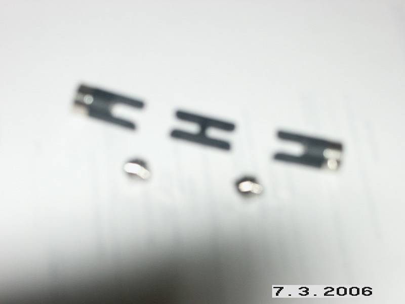

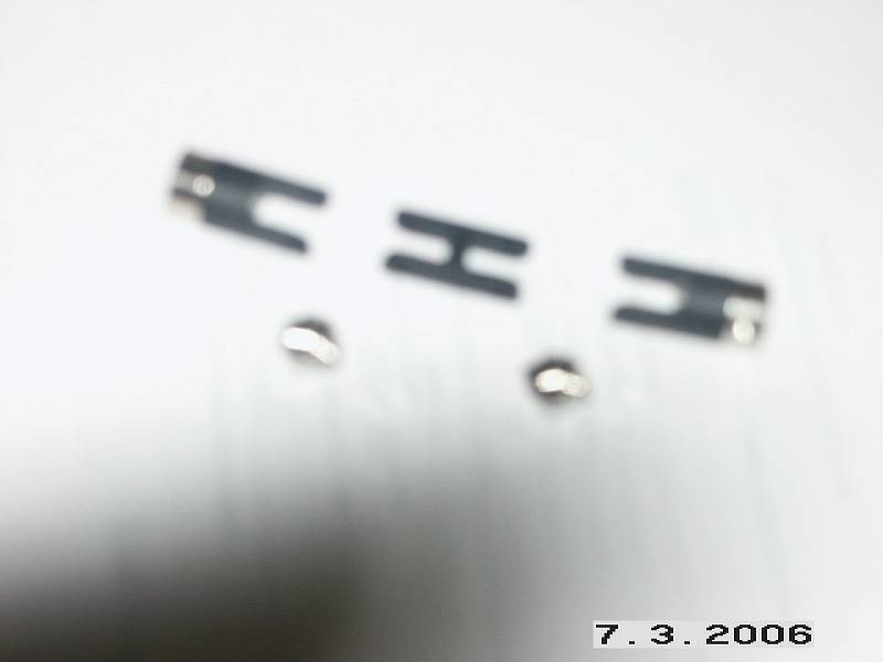

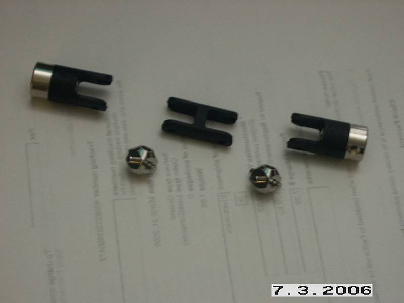

Does anyone have information as to the assembly process for the Graupner shaft coupling #346? There are five parts to be joined but it seems that the plastic ends are too stiff to insert the metal pin blocks. It is being used with a Graupner Speed 900 motor and the Graupner Schottel drive unit, part number 2335. Any help will be greatly appreciared.

A clearer photo of #346

I'll get it right soon!!

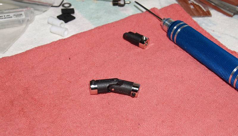

marjin: it's very easy once you know how. What do you need to know? Heat.........
Run the uni-joint under HOT tap water. About a minute should do. Then use a screwdriver, butter knife, etc to spread the jaws apart while inserting the knuckle. After you get it inserted, squeeze the jaws together again so they fit tight and run it under cold water.
I just built this one yesterday. The hot water trick I learned on my Traxxas r/c trucks which require frequent u-joint replacement!
