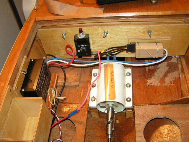

Hi guys! I'm Brian. I'm usually over in the Speed-Gas Boats section. Up until today I was the owner of 2 Gas Catamarans. Last week there was a guy on JRCBD selling alot of boats. This Teak Cruiser was one of them. My uncle owned one simular to this boat, way back when I was a kid and in the back of my head I've always wanted one too. The price was right, so I bought it. It showed up today at work via the FedX guy. I just got thru unpacking it, and clicked a few pics. I'm curious as to who, and when it was built. There is the name "Bob", and a phone# 925-6885 penciled on the upper deck behind the door. Does anybody know this boat? Thanks, Brian
ID:	565213   Click image for larger version
ID:	565214   Click image for larger version
ID:	565215   Click image for larger version

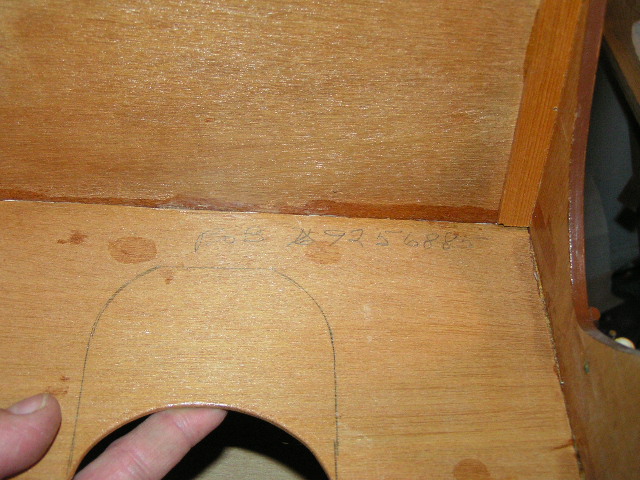

Nice find there. From the looks of the Astro motor I'd say that it is at least 10 years old. Did the radio come with, is there a gold sticker on the back. The gold sticker will indicate if it is a narrow band radio or not. Narrow band radios came out back in the mid 90's.
Could the phone number be the guy you bought it from. Is the prefix (first three digits) in your area. I have been known to write down phone numbers on pieces of wood while building. Sometimes it is easier to find a piece of wood than scratch paper.

Thanks for the reply green-boat. I did ask the guy I bought it from about the history. He bought it on Ebay on March 20-2004. Payment was made to a Coni Stone [email protected]. The name Steve Crawford also appeared in there somewheres. It came with a radio. It's an older stick Futaba FP-T2NBR on channel 26.995. (pics) The guy I bought it from is named Rip H... in Texas, so the name and # inside are from a long time ago, at least 10yrs. Thats when we had to start using area codes to make local calls. Guess I'll try emailing Coni Stone and see what happens. I have no clue what those 2 electrical boxes on the bulkhead, in front of the engine are for. I was also told the boat runs on a 12v-7amp gell cell battery. The battery tray is about 5 3/4" x 3 3/4". So now I need to find somewhere to buy a battery, and the correct charger for it. The Piraniah charger I use for my other boats won't cut it for one of these batts. I read you need to be careful not to pump too much voltage into a gell cell and boil the gell. Oh yea! The boat is 50"x14"x14" high. Thanks, Brian

Try googling Bob and the phone number and see what pops up.

The small black item with the red button is a circuit breaker. There is a number on the end of the button, that is the amperage rating. When the button pops out, it's tripped. To reset, push back in till a click is heard. The other item I'm not sure of, it looks to be wired between the motor and the ESC. As for a battery, is there a Batteries Plus or an Interstate Batteries near you. They should have a sealed lead acid battery, gel cell that would work and the correct charger. A gel cell needs to be charged with a low current almost a trickle charge. Home Depot or Lowes might also have one in the electrical department with the emergency exit lights. I have a number of old emergency exit light chargers that make wonderfull cheap chargers.

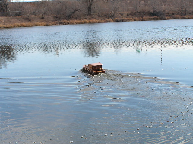

Thanks Phil, I got to thinking about how I thought the battery died. Actually it just kinda slowed down, then stopped all by itself about 60ft away. I dragged er back in with my retrevial boat. When I got home I charged the battery and put it back in. Nothin!! Just some clicks from the esc. I pulled the motor tonight and jumpered it directly to the battery, It works fine. So I pulled the mystery box off the bulkhead and discovered it had 4, philips head screws on the back, so I pulled it apart. The pictures tell all, its a whatchyamacallit!! LOL Anyhow I did a continuity test on it and it checked good. So now I'm thinking I might need a new esc, huh? Just where would I find an antique like that one? Or should it be updated? Thanks, Brian

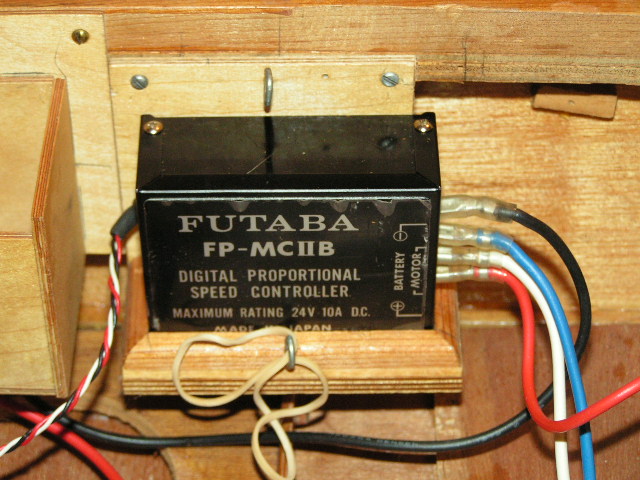

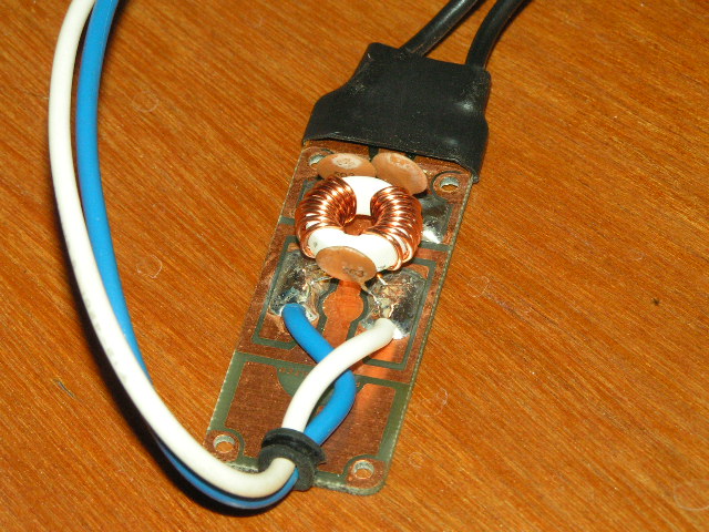

The mystery box is an electrical noise supression unit. They are using 3 capacitors and a torroid coil. It helps to reduce the electrical noise that the motor generates for finding it's way back into the ESC and reciever. Nowadays they just use the 3 capacitors soldered from the motors leads to the motors can and one capacitor between each motor lead, simple but effective.
That ESC that you have is an antique, you might find on Ebay if you are lucky. I would just get a new one. Since you have that particular motor I would get a reversible ESC that is rated for more than 10 amps. Something like a Super Rooster. It is one of those that are used by the RC car guys. I don't know what kind of current that motor pulls but I willl do some digging around and see what I can find.

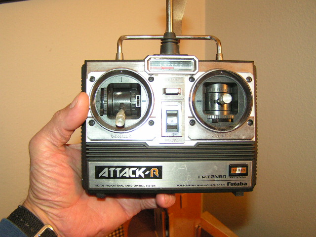

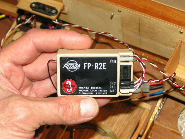

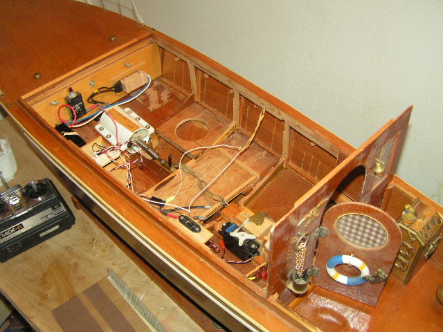

Bmad01: All your equipment is from around the 70's. The square post on the servo is from that era. I still have some of mine. Believe it or not, there are collectors out there who will want the servo and control horns for that square stuff.
If you are not concerned about keeping your antique boat "all antique" then pull all that gear out including the motor. You can get a new, modern radio on ebay for nect to nothing. All the RTR trucks/cars come with very decent radios and lots of guys pull them out immdiately to drop in the high dollar racing radio gear. You can look for a Traxxas system, for example, and get them NIB for $10 for the Tx, Rx, and servo. For a motor, for $3.50 you can get a Johnson 700 motor that will run up to 18V max but will be very powerful and live forever on 12V. For that big motor, you would use an ESC in the 40-50A range and those are not too expensive.

Brian, as a proto machinist you certainly have an edge over most of us when it comes to modeling! I would make a custom mount out of billet with built-in water cooling.
Hobby People has several marine ESC's you can look at. Mtroniks is one of the brands they carry and Mtroniks is highly rated. The Xtra brand I believe is from Ripmax of England. You can also look at some others that are not carried by the major mailorder houses. Such as MCD from Canada and Electronize from England. An RCU member here has two of these motors in his Dumas Prime Time yacht and they are both controlled by a single Electronize esc.

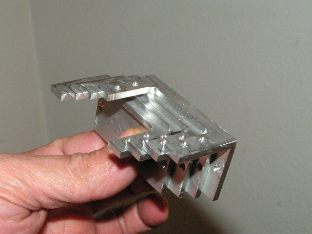

Thanks for the links Kmot. I could'nt get the "more info" link for the Mtronics at Hobby people. But the MCD, Minicon Max was very impressive! I'll probably call them like they suggested. I've got to have reverse in this boat, it's all part of the game. Backing away from shore was definately FUN! The Electronize FR30HX was cool too, but I don't do english pounds.
As far as making a mount for the Johnson motor ,, That will have to be put on hold for a while. My last day working here in Denver was today! I quit!! Actually I found a better paying job about 17mi from home. I start on Monday. But seeing as it was my last day, I whipped up these servo mounts for my personal stash on company time! HAHA! Brian

I've started a retrofit. I pulled the square post Futaba FP-S23 servo, and it's flimsy mount out. The boat also came with an extra servo. (no mount) It's another Futaba, but a bit bigger in size. It's a Futaba 1C servo, Fp-S7. If anyones interested, I'll sell em both with control horns REALLY CHEAP! ([email protected]) I bolted in a Hitec HS-475HB servo and replaced the pivot arm too. I was on Ebay last nite looking for radio's like Kmot suggested. There was Traxxas stuff on the block, but it was all pistol grip stuff. I'd like to get a stick radio for this boat. Something you can just set at full throttle and steer it once in a while. I went to Hitecs website and their getting about $40.00 for a 2 channel AM radio with a reciever, and 1, servo. HUMMM I'm going to call MCD next week and probably order a Minicon Max ESC. The weather out here has suddenly gotten very cold and I'm expecting the lake to freeze up any day, so this retrofit is in no rush. I'll post the progress as it happens. Brian

Hey Brian, your servo mount is a far cry from the "before" version! [sm=thumbup.gif]
You can look for inexpensive two-stick radios as well on eeeebay. All the major radio mfg's make them. Just be sure you get one on the 27 or 75 Mhz freq.
