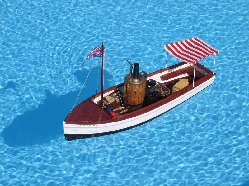

Also.....would installing wood insulation like this one around the boiler increase performance?

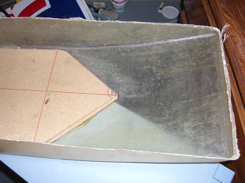

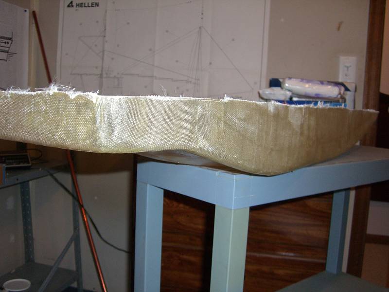

Default RE: thinking of steam

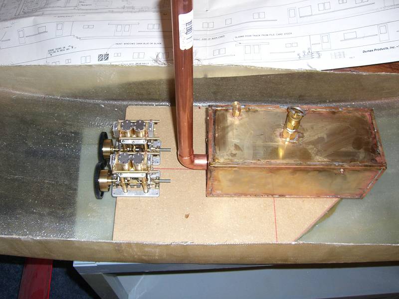

I got the plug for the hull dun. its 40x12. next week ill poor the mold and lay the fiberglass. I also have decided to run two twin cylinder steam engines instead of one. ill probly order then next week allso. It’s hard to see the curves in the hull but I think from the pix I have its clows to a tow boat.

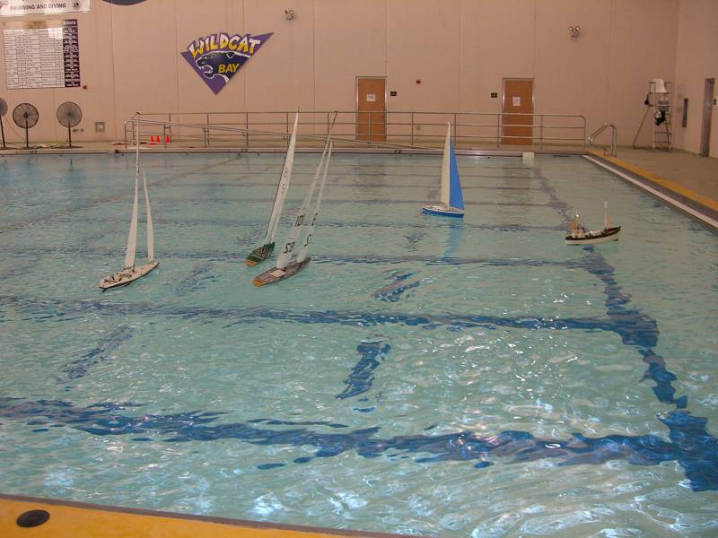

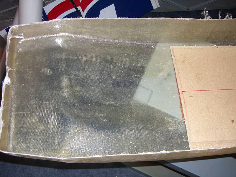

got the hull layed. 3 layers of 4 oz cloth. i still need to trim the top and lay some more glass inside. all the steam stuff should be hear next week. went to a pool party. some of the gys with there sail boats.

I just got dun with building the 2nd steam enjoin. I have it Brock in and thought id hook them up to run off one throttle valve. Well after tweaking the timing on both enjoins they will not run at the same rpm. Because it is an air piston enjoin if one has more revisions or load the other picks up speed. Now with two throttles you could compensate one for the other but with now way to see the rpm on the transmitter of the enjoins im thinking of just linking the two enjoins together. If I fix two gears on to the flywheel of each enjoin and put then next to one an other they will be counter rotating. Don’t worry, I have it all in my head. Now on two the boiler.

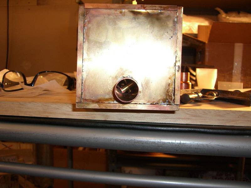

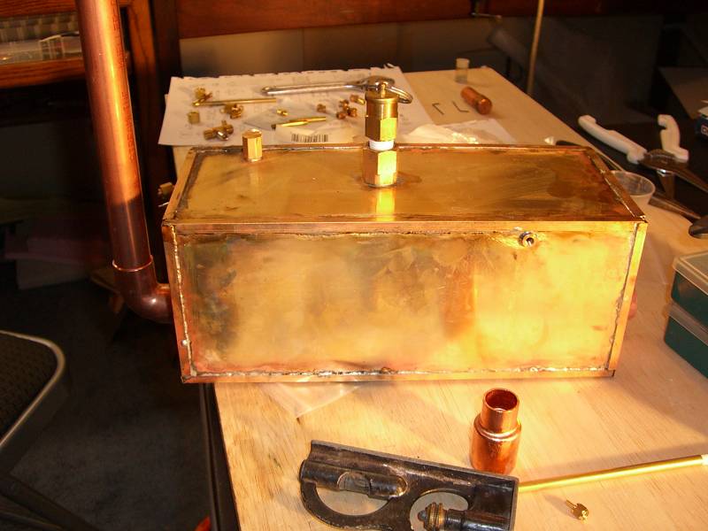

it may not look that good but it does not leek. now ill do some live steam tests.

About the wood cladding on the boiler. On the Heretage engine there's also a layer of insulation under that wood. Does it help conserve heat? Guess it has to to some extent, but doesn't mean much by way of performance. I figure it's more for looks than anything. I'm sure theres a way to put a throttle on a small steam engine but I doubt if it's gonna be a simple thing to do (I wish!). Usually it's all or nothing.
Benny, you scratched that boiler?? That is awesome broh!! [sm=thumbup.gif]
What is the pressure relief valve set at?
thanks, Like I seed “its not the nicest boiler out there but it dose the job”. Ill be putting some insulation around it. I might also build some steal brace around it. I noticed that at 35 psi she starts to bow out. Id hat to have a seam fail and fill my boat with boiling hot water.
Old 03-07-2007 | 06:06 PM
  #50
Joined: Aug 2006
Posts: 156
From: brooklyn park, MN
oops. yes the presure relief is set to go at 35 psi. that is the max thay say to run the motor at.
