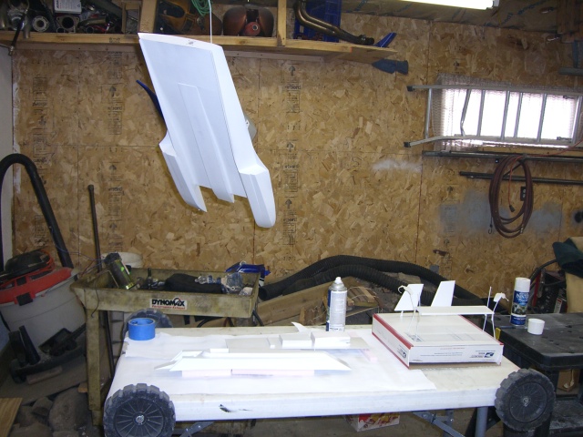

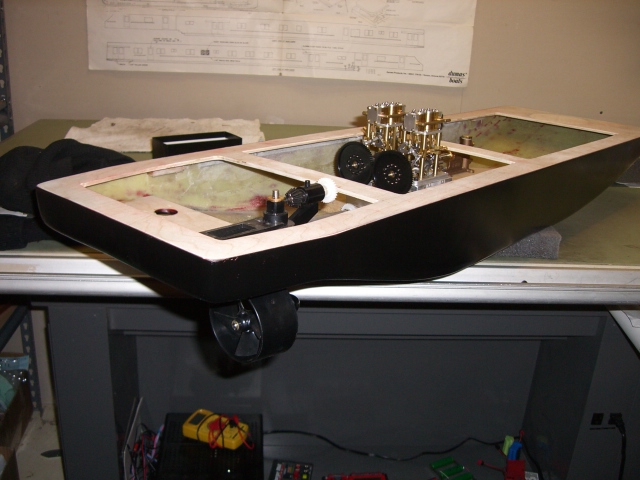

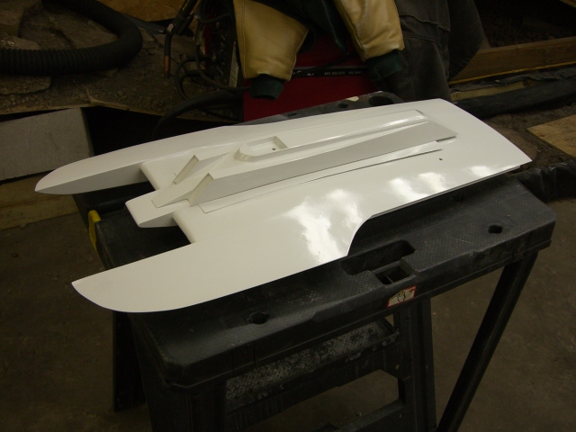

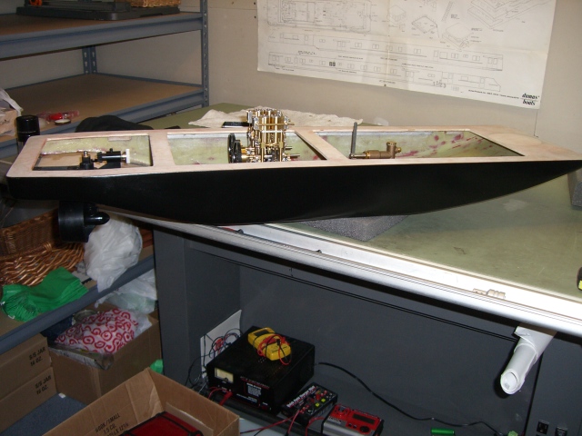

ive been away from this boat for some time. here is an update.

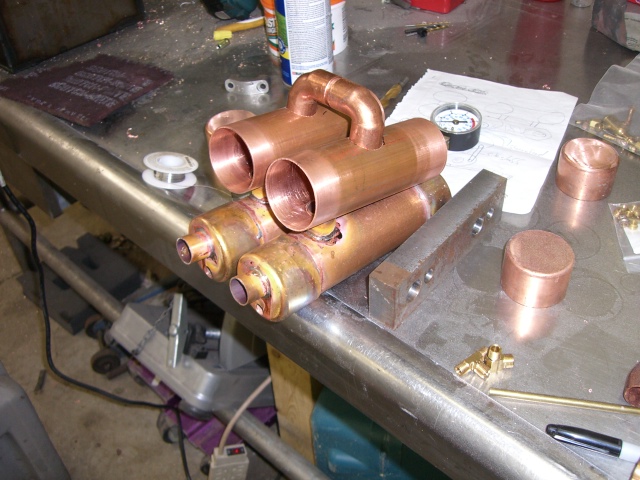

So I started to build the boilers today. Lee came over with a boat and some beer. He is going to be doing some painting.
