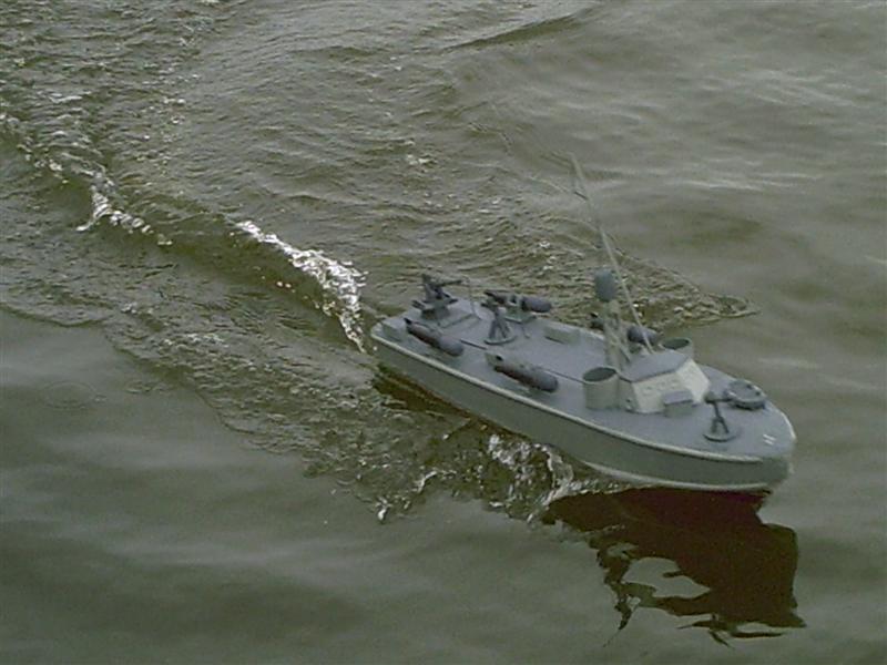

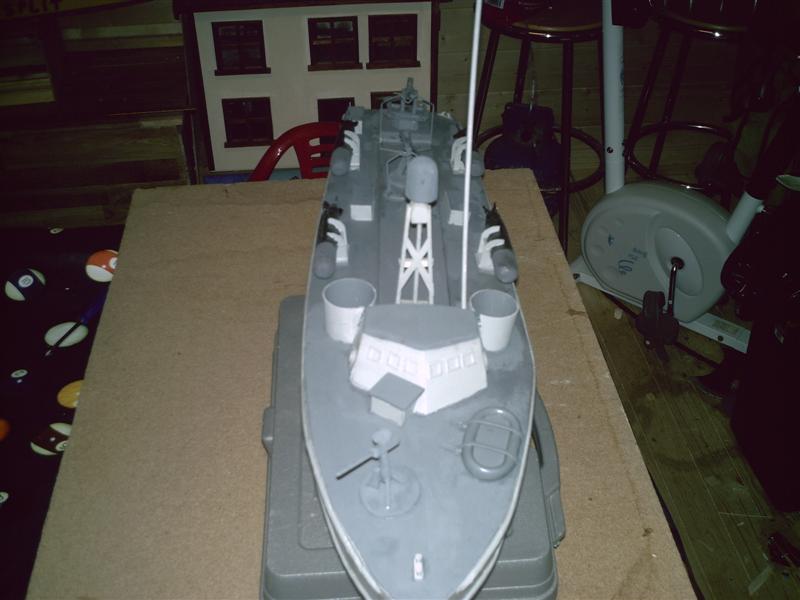

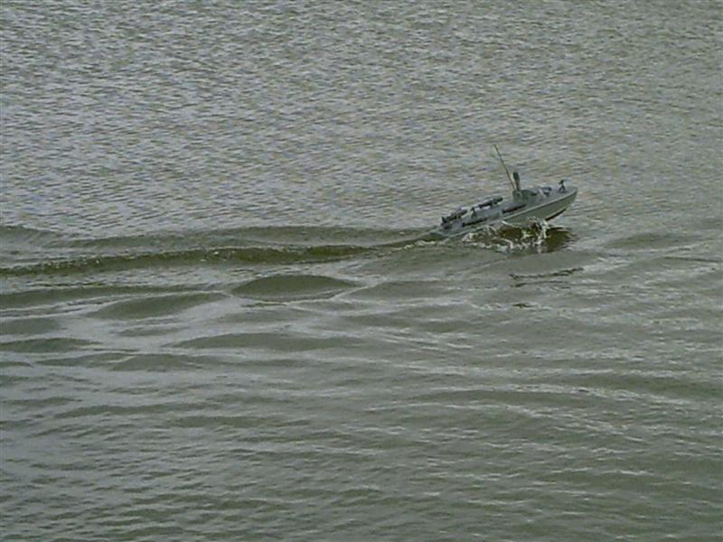

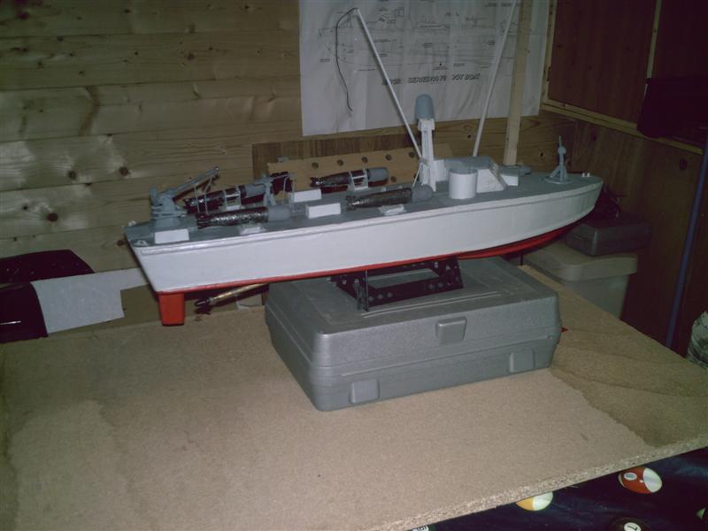

it depends what use the boat is for if its a slow boat? or fast? i built this mtb from balsa its just sealed using epoxy 3 coats no glass.if your gonna go banging it about id glass it using .80 g cloth and polyeter resin as its cheaper.polyester resin and epoxy wont mix though so if you do use any epoxy on the hull dont use poly resin use epoxy resin otherwise its fine.if its a slow ship like a tug or battle ship the glass isnt needed.my ten yr old drives this boat and it has held up well so far .and its pretty fast.
[img][/img][link]http://media.putfile.com/sams-pt-boat-xmas-2006[/link]
also try this company for cloth and resin this is the cloth i use or you can use the 126g
[link]http://www.ecfibreglasssupplies.co.uk/store/-c-43_102_103.html[/link]
