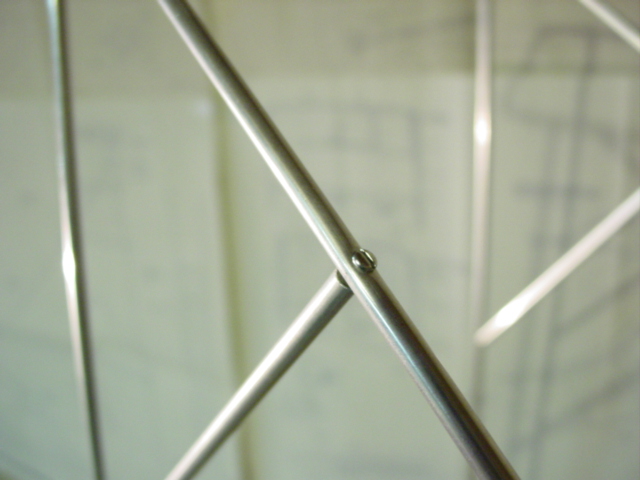

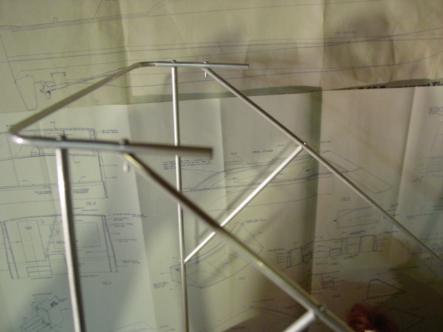

In my experience the best and strongest material to use is either aluminum or styrene tubing stuffed with wooden dowels. You will have to drill pilot holes...which will take a bit of patience. Then screw together with appropriate sized screws ( I got mine from the local Ace Hardware(ask the clerk for special sized screws) Here a a few pics.
