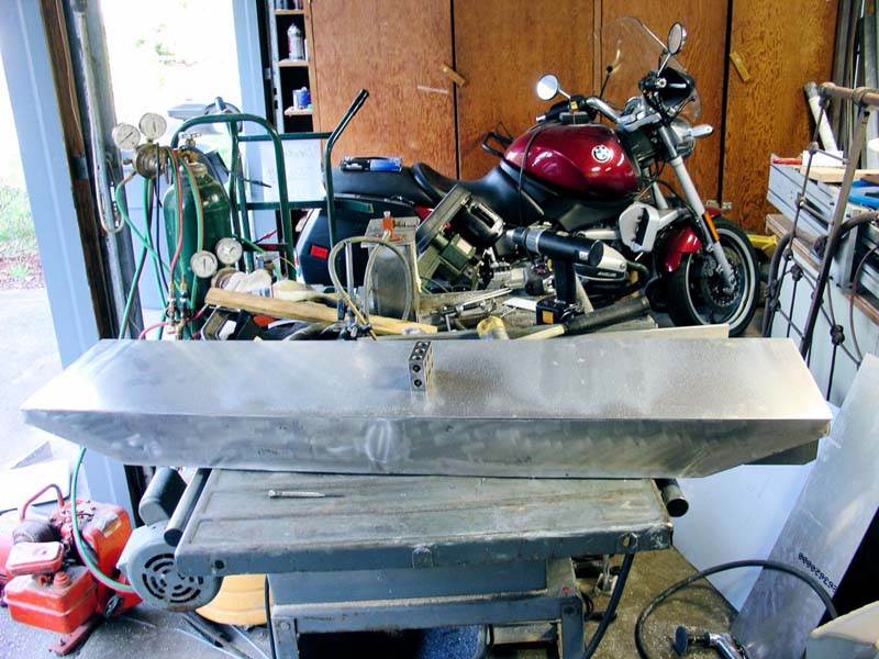

You could build it out of Aluminium...
I'm not joking... No, really... aluminium

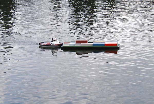

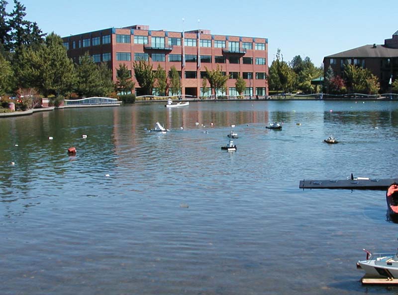

Here it is undergoing sea trials.
And one at the reggatta after we cracked the valve and sunk it.
All the tugs running around are chasing the cargo.
The system needs work, as it sunk perfectly, but had trouble pumping the ballast tank to refloat.

did you weld it
Old 11-06-2007 | 08:29 PM

ORIGINAL: merc1500
did you weld it
No!!, I didn't weld it....[&:]
I had a friend weld it...

It's just a submersible pump in the flood chamber....
It didn't refloat the first time, during full testing, because there was too much water coming in the gap at the deck and in spaces throughout the barge.
The second time, at the event, it wasn't properly balanced, and rolled over.
But there were lots of tugs to recover it.
