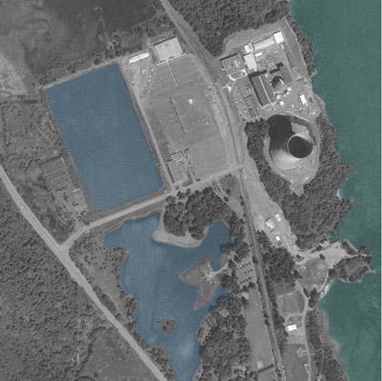

Yeah, I have had horrible luck getting a TT. The first one I got completely ripped off still haven't got my money back. And this one I just bought from a guy in Ny, and I was tracking it's progress and it says my package is delayed due to a trail derailment. So I am wondering if it was the train my boat was on, or if it's progress is just slowed due to the rails being down. Hopefully it will arrive in one peice, or at least the peices it is supposed to be in. The Hull is setup for single screw, for a 36" hull what size prop should I go with? I am trying to work out everything for the drive system right now. I am looking at doing a 12V system, with a speed 700 12V motor, 2: 6 volt 7 AH sealed lead acid batteries only 12.15 each [X(] and a proboat 12V esc. I am just trying to figure out prop size and blade number, what prop shaft I'll need, any adapters to connect it to the motor, something to mount to the motor. and if I'll need to use a reduction based on motor and prop size, the speed 700 has a free load RPM of 11.1K so DD might be possible. Thanks again for all the help, maybe we could meet up sometime and drive our boats together, I don't know how you feel about salt water and your ships but I know where some rough "seas" are around here, lots of fun.
I need to build one of those Midwest Life boats for salt water and rough seas...
The old Trojan Power plant has a couple freshwater ponds...
Just have to watch out for fisherman and their lines here and there...
[8D]
[8D]
