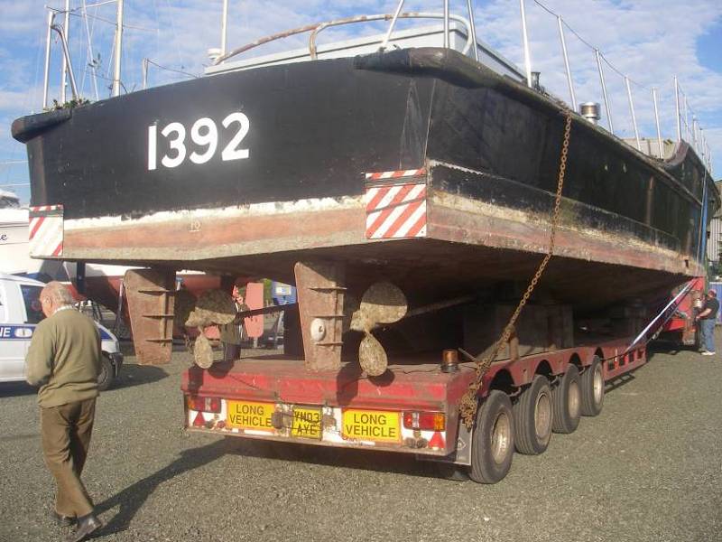

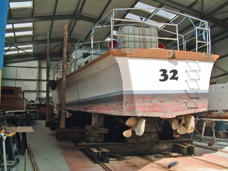

A lot of fast boats built from the 30s onward UK , had both props turning the same way couple of pictures of ww2 boats running gear.
Peter

Both turning the same way is just plain CHEAP ! There is NO way a twin screw boat can dock in a tide & wind equally well, IF AT ALL, with both screws in the same direction.
CHEAP & DANGEROUS.
Rich

I think you may find it made them go faster, they where still using this methoud up to the 60s, have you looked at what was used on pt boats ?
Peter
