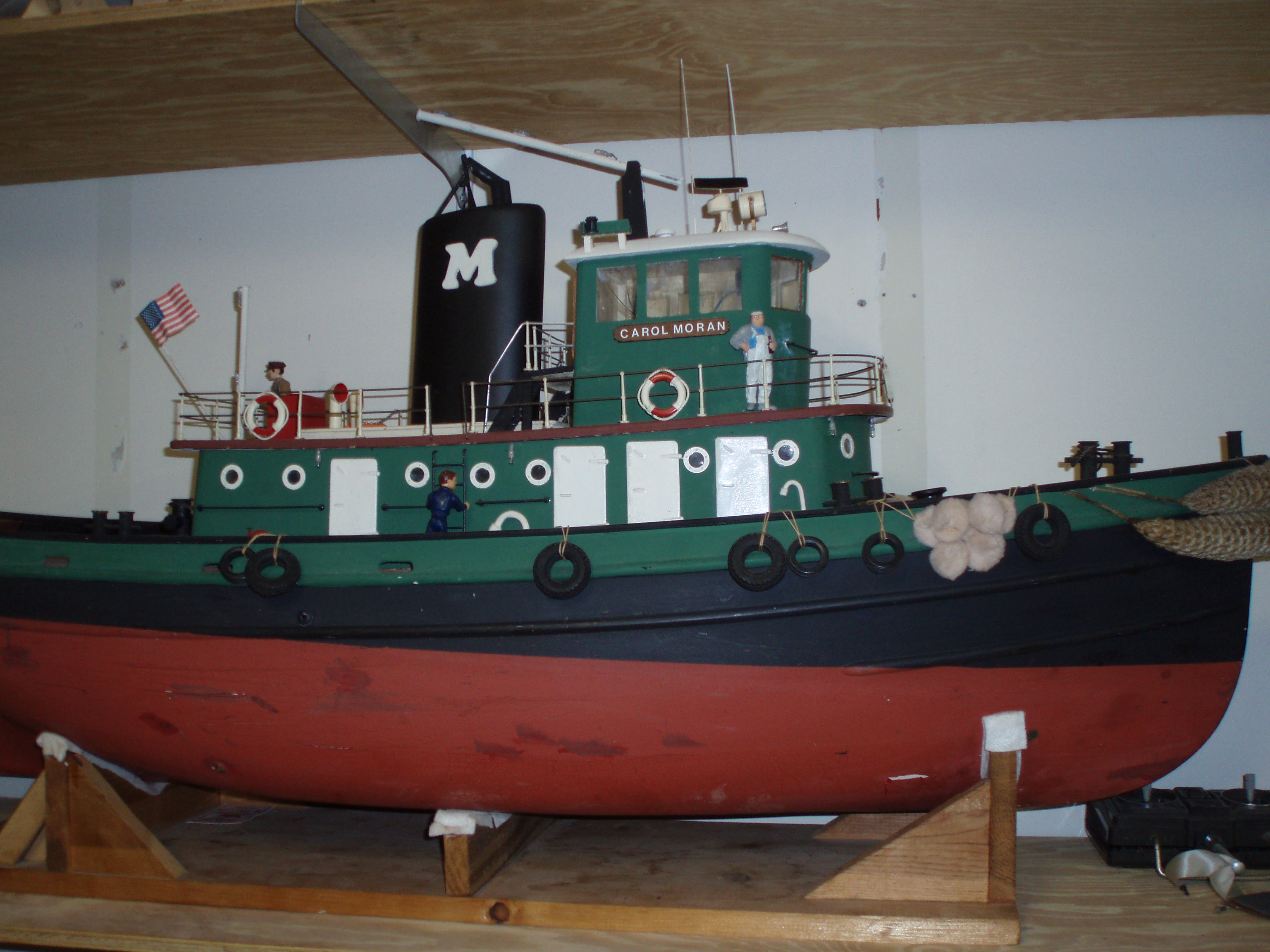

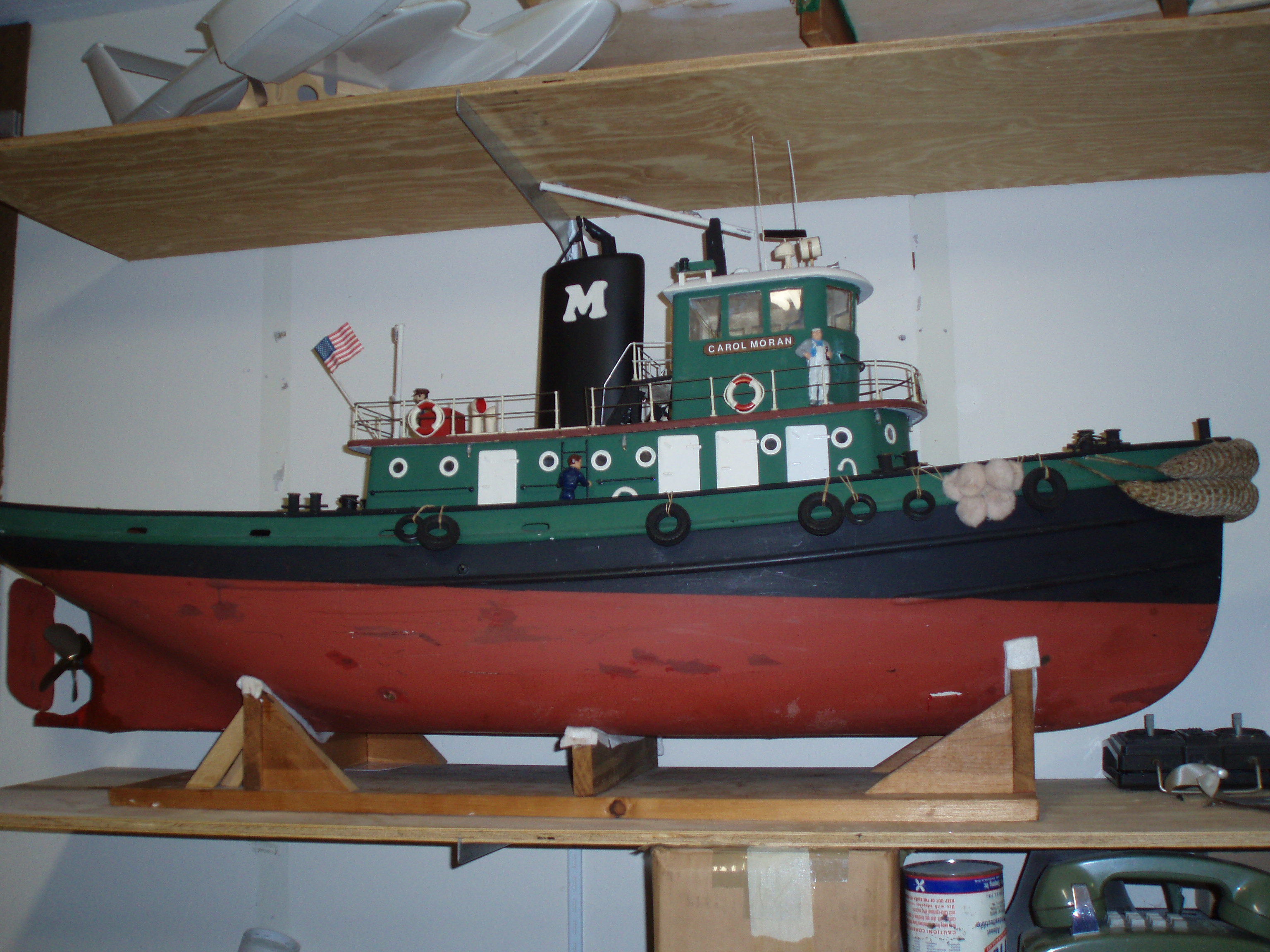

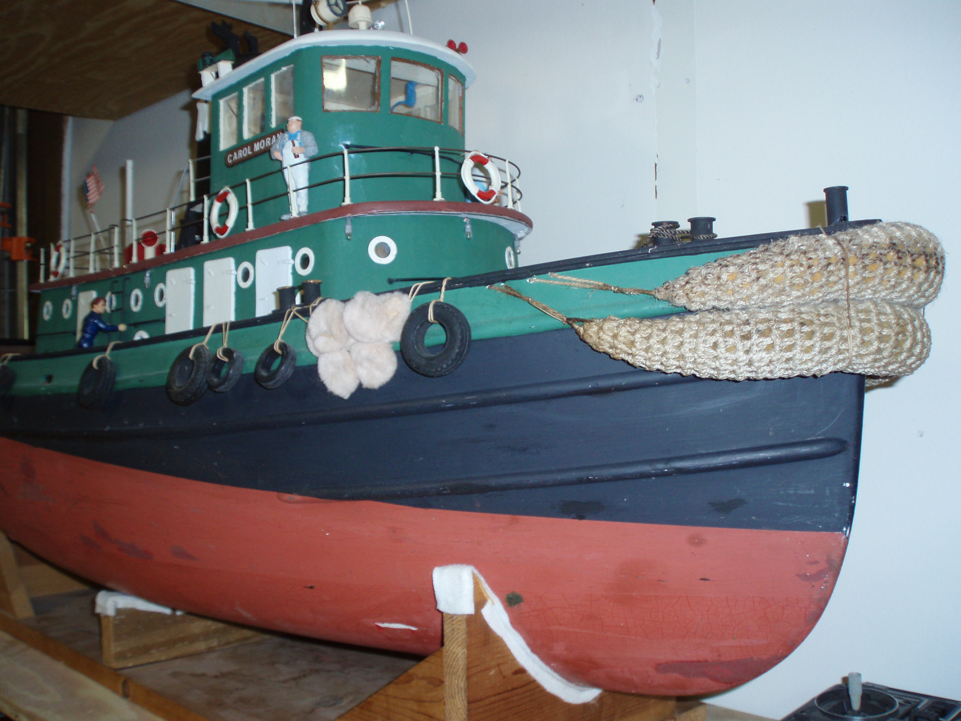

Ken, I purchased mine from Tower Hobbies also. I think that I have about 12 of them now and they all work great. I will try to post a picture of one of my tugs that I use the 208D in. It's a 53" tug with an Astro Flite 40 with 2:1 gear turning a 4" wheel. If the pictures don't show up you can go to my boat club web site (www.waveblasters.org) and check out the pictures in the gallery. I hope this helps you. Captain Bill
