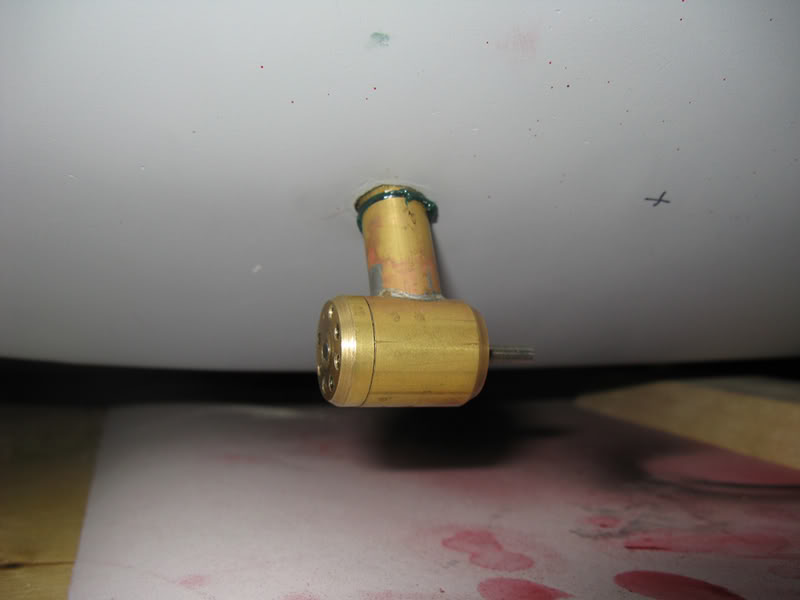

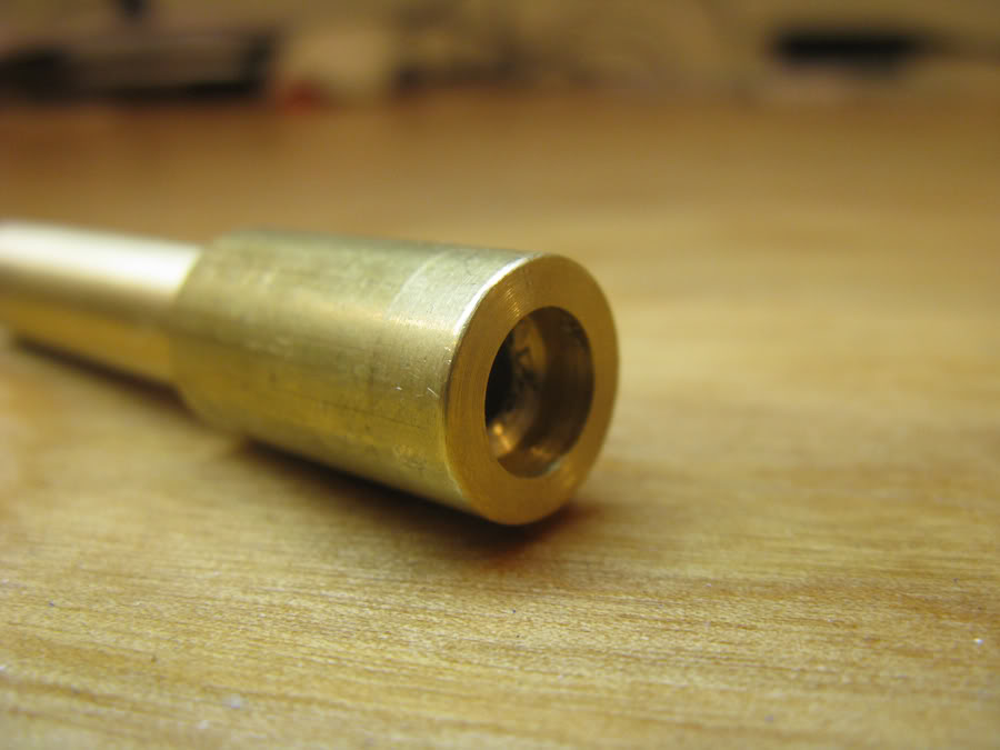

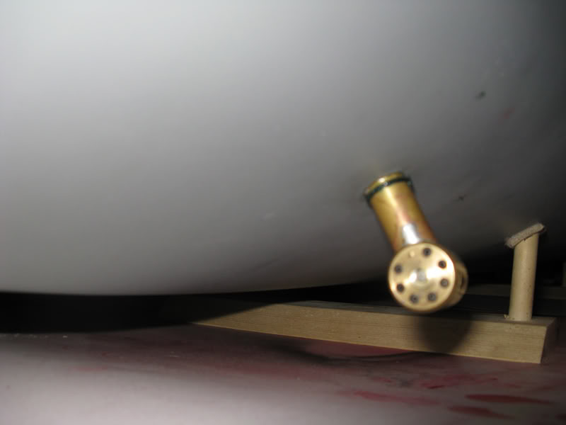

Well, I finally decided to share my RAD project. I've been working on this for quite some time and am very happy with the results I am getting. The project started with a requirement for operation RADs in my model of the Queen of Chilliwack. All of the commercially available parts didn't fit my requirements. So I built my own RAD.
The RAD is machined out of 1/2" and 3/4" brass stock and the shafts and sleeves are dumas 1/8 drive shafts and sleeves. The gears are supplied by SDP-SI, as well as the belts. Servo is a Hitec Continuous rotation servo, and the magnetic potentiometer is supplied by US Digital.

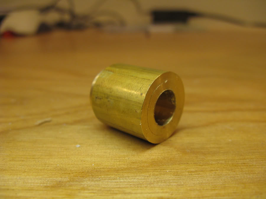

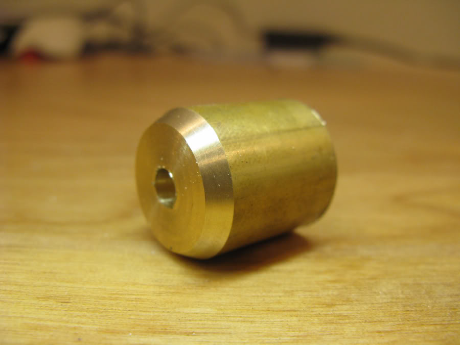

Lower gear casing. Those are #0 hex head cap screws, the pilot hole that was drilled for the thread tap was a 3/64" hole. The threads are so small that you can barely tell they are there.
Lower gear casing.
Lower gear casing.

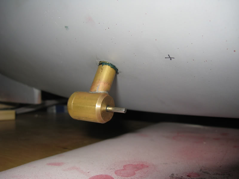

In hull mounted casing. (Fiberglassed into hull. Rad rotates inside the Tube.)

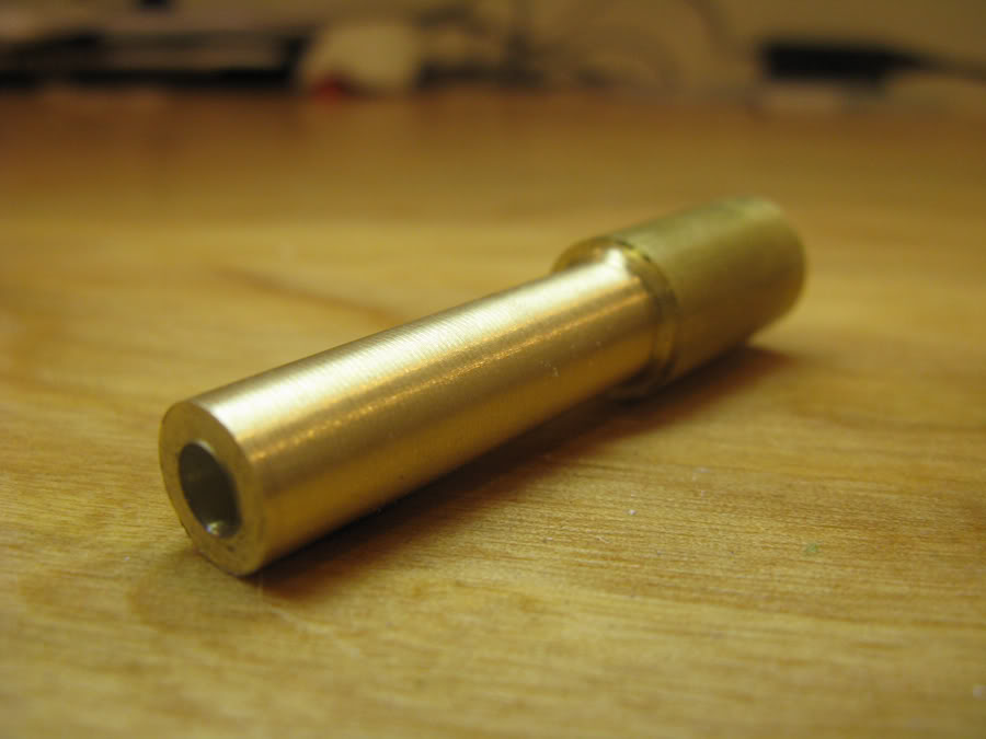

Upper Shaft Casing and through hull component.

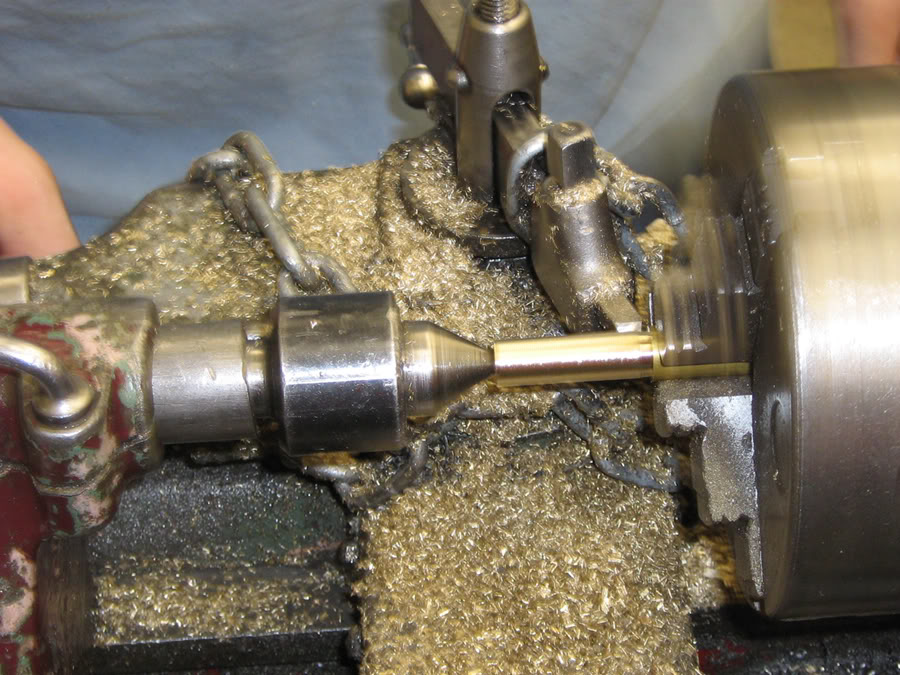

Machining a part.

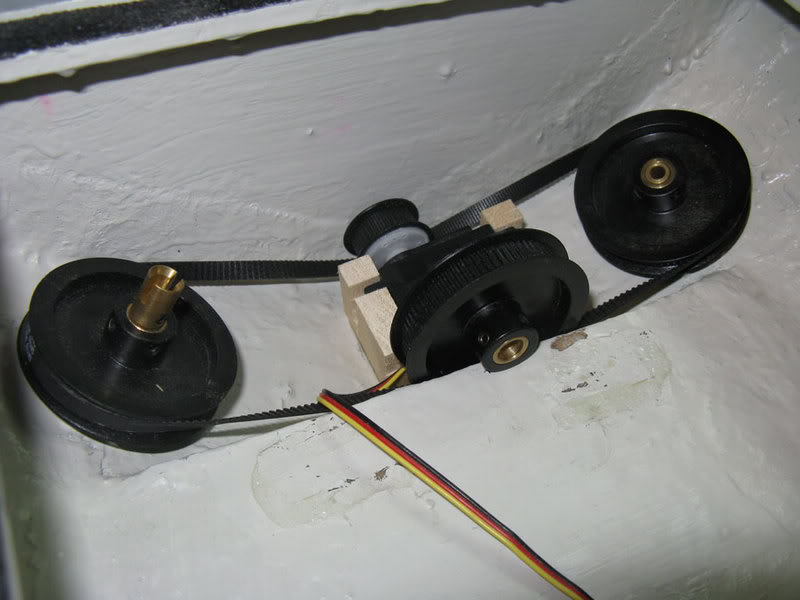

Rotating setup. Toothed timing belt on a continuous rotation servo with a 1/2 drive reduction.
Leg assembled and installed in hull.

Wow! I wish I still had my unimat lathe. I doubt I could create anything like this but would love to try. Can't wait to see the finished project.

The steering set up looks well done. Any hints on how you're
connecting to the motors? Drawings?

I think the only concern is the black allen head screws that
you are using. Those things rust horribly. If you can find some
stainless steel screws, they will make your life easier should the
drives ever need to be disassembled for maintenance. [8D]

Thanks guys,
The black screws are stainless steel. Its a lot of work to get these things going, such a pain in the @$$. The results are worth it though. When I am completly finished I will post some a full set of drawings so that anyone can build one if they want. I chose to go from solid brass stock as it is easy to machine yet still very strong. The only issues IU've had pertain tot he fact that the thing is about 7/8" long and 1.5" tall.
The Queen of Chilliwack has the exact same propulsion set up as the ship in those pictures Umi. I have 4 RADs, 2 at each end, with each end being independent of the other.
As for the website, its running on a POS computer in my basement, so I guess I'll have to take a look at it. I think my router has screwed up since our last power surge.

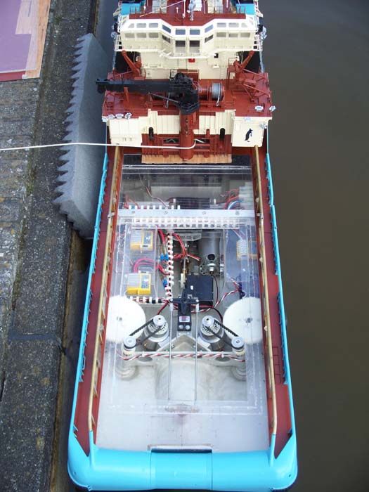

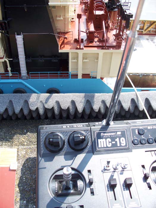

Here's a couple pics of Leen Boers' drive controls.
I his boat and controls while touring Madurodam.
Not sure how he set this up.
Throttle and steering are the two top right hand controls.
Wire controls throttel F/R, twist the knob and it steers the drives.
