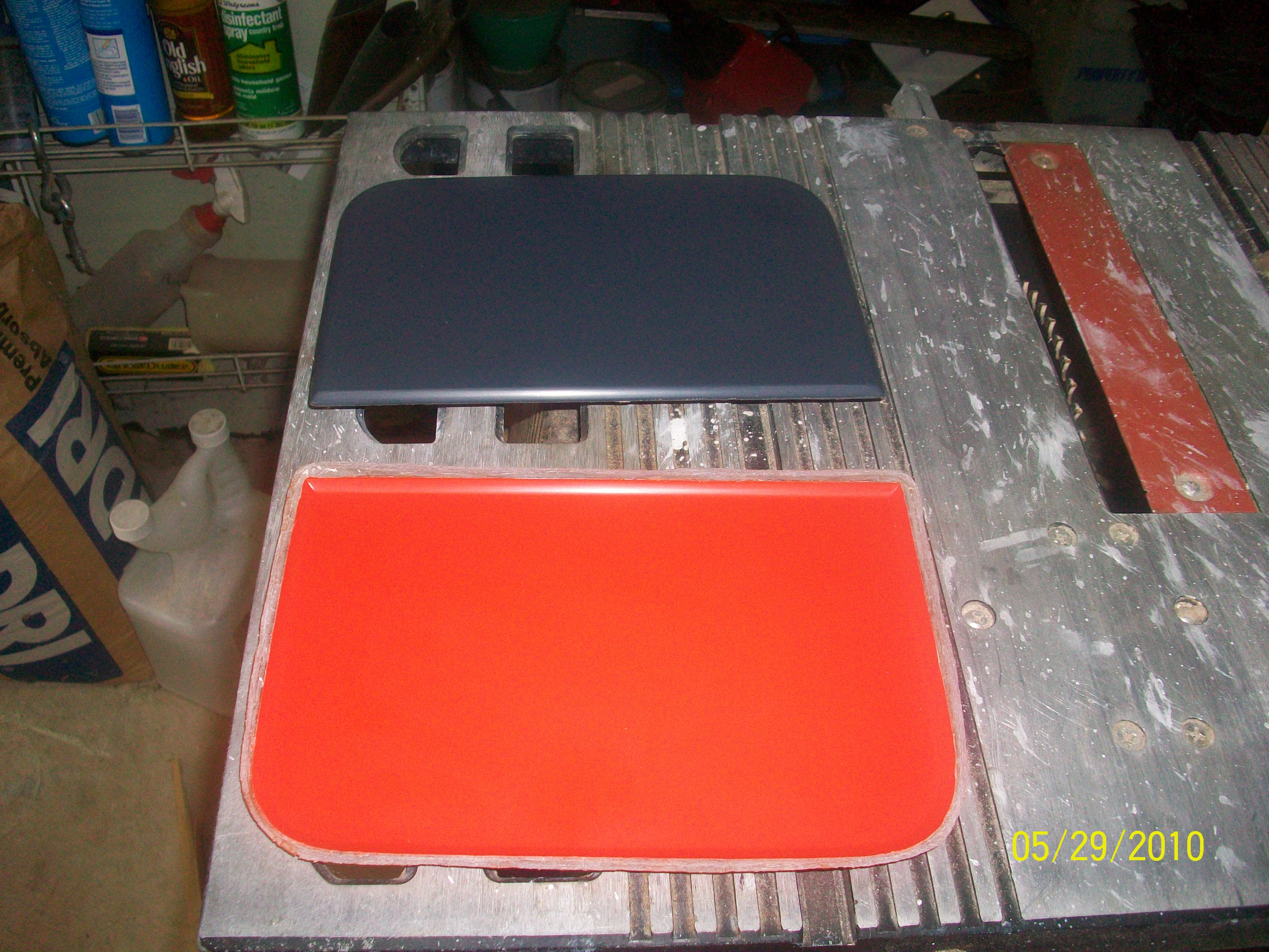

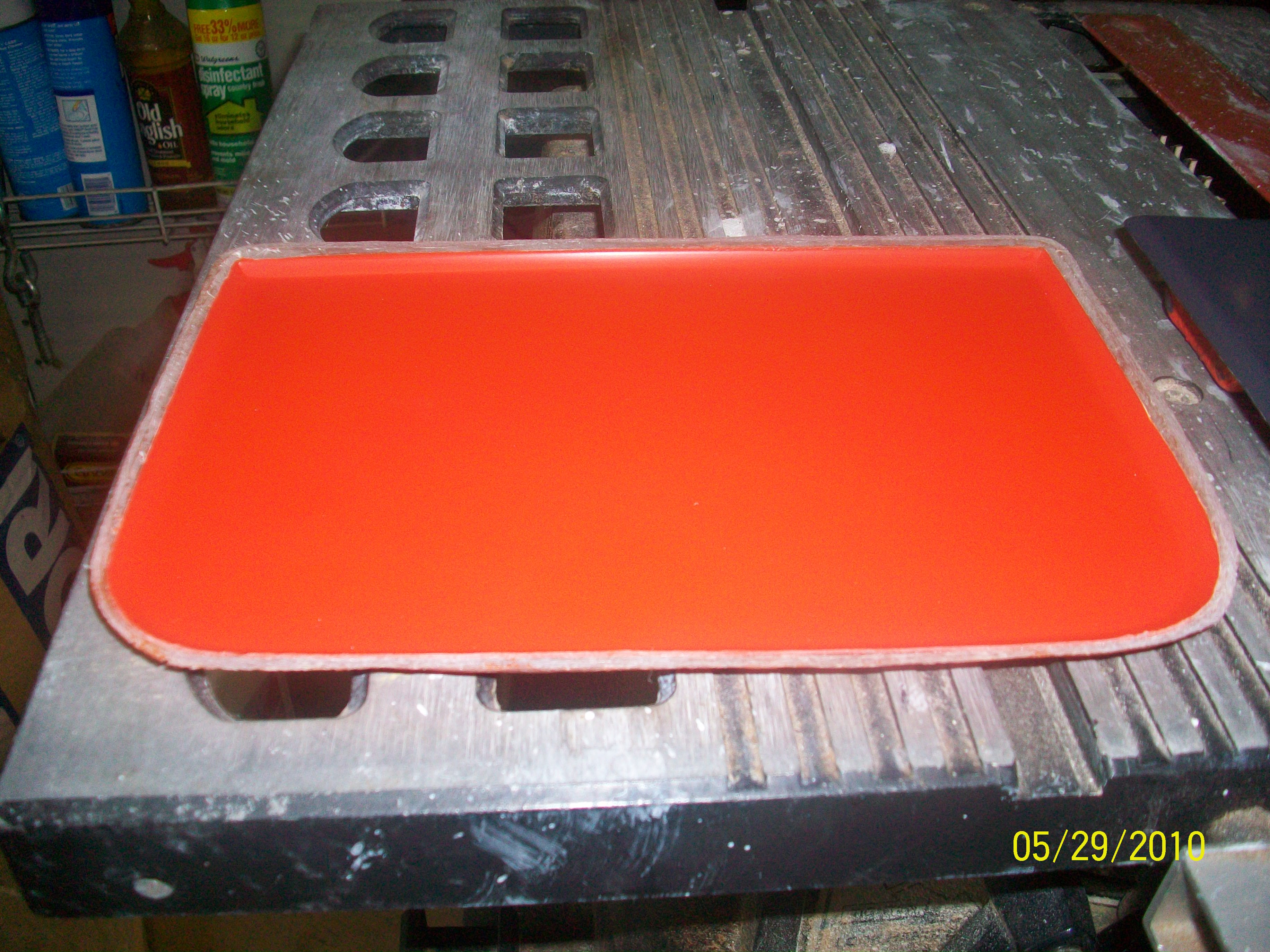

Started building the molds today The first being the scale poling platform, It separated perfectly as will the rest I hope. There will be five molds in all The hull, deck, access cover, poling platform. and center console, Almost ready to go into production.

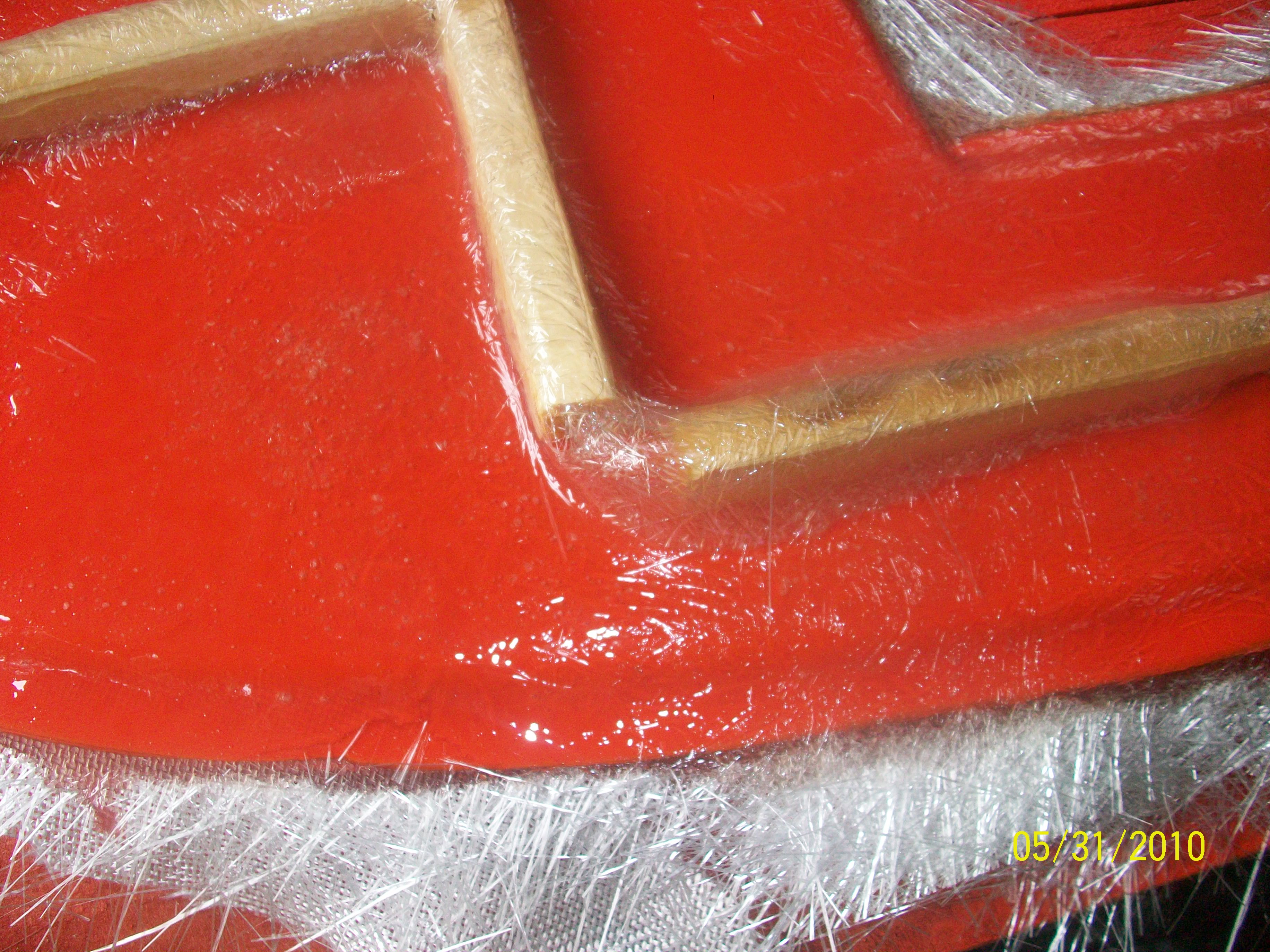

I started the deck mold today I just gotta put one more layer of 1.5 oz matt on it and it will be ready to trim and separate.

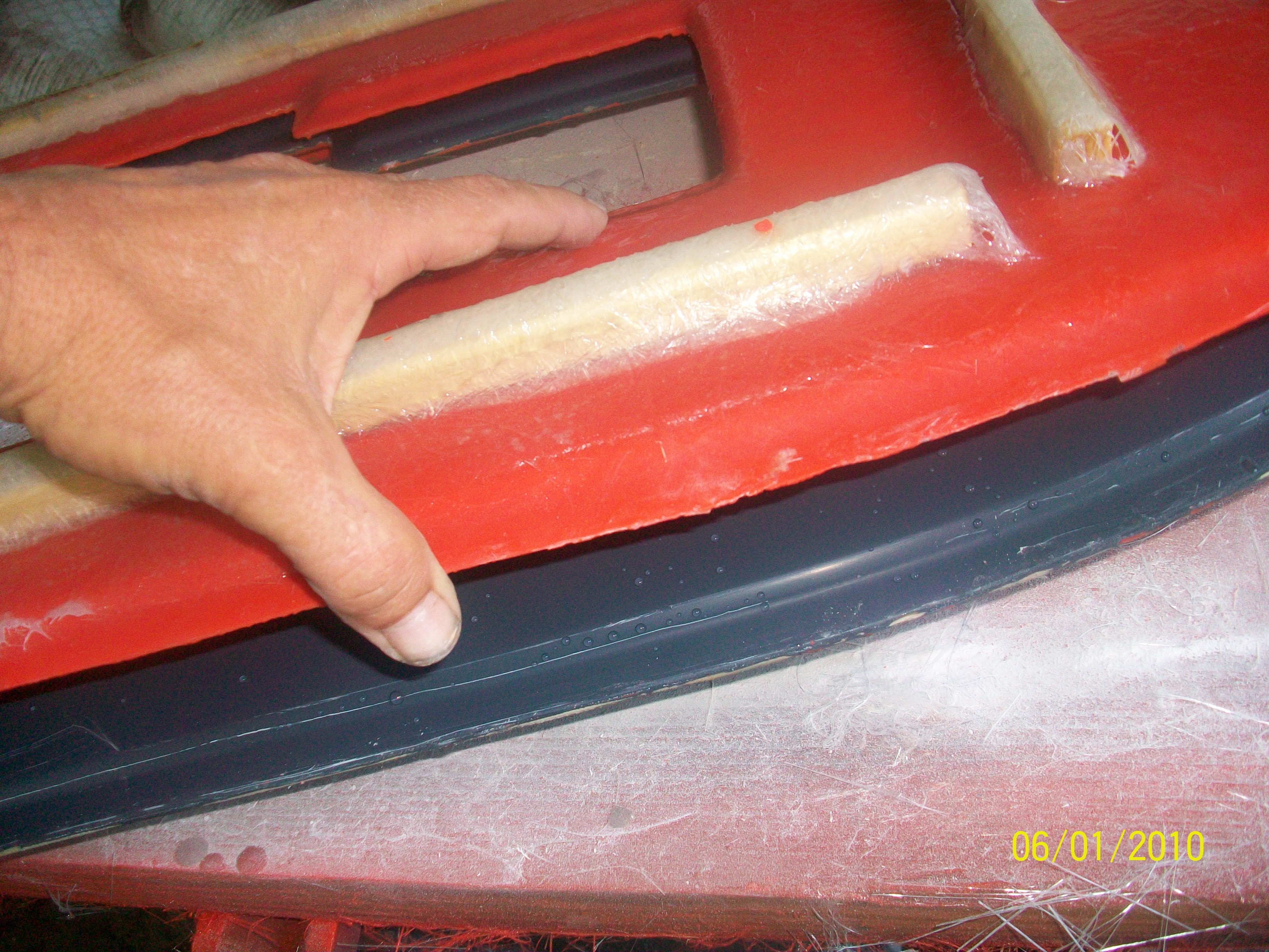

Here is the deck mold coming off the plug with almost no effort...... whew
