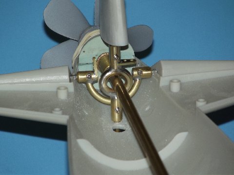

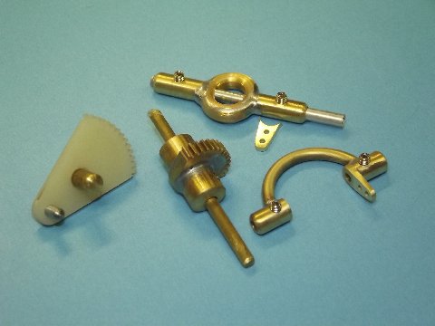

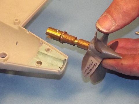

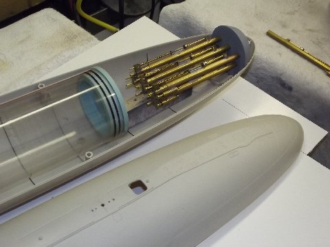

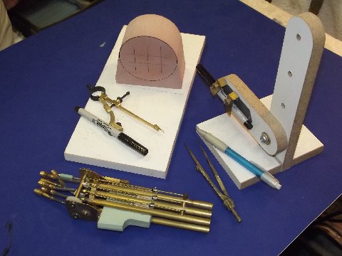

Here you go, folks!
David just released some of his recent work on the fittings kit to whet your appetite.
Enjoy!

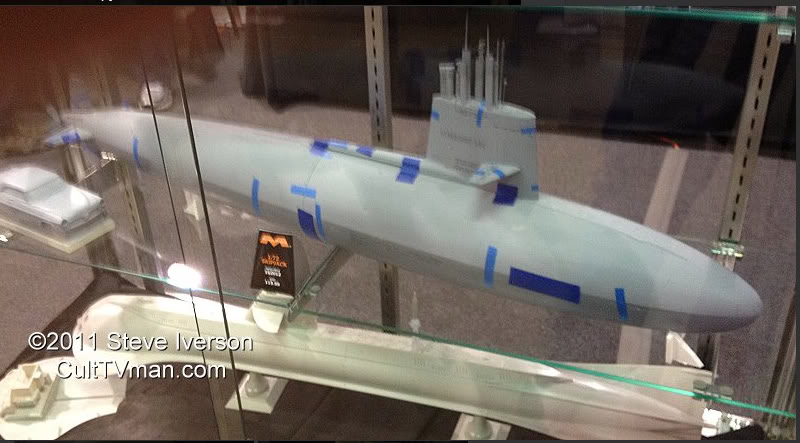

Finally, I got all the fixes I could identify incorporated into the Chinese mock-up. here it's been test-fit together, ready for shipment to Moebius who got it just in time to make the Chicago iHobby show last year for the first public showing of the Moebius Models 1/72 SKIPJACK. It was well received.
After the show, the corrected mock-up was shipped to China for laser scanning, which produced a file suitable for CNC cutting of the production tools. The writing you see on the mock-up are there to identify areas of change just to make sure my changes work would be identified and the re-contoured areas recorded into the software.
Shots of the mock-up, at the IHobby show, can be view here, along with comments:

Pictured is a preliminary drawing to help me resolve the projected shape of the two types of main condenser gratings we needed PE parts for. The picture above was my only document to work from so several attempts were made till the things started to look right on graph paper. I knew the diameter of the gratings thanks to the BuShip General Arrangement drawing, so all I had to do was make the holes and bars across the face of the respective gratings look right. Once happy with the look, I produce a proper piece of art-work, five times the eventual part size, and send it to the Chinese for processing and manufacture of the PE kit parts.
Preparing the oversized artwork representing the SKIPJACK's MSW suction and discharge gratings. These went to China where they were scanned and that file used to produce the masking needed to make production stainless steel PE parts.
I'm old-school when it comes to drafting, no CAD for me you don't get totally involved in the project if you simply push a mouse around a drafting menu. No, dammit! In my world you get your hands dirty; you become intimate with the task; involve yourself physically with the work. That's the only way you can truly capture into you little brain all the nuances of the subject you're attempting to represent.
What the hell are we now, a bunch of mindless, automatons; only able to push buttons and respond to formulated stimuli?! I see no craft in computer aided drawing or machining! What's creative about punching up pre-ordained code? We don't have real Machinist's any more ... just over-paid bit-changers and chip sweepers.
(Picture me running in circles with my hair on fire!)
A quick look at just some of the photos used to help flesh out details as I worked the mock-up and checked the test-shots (yes, there were more than one set test-shots that ran the gauntlet we kept at it till things were as right as we could get them). All from my rather massive SKIPJACK folder. Research and adherence to the things research reveals is everything in this game.
I'm a reasonably skilled draftsman. Apprentice level, but adequate to my needs.

The two halves of the filler formed propeller shaft foundations were marked out. Filed out those channels would form the bore through which two propeller shaft Oilite bearings would fit. Extreme care was taken to insure that the centerline of the two channels ran perfectly in alignment with the hulls longitudinal axis.
To make the reach of the long pushrod between the after end of the Sub-Drive (the watertight cylinder containing the propulsion, ballast, and control sub-systems) motor-bulkhead a simple one, I employed a partial bevel-gear linkage within the sail to translate the axial motion of the pushrod (mounted up against the inside of the upper hull) to the rotary motion, up within the sail, needed to operate the sail plane operating shaft. The masters of the two partial gear elements are seen here. A small cylindrical magnet within the eventual cast resin lower gear element engages a magnet at the forward end of the sail plane pushrod. A similar magnetic coupling at the after end of the pushrod produces a near slop-free linkage between servo and sail planes.

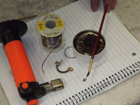

I fabricated the stern plane operating shaft yokes and the rudder operating shaft yokes from brass rod. Here I'm checking the yoke masters as well as an assembled propeller assembly with mock intermediate drive shaft to check for non-interference of the control surfaces through they're full 35-degree travel up/down, left/right. Once all was found to operate properly, the yokes were removed, fillets built up with CA and baking soda, pickled, primed, used to make a disc type metal casting centrifugal tool.
Most of the masters are now in primer gray and ready to produce the production fittings kit tooling.

The function of the two white-metal yokes, that interconnect opposed control surfaces, is to provide clearance of the centrally running intermediate propeller drive shaft.
We're going to test-fit the stern control surfaces and running gear into the lower after quarter of the hull and get comfortable with how the two types of control surface operating shafts make up to the yokes; make up the pushrods to the yokes; and make up the intermediate drive shaft to the propeller shaft coupler. All this to check the components for fit and proper operation and to give you a good look at the assembly in operation (a chance to appreciate my magnificence) something you won't be able to do once the a stern-cone portion of the upper after hull quarter is permanently glued atop the lower after hull quarter.
The rudders are rather straight-forward in that the upper portions of those operating shafts are permanently encapsulated in the cast resin rudders with projecting end of each operating shaft running directly into a rudder yoke bore and made fast with a set-screw. The rudder operating shafts have machined flats, insuring non-slip alignment between the two rudders when made up to the yoke.
The stern plane operating shafts, through necessity, have to be removable from the stern plane pieces themselves. This because the outboard ends of the control surfaces fit within horizontal extensions that project aft and block a straight-in insertion of the stern plane with its operating shaft installed. So, I've made the stern plane operating shaft removable. Making up a stern plane to its yoke goes like this: a stern plan is held behind its horizontal stabilizer by masking tape; the stern plane yoke, with attached pushrod, is suspended within the stern with the aid of either a long hemostat or needle-nosed pliers; The stern plane operating shaft (it's flat oriented to present to the tip of the stern plane set-screw) is pushed through the hole in the center of the horizontal stabilizers outboard bearing, through the bore of the stern plan, and into the bore of the yoke till the outboard end of the operating shaft is flush with the outboard face of the horizontal stabilizer bearing; the operating shaft fully inserted, the stern plane set-screw is tightened (don't over-tighten or you'll strip the resin thread), keeping the shaft from rotating within the stern plane; finally, the inboard end of the operating shaft is secured to the yoke by tightening the yokes set-screw. You want to orient the stern planes cord line perpendicular to the yokes bell-crank arm.
Whew!
Oh ... and for the sake of scale, orient the stern planes with the operating shaft set-screws on the bottom, out of eye-shot.
Employing 1/16" diameter brass rod, make two pushrods, 7" in length, each with a Z-bend at one end. One pushrod makes up to the rudder bell-crank, the other pushrod makes up to the stern plane bell-crank. Later, the forward end of these pushrods will receive a magnetic coupler that will engage a counter-part that makes up to a SD pushrod and servo. Magnets are used to couple the two linkage elements no back-lash, no tools, no sweat. More on that later.

Now, to mark the radial lines around the hull quarters where you will saw them free. Any number of ways to accurately mark off a radial line on a tapered body-of-revolution. But, the easiest method, presented here, is to take advantage of the internal stiffening ribs molded within the hull quarters, using them as both guide, and datum line from which to identify the distance from bow and stern to cut the bow piece and stern piece away. Study the above photo.
Load your compass with a Sharpie pen. Let's start with the forward lower hull quarter: Identify the second radial stiffening frame from the bow, that's our datum line. Set the compass distance between point and pen tip at 3" inches. place the point into the right-angle union between hull and frame. Careful to maintain the line between point and pen tip parallel with the hull quarters longitudinal axis as you move the compass laterally, mark a radial line into the inside of the hull quarter, that inked in line denoting the bow cut line.
Do the same for the after upper hull quarter. That datum frame is the one at the leading edge of the horizontal stabilizers. Set the compass so that the radial line established is 2 1/4" forward of the datum frame.
It's much easier to follow the cut line if it's on the surface of the hull quarter, so now you have to transfer the inner cut line to an outer cut line. Plug in a 100 Watt light bulb, and us it to back-light the interior of the hull quarter so you can see the internal radial inked in line through the translucent plastic. Pencil in cheat marks to the surface of the hull over the line you see through the hull. After enough points are put down to get an accurate indication as to the lines true form, lay down some masking tape, it's edge at the cheat-marks, and ink in a proper cut line to the outside of the hull using the edge of the tape to guide the Sharpie pen point.

The torpedo nest assemblies primary job is to stiffen the bow of the SKIPJACK against handling and collision damage.
Keep in mind that the Moebius Models 1/72 SKIPJACK model kit is principally made of so-called 'high-impact' polystyrene. A plastic that has nowhere the strength and shock resistance of glass reinforced plastic (GRP), today's preferred substrate for model ships and submarines. Hence the inclusion of the torpedo nest assembly, which, only incidentally, can serve as a foundation for a nest of practical torpedo tubes.
The only 'optional' item supplied in the fittings kit is the torpedo tube nest foundation (torpedo tube foundation-H) most of you will toss that part into the trash, but it's included in the kit for you meat-eaters. (Sorry, Norbert ... I read your book, you magnificent so-and-so!).
In the picture above a nest of six 1/72 torpedo tubes, secured within the nest foundation, all sit secure and in proper registration atop the keel piece. The muzzle ends of the tubes project into and are held in alignment by the torpedo muzzle bulkhead. I realize most of you will not opt for the weapons system, this is just some eye-candy for you; a suggestion of what can be done with r/c model submarines today.
The three pieces that make up the nest assembly attached together with the aid of four 2-56 round-head machine screws. A quick and easy means to insure that the torpedo muzzle bulkhead and nest transverse bulkhead fit perpendicular to the nest keel piece is to lay the assembly over some graph-paper and eye-ball it. Block sand the forward or after keel edge to eliminate any cant that produces a fit that is not perpendicular. Once you have the three pieces of the nest assembly straight, hit their joints with thin formula CA adhesive, and spritz on some accelerator.
Within the lower hull will be mounted this three-piece nest assembly. It's primary job is to stiffen the forward hull against impact and torsional forces. The secondary function of the nest assembly is to serve as a foundation for the removable torpedo tube nest, should you elect to make the SKIPJACK model a torpedo shooter.
With a hard sanding block sand the nest assembly contact surfaces with #240, this to provide some tooth, then attach the three pieces together with the provided screws.
Note how the bottom edge of the longitudinally running keel piece indexes with the anchor well and frame that projects up from the bottom of the forward hull piece it insures that you get the nest assembly to sit the correct distance from the front of the boat. The only thing you can screw up is the nest assemblies radial orientation within the hull, and two engraved lines, one either side of muzzle bulkhead will help you to get that right as well.
As you test fit the nest assembly into the lower bow piece you mark off the contact points between within the hull with a pencil or pen. Remove the next assembly and rough up the contact areas with #240 sandpaper. Don't forget to do the same for the upper hull half, where the torpedo muzzle bulkhead will make contact in that section.
If you are going to equip your SKIPJACK with a practical weapon system, now is the time before installing the nest assembly to grind and file open the torpedo shutter doors.
Molded into the sides of the torpedo muzzle bulkhead are engraved longitudinal lines to guide you as you register the nest assembly to the lower hull piece. When lining up the assembly you rotated it until the two engraved lines fall along the edge within the bow piece the attached keel and bulkheads follow as proper radial alignment is achieved. Pressing the assembly down tight into the lower hull, tack-glue it to the hull with staggered dabs of thin formula CA. Release the pressure, then check again for proper alignment, and once happy with things, lay on thick formula CA along all contact points and let it soak in and harden. Don't spritz the still wet adhesive with accelerator you want complete penetration of the adhesive, to get it between all resin and styrene surfaces. Leave the CA to cure naturally.
If you wish to equip your 1/72 SKIPJACK with teeth, I recommend the Caswell-Meriman weapon system. Each weapon system package contains one launcher (which can be configured for either mechanical or pneumatic actuation) and three gas propelled torpedoes/weapons. http://www.sub-driver.com/torpedo-systems.html
The fittings kit supplied nest foundation (torpedo tube foundation-H) is optional and is only used if you opt to include the ability to launch weapons. The nest foundation assembly in addition to its primary job of stiffening the bow is designed to accept and hold in perfect registrations the removable torpedo tube nest.
This picture shows to good advantage how the lower edge of the keep piece indexes the nest assembly longitudinally by engaging the forward frame and raised anchor well. Note that in this shot, the bow portion of the lower hull half has not yet been razor sawed away.
