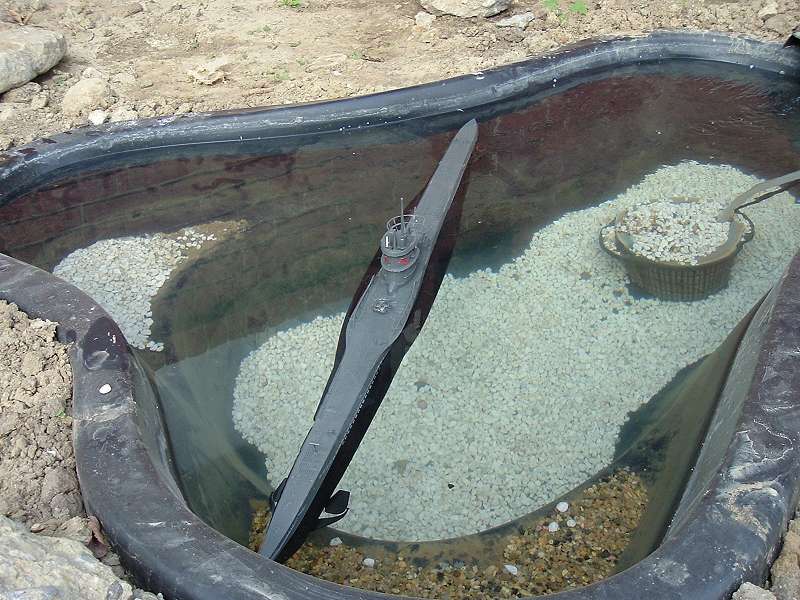

I have a better ideal...and it's simple and don't cost 100 bucks to build..or wait to get from Germany :-)
[img][/img]

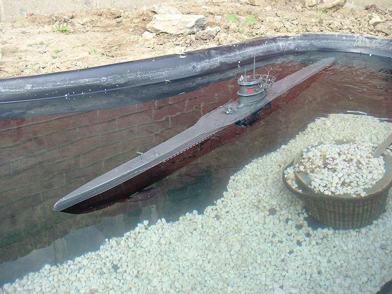

This sub is a complete conversion that I did, everything was built by me. :-)

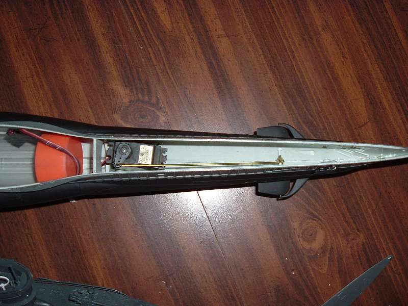

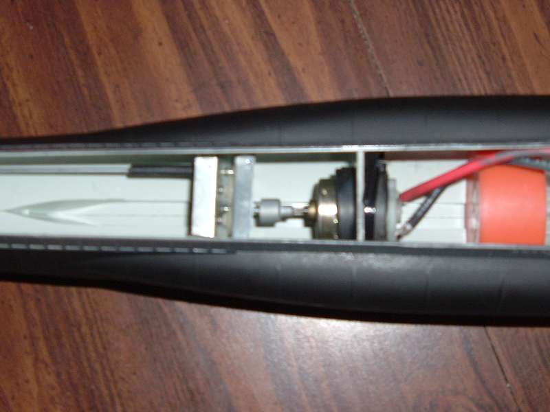

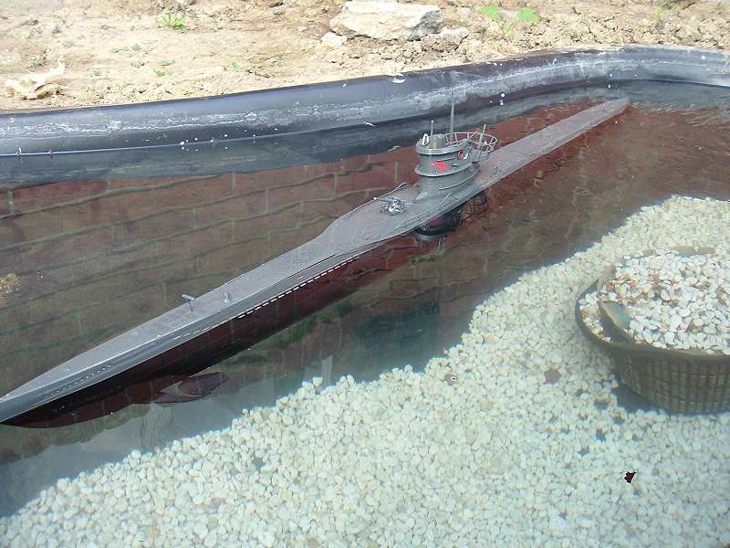

I will find out how easy it will dive this weekend, the rest was fairly easy to do, just find a plastic outlet store and grab some 2.5 O.D. tubing and then cut it about 10 inches
find a gear box that will feed twin shafts and a motor from radio shack, which the motor is in the wet along with the servos..
so far the testing is showing a Uboat that will work so I'm waiting to go to the lake for testing.
Mark

Servos are water proof, you dip them in tool dip up to the gear head and then use a o-ring and silicone grease on the o-ring and then crank the arm down on the servo and you
own a water tight servo. :-)
the motor was broke in inside a cup of water, yes it will work for long peroids of time, check with the Subcomitte website and ask aany of the Oldtimers there.
Mark

Well if you build this sub, take one of the props to the hobby shop and match the shaft size for beginners, drill out the shaft support for the shaft size and then drill the hole
into the hull of the uboat. USE A DRIMEL TOOL! now for the pressure hull, some of you here know how to make one, mine is very crude but it works well for this application.
Now somebody asked about the wet motor, make sure you break the motor in submerged in a cup of water, for some reason this breaks in the motor and so far my motor
has not seized. the Servos are easy to do, buy some tool dip from your local hardware store(Lowes) and dip the servo as far as you can. get o-rings and get the size that your servo gear housing is. smear some silicone grease on the oring aand then put the arm down on the gear.. your servo is now water proof.
My Uboat does have styrofoam inside it to give it some floation , I do not believe the WTC alone will let her float but I'm going to make sure the next version will have all the corrections to construction that the first model had. My biggest change will be the motor setup, I will not use a gearbox and a single motor but use two motors and my steering linkage will be made slightly different.
not much change from there, easy to make but if you try to make it complicated, your going to find out you don't have a lot of room but atleast my front diving planes do
work and should aid in the diving efforts. :-) I will find out soon enough when I go to the pond or large swimming pool.
Mark

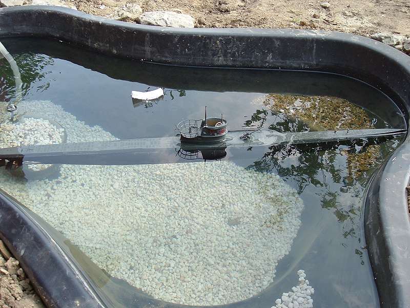

she looks a little tail heavy and low in the water.
But a model that big, she's begging to have a torp tube or 2 mounted in her bow. Torpedoes Los![>:]

She is when that picture was taken, been so busy lately I haven't taken her to the pond yet...
I hope so soon..
Mark

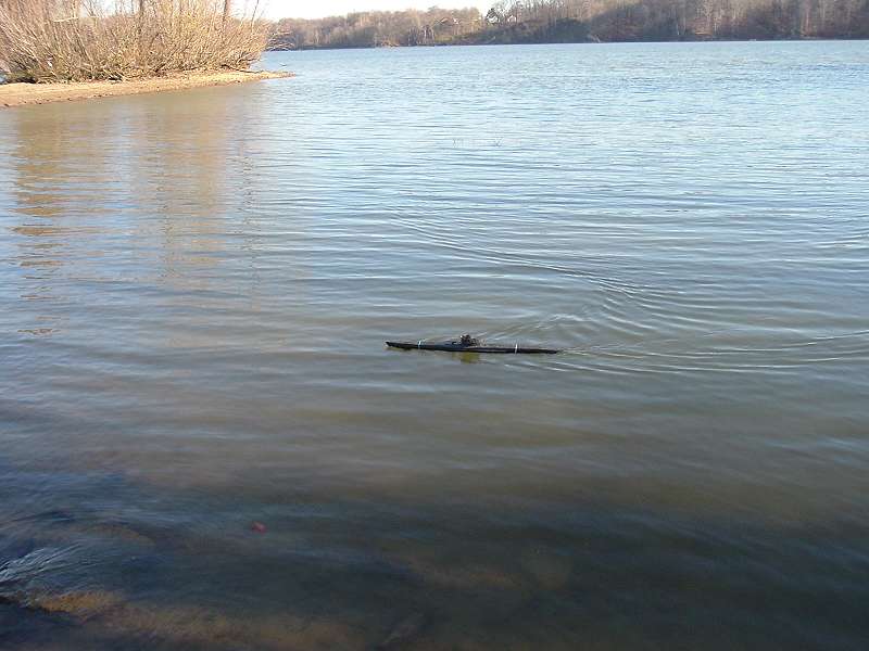

first test done...more today if time permits.
