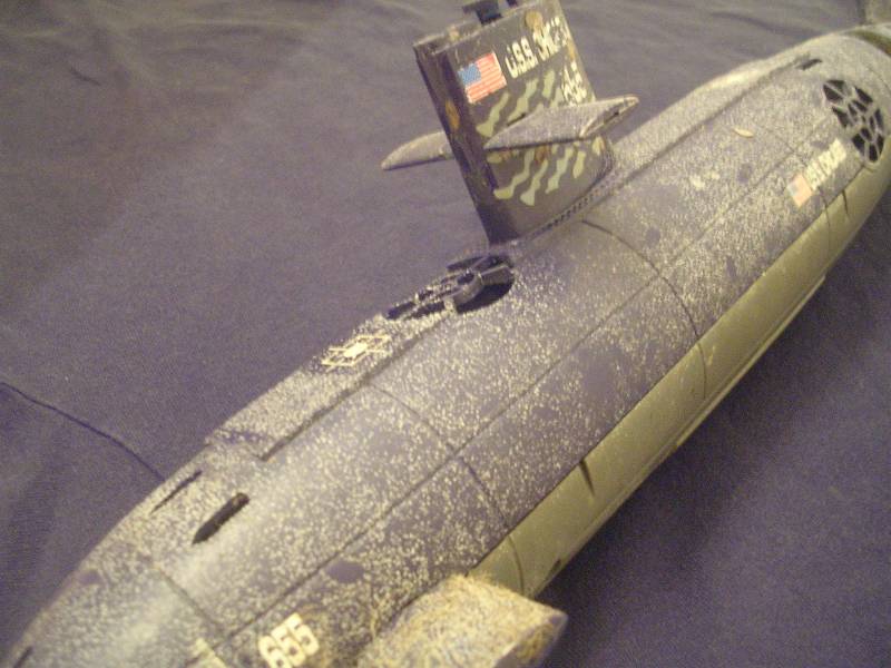

In this photo of a dynamic-type sub, you can see a couple of ports for the thrusters: The one in front of the conning tower is for the up/down thruster; there's another port like that lined up with it on the bottom, so the water flows completely through. The port to the rear of the sub is for the left/right thruster. Also, the sub has a forward/reverse thruster in the tail out of the picture. The control pad has two buttons for each thruster.
You'll notice the sub looks dusty. That's silt from the bottom of a pond: I ran my sub with weak batteries in a pond one day, and a weed may have wrapped around the propeller--and I found the sub two months later when the pond had dried. Sub recovery is simple in pools, where you can always see your sub--but for some of us, there's intrigue in finding a new "ocean" now and then!

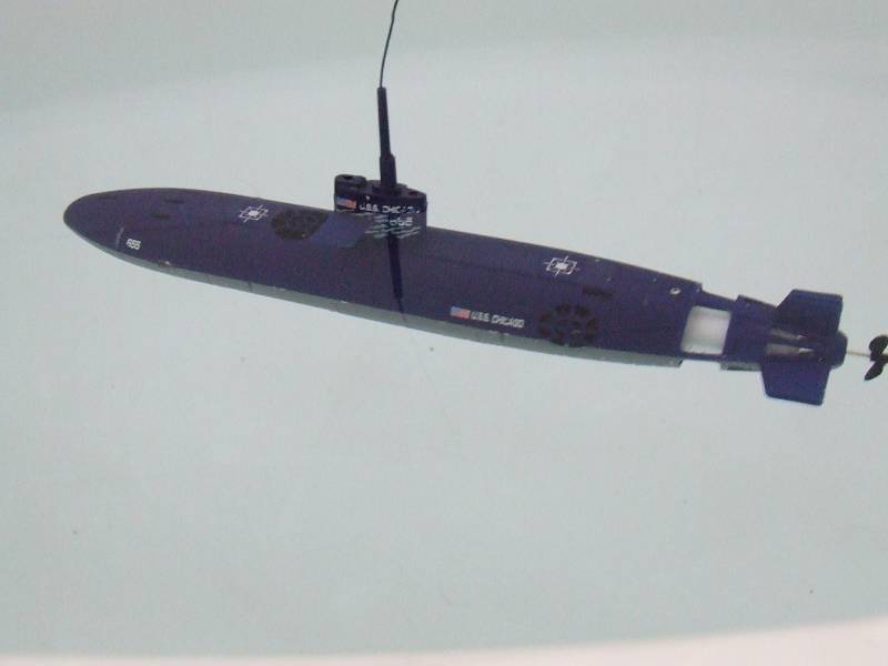

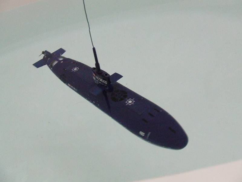

Yes, it's a Chicago. I've had several, and I'd say they're good for $20.
I think most Wal-Marts aren't offering the Chicago/Dallas model right now, though. The current edition is the Seawolf/Conny--same electronics, in a different shell.
If you get one of these, I definitely recommend using silicone or some kind of sealant at the ends of the tubes that connect the wiring: Water is always getting into those tubes, and it can deep-six your sub when you're not expecting it. That's probably what sank this one, and I didn't want to dive into the pond (found it when the pond dried up).
Pros: If you do the prop mod, they've got good speed. Cons: It's a one-foot sub that turns like the Queen Mary.
The pools I've bottomed in are only about four or five feet--not very deep, I know--so I don't really know how deep would be pushing your luck with a Wally sub.
