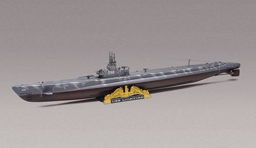

convert this!
RE: convert this!
Man, that's nice...I think I had that kit, but under the name Growler SS-215.
How big is that? Overall length, diameter inside--how big of a cylinder could you fit in it holding electronic parts?

I believe that is a Revell 1/125 USS Lionfish model that they made a couple of years back. Haven't tried converting one though, but fabricating a water-tight compartment out of styrene sheets should be fine. Alternatively, you could also make the sub a dryhull. That is, make every inch of the model waterproof to gain more space.

I'm getting curious about scratchbuilding, at least for a dynamic diver. Do you have a preferred method of mounting motors to the cylinder? Do you generally build more than one cylinder into a model...if not, how do you access stuff that's in the lengthwise middle of a long cylinder ? Are there readymade radio-control kits with just electronics and motors that work well for submarine projects ?

I personally like to dismantle cheap RC cars for my conversions, even though sometimes they tend to break easily...
Also like to install my electronics+motors into separate cylinders, they kinda act like removable modules you can install into other RC-submarine hulls that fit the WTCs. This has an another added bonus in case of flooding as only one compartment could be flooded instead of the whole cylinder.
As for motor mounts, I usually make my own also (why spents $$ on something that you can scratchbuild straight from scrap styrene laying around at home?) as it lets me play around with gear arrangements in order for them to fit inside the cylinder.

I can see how a cheap RC car would come apart so its receiver and main motor would go into a cylinder. But don't you typically get only one motor in a little RC car? What do you look for in an RC car for conversion?
If I were building a dynamic diver, I would think I'd have to dismantle three RC cars so I could get power for three dimensions: forward/reverse, left/right (as a thruster with a prop, or rudder servo), and up/down (again as thruster or plane servo). Then my command module would be three separate transmitters, one from each car, that I'd have to tie together and coordinate. Am I off the mark or what?

The biggest drawback I guess with RC-cars would be the limited functions... This is why I use them mostly to test out conversions of plastic model kits (Trumpeter Kilo, Seawork, maybe a Revell VIIc, etc) without having to purchase expensive micro-sized RC-equipment. A dynamic diver could easily achieved by just using 2 RC-cars (of 2-channel each and different frequencies also) that way you'd have for example:
Car 1 (27mhz)
-Forward/Reverse
-Rudder
Car 2 (49 mhZ)
-Dive planes (I think they are easier to use than thrusters but it's your choice)
-Extra Channel
With the extra channel you can even command a pump for a ballast tank (makes it a static diver in this case)! Or even add functionnal torpedoes!

Hey yeah! Static diver was my first thought when you mentioned an extra channel. Yay! Thanks for your input, Captain.
I guess when you're rigging your own dive planes, you can fix the travel for as steep an angle as you want. How much travel do you like to use, and for what kind of cruising (pool, pond, lake...) Do you spring-load yours so the plane will return to level position when you're not directing it?
