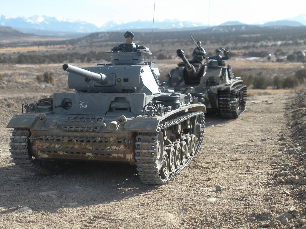

I use "Elmers" carpenters wood filler.It can give a chunky texture, takes paint well and stays on the tank through rough travel.
