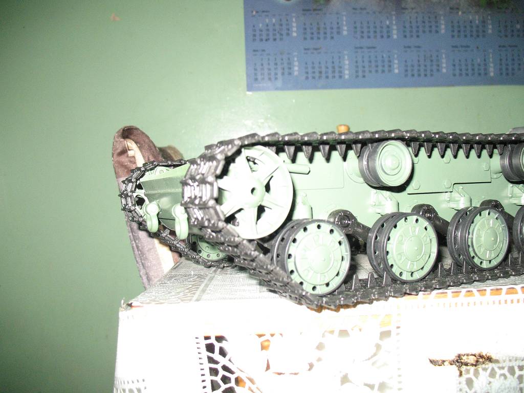

<span lang="en" id="result_box" class="long_text"><span title="">What can I say.
</span><span title="">Exquisite work. </span><span title="">Modern technology. </span><span title="">Hence - the exact authenticity of the model.
</span><span title="">I envy the author of the model and its capabilities in the technology of laser cutting.
</span><span title="">But - history repeats itself - high </span></span><span lang="en" id="result_box" class="long_text"><span title="">technology </span></span><span lang="en" id="result_box" class="long_text"><span title="">-Tigers in 1943 and clumsy technology with our Russian T-34.
</span><span title="">The author writes in the title topic "JS-2 Modell 44.
</span><span title="">I looked through many books and photographs about the history of the appearance of JS-1 and JS-2. </span><span title="">Nevertheless, something I could and miss. </span><span title="">And I do not know exactly - what is the Model 44.
</span><span title="">In its work, the author (as well as I do) use ready-made industrial parts manufactured tanks. </span><span title="">This transmission parts.
</span><span title="">Catches the eye - the first front wheel-roller - this is the first front </span></span><span lang="en" id="result_box" class="long_text"><span title="">wheel-</span></span><span lang="en" id="result_box" class="long_text"><span title="">roller of the KV-1. </span><span title="">I have known for photographs and drawings - ALL </span></span><span lang="en" id="result_box" class="long_text"><span title="">wheel-</span></span><span lang="en" id="result_box" class="long_text"><span title="">roller</span></span><span lang="en" id="result_box" class="long_text"><span title=""> in the JS-2 - are identical. </span><span style="" title="">And if the author would use the same </span></span><span lang="en" id="result_box" class="long_text"><span title="">wheel-</span></span><span lang="en" id="result_box" class="long_text"><span title="">roller</span></span><span lang="en" id="result_box" class="long_text"><span style="" title=""> - it would automatically did the right thing to track tensioning device of the tank. </span><span style="" title="">And in this case it also has the front roller from the KV-1 and track tensioning device of the tank from the KV-1.
</span><span style="" title="">Next - a leading star (</span></span><span lang="en" id="result_box" class="long_text"><span style="" title="">rear sprocket)</span></span><span lang="en" id="result_box" class="long_text"><span style="" title=""> - just from the KV-1 with 16 teeth. JS-1 fnd </span><span style="" title="">JS-2 had a smaller diameter </span></span><span lang="en" id="result_box" class="long_text"><span style="" title="">leading</span></span><span lang="en" id="result_box" class="long_text"><span style="" title=""> star (</span></span><span lang="en" id="result_box" class="long_text"><span style="" title="">rear sprocket) </span></span><span lang="en" id="result_box" class="long_text"><span style="" title="">with 14 teeth.
</span><span style="" title="">A large front wheel and larger rear sprocket will automatically require a greater height baths and other provision of the upper support rollers.
</span><span style="" title="">I thought it all over when he began his tank.
</span><span style="" title="">I do not know what the JS-2 Project 44, but in this model the chassis of the tank - from the KV-1. As I suppouse.
</span><span style="" title="">And it is very interesting, on what technology the author will make a tower of JS-2. </span><span style="" title="">Simple flat pieces of it are not cut.</span></span>
<span lang="en" id="result_box" class="long_text"><span style="" title="">I also might add that the tower of the KV-85, which is sold in KIT KV-1 to KV-85 - not quite identical with the tower JS-2 in some parts.</span></span>
<span lang="en" id="result_box" class="long_text"><span style="" title="">Nevertheless - in body parts - this model is several orders greater than my hack.</span></span>

<span lang="en" class="long_text" id="result_box"><span title="">Well, I also wrote - "think" and not "just know" or "confident."
</span><span title="" style="">But certainly in Moscow, this JS-2 - just only one.</span></span>
