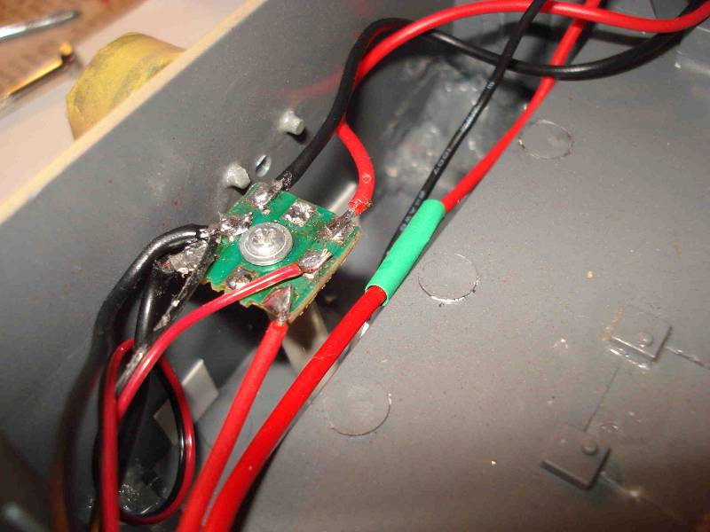

This is my highly sophisticated design and high tech wiring diagram using the stock switch (sarcasm). With no power to the electronics (Off) you can charge the battery.

What's that box with the dots in it? A junction box of some type?
An other question, without a lot of searchning I see there are sliding DPDT switches, so is there a unit that will fit in the same envelope/interfaces as the stock HLon/off switch?
Frank
Old 12-16-2010 | 03:33 PM
swathdiver's Avatar
Joined: Mar 2006
Posts: 5,031
From: Port Saint Lucie, FL
Default RE: Permanent battery assembly
Perry, I probably stole the idea from you!
Frank, it's the little junction block on the smoker or the one under the upper hull.
