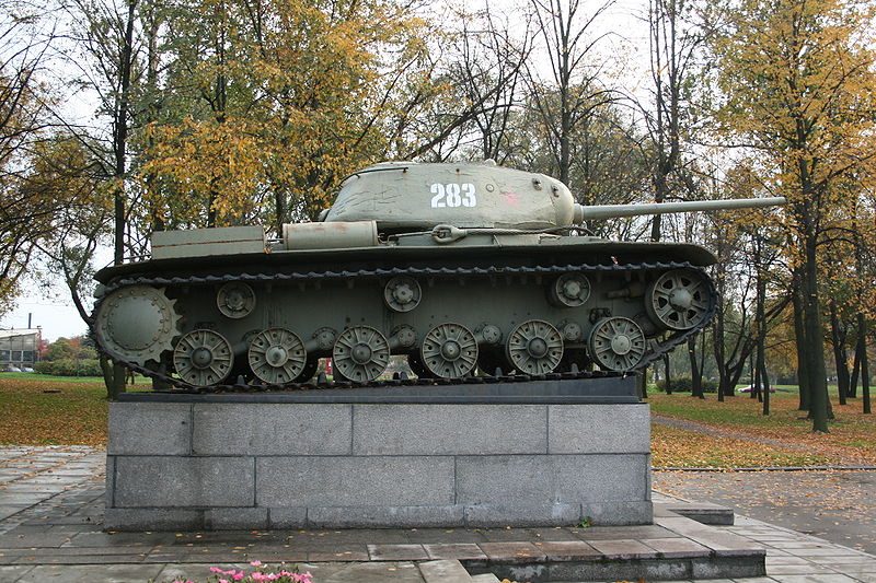

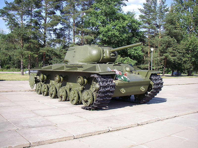

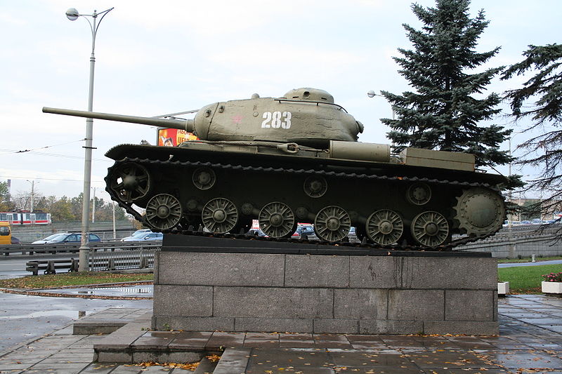

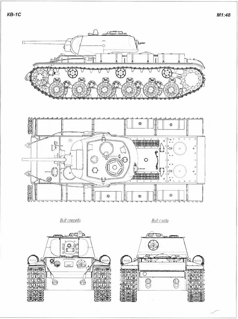

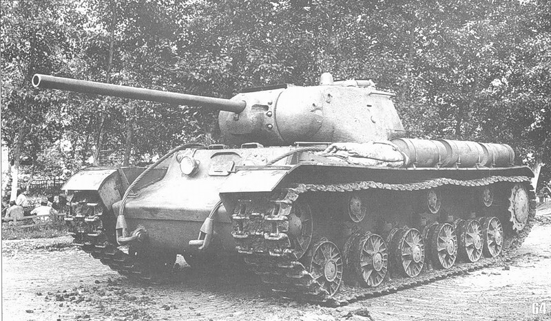

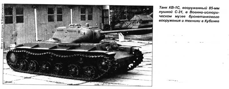

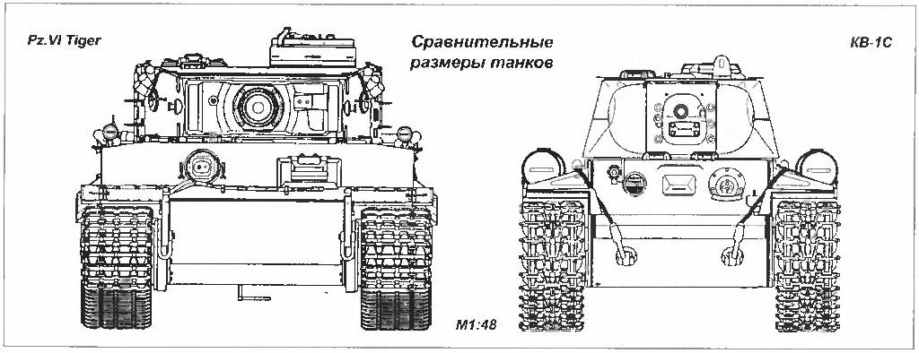

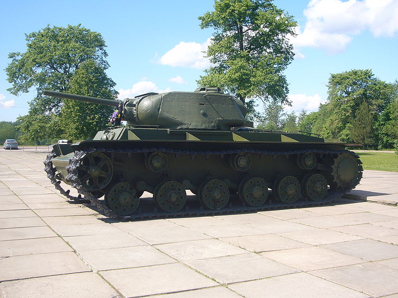

<p class="MsoNormal"><span class="hps"><span lang="EN">Hello</span></span><span lang="EN">
<span class="hps">You're</span> <span class="hps">doing</span> <span class="hps">well.</span> <span class="hps">You</span> <span class="hps">get</span> <span class="hps">a good</span> <span class="hps">tank</span> <span class="hps">KV</span><span class="atn">-</span>1S, but <span class="hps">not</span> <span class="hpsatn">KV-</span>85. <span class="hps">KV</span><span class="atn">-</span>1C <span class="hps">-</span> <span class="hps">fast</span>.
<span class="hps">KV -85 -</span> <span class="hps">diameter of the ring</span> <span class="hps">of larger diameter</span> <span class="hps">towers</span>.
<span class="hps">KV-1S -</span> <span class="hps">diameter of the ring</span> <span class="hps">of the tower</span> <span class="hps">-</span> <span class="hps">as well as</span> <span class="hps">the T</span>-34 <span class="hps">and does not</span> <span class="hps">require</span> <span class="hps">a larger</span> <span class="hps">diameter of the ring</span> <span class="hps">of the tower</span>.
The Last 3 fotos - are KV-85 Tank/
</span></p>
