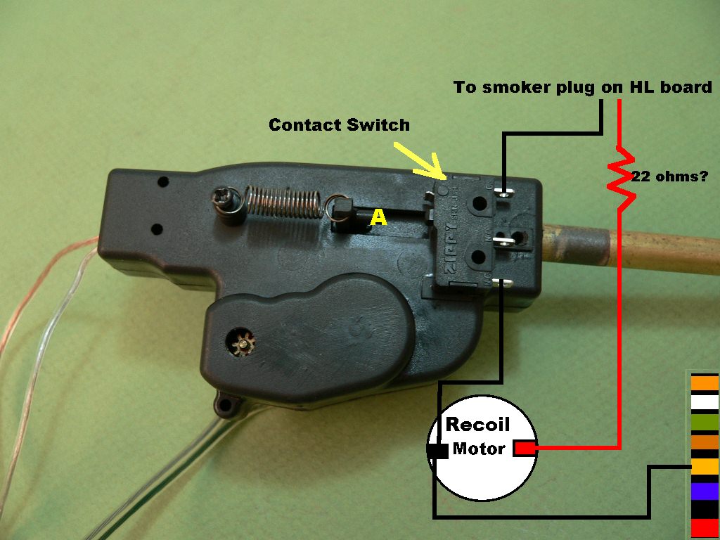

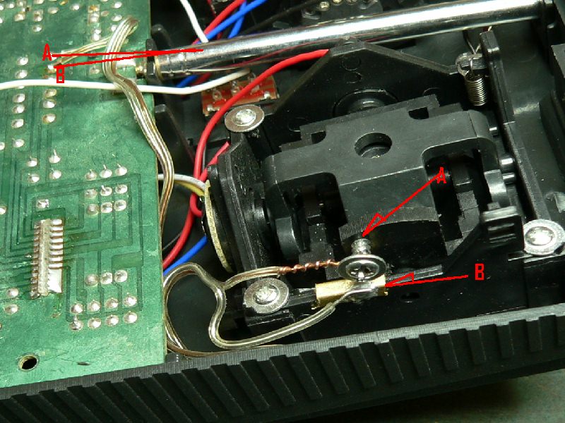

The basics of recoil wiring are the same for any motoriized unit. You have a motor, contact switch, power supply feed, and a trigger wire. Trigger wire, and wire feed through contact switch are negative. I hope this helps

It's been a while since I hooked up mine in the P3, but I believe the three wires hook to the small circuit board with 3 contacts on each side.
The small circuit card is where the stock turret wiring is attached. Additionally there should be a black ground wire on the unit to splice into the power ground. I hope this helps.

Hang On. Here you go. This should help.
This is from the EL-Mod sight
