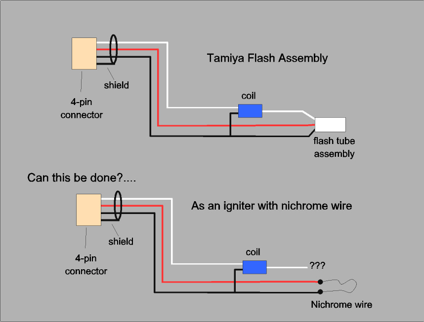

Guess I should have posted this picoriginally. Instead of a flash tube, I would like to ignite the charge in my black powderfiring gun. The igniter is now a separate circuit with a complicatedsystem (servos, channel mixing...) of firing the charge in co-ordination with the recoil and sound.
Not familiar with flash ciruit characteristics. Can the charger circuit cap be replaced with a smaller, lower V capacitor? The present igniter filament takes 7.2VDC nominal and peaks at about 5A.

the red is the 3000+ black 3000- white wire is the shunt the shunt is whatcauses the voltage to jump across the red andblack leads the shunt is neg when it fires some of the voltage goes back through the shunt and rearmsor starts the recharge for the next firing of the flash yopu can not conect the red and black togetter as it will short the system and the white dose nothing till trigered the is very little current avalable for what you want unless you fire the gun powder with the 3000 volt jump

hmmmm.... 3kV and potential for residual charge - not a good approach to fire BP.
Thanks for the help - much appreciated.
