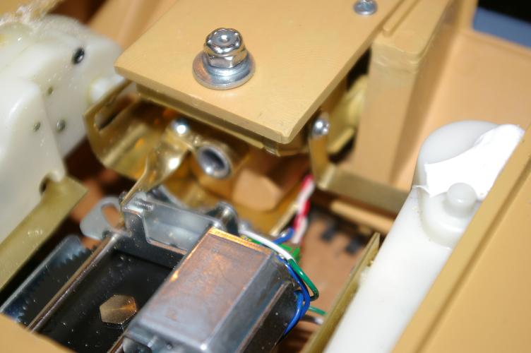

Kclank
Here are some pics of my stugIV which is in progress. It's the asiatam kit with Hen long elevation units used for traverse and elevation. Traverse was turned side ways. The metalwork is a little crude but works. The recoil is Tamiya Tiger I but if I did it again I would use the Panther unit, it's smaller. With the Asiatam gun mount there's only about 10 degrees of traverse which is close to the prototype's 12 if I remember correctly.
Mike EOT

Let me know how the up-side down recoil works for you? I had JP that had issues with the recoil unit being flipped over. The gears wouldn't stay engaged wit the main gear. I had to shim out the main gear to keep it in contact with the drive motor gears. YMMV??? If your Stugs fight as good as mine have for me, I'm sure you will be pleased in the end.
