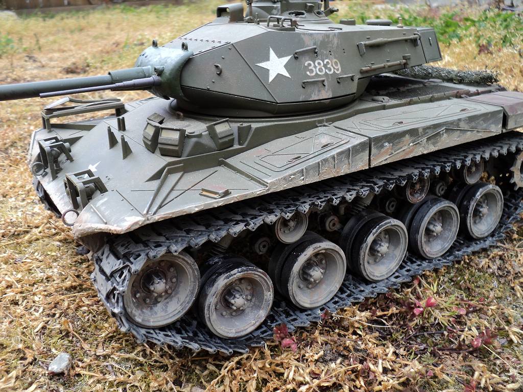

Here's the Bulldog playing in the mud

Hey Mergen...lookin' good. Could actually go up higher on the front plate. You going to do any mods to the details? The driver's scopes are still looking at birds..pull them out straight up, file the backs and put them in looking straight. The pioneer rack is too high...cut the legs about in half. Rust All on the muffler shields. Mud looks good....your crew will love cleaning it off at the wash rack. The inner headlamp in front of the driver is IR...,paint it a dark wine.

Gotcha! PC, just started, I knew if I put this out there you would give me the way to go, I drove this thing one time from the train ramp to the Maint. yard. To bad Patton dident have these, could have run those Tigers crazy. I think we sent a lot of them to Isreal in the late 60's and made Dusters out of the rest.

Isreal never had M-41s. The one at Latrun was a test vehicle. IDF rejected the M-41 due to range of gun and poor operating range.
What in h-ll have you got sticking out the coax port[X(] Is this replicating a Pz II? Only one cal 50 for the TC and definately not for the coax. The spare cal 50 barrel is strapped to the left rear of the turret.
The M-42 Duster replaced the M-19 copperhead..twin 40s on the M-24 chassis. Not made from 41s. Same changeover as the
M-24 to M-41.

HA!HA!HA!, I told my wife I'm going to stick this here and watch PC's comment. Its not staying LOL, I know they used the m41 for dusters Ive seen them, we had a unit out of new mexico NG who had them, maybe they were the only one's but I did see them.
