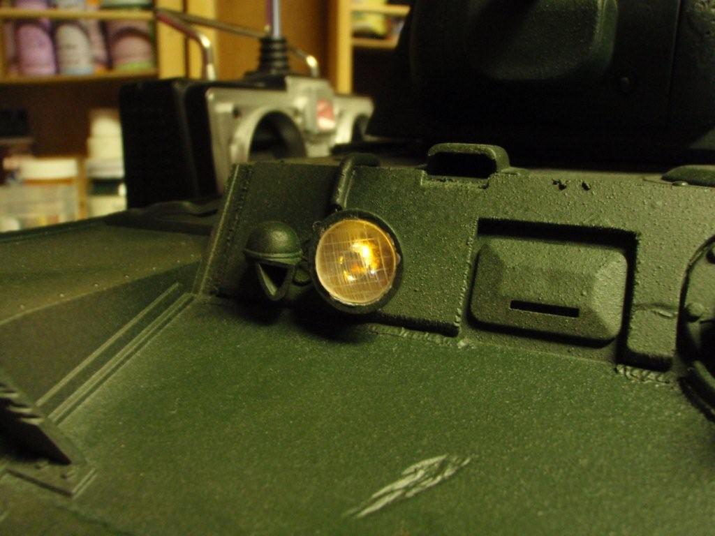

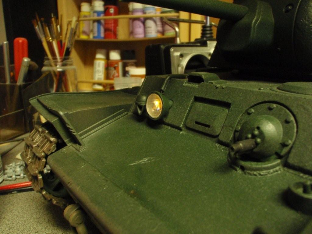

On my HL KV-1, I removed the LED, hollowed out the headlight housing, ground off the tip of the LED and reinstalled it in the housing. There was now clearance to fit a headlight lens over it. Before doing that I gave the LED and inner headlight a coat of yellow acrylic followed by coats of silver acrylic until it was the muted yellowy-off white I wanted. Looks better than the hideous glowing nipple of the original HL design. Sorry no pics, image loader seems kaput on this board...

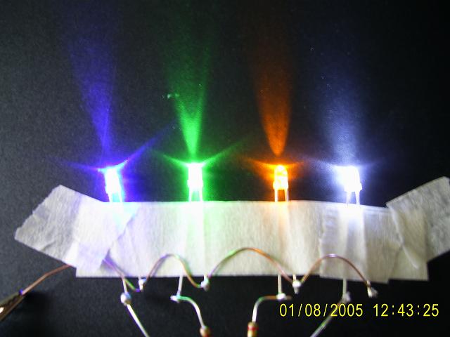

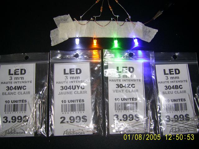

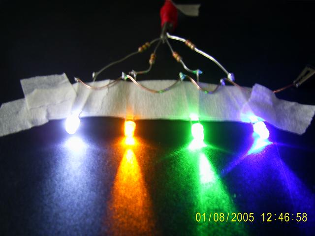

Hi guys !!! I bought some 3 mm high intensity leds a while ago for my smoking gun project ...Here's a couple of pics. to compare the shades...( I'm using a 240 Ohms 1/4 Watts resistors ) ...
Here's the link for the data sheet for the leds ...<a target="_blank" href="http://pdf1.alldatasheet.com/datasheet-pdf/view/282990/BETLUX/BL-L304UYC.html">pdf1.alldatasheet.com/datasheet-pdf/view/282990/BETLUX/BL-L304UYC.html

I use "yellowglo white" leds. Simulates incandescent bulbs. Not too white not too yellow, looks like old headlights.
Old 07-20-2011 | 09:34 AM
Joined: Sep 2009
Posts: 520
From: Elliot Lake ON, CANADA
Default RE: Simulated lamps on models
Anybody knows if " Yellowglo White " and " Warm White " are 2 different colors ; or are they 2 different names for the same color ?????

The warm white leds look pretty good to me according to those pictures ....www.google.ca/search

Modified headlight on my KV-1 with yellow and silver acrylics for dulling. Excuse the silver on the headlight bezeltank is still undergoing final paint and weathering.
