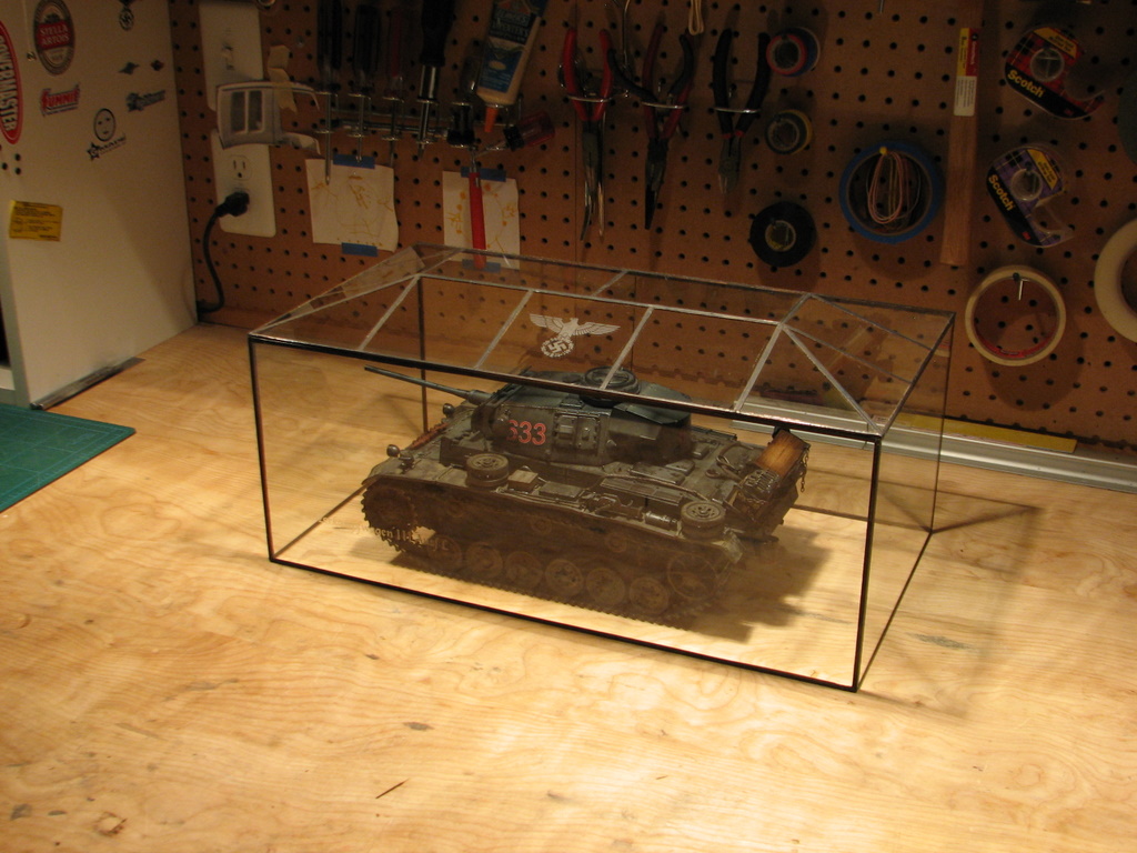

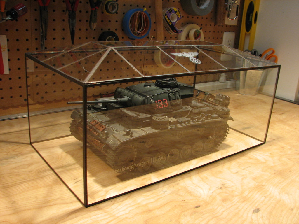

Rex, thanks so much. That's pretty much what is listed at Banana Hobby and MatoMart, but Hobby King, RC-Fever, and Amazon were all saying it was 21 inches long, so I was confused. They probably meant the length of the box or something. Anyway, now I know exactly I can proceed with the stand.

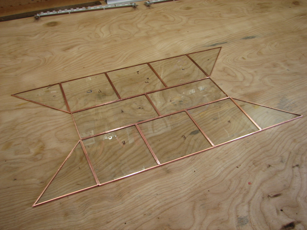

I attached a few photos of the glass "case" I built for my PZIII. I just need to make the wooden base for it. This has turned out to be surprisingly hard, probably because I am not really a wood-worker. They don't really sell a plank of wood that is as wide as I need for this tank - and it will be even worse for the KV-1. Instead I have decided to make the base out of MDF, and then face the edges with a nicer wood trim, like oak or something. Right now it looks kind of silly having the glass top but nothing for the bottom.
It took quite a while to make the glass box, but it wasn't very expensive. Now I know the dimensions I need to accommodate, I could go ahead and start on the case for the KV-1, and build a wooden base for it too, before I do the tank.
Airbrushler, thanks for telling me about that thread. I've thought it would be great to put in some cobblestone or something, at the least. I may still try.
There could probably be an entire thread on how to display our models...

wow i like that casehow did you do the logo and lettering do you have a vinyl cutting plotter

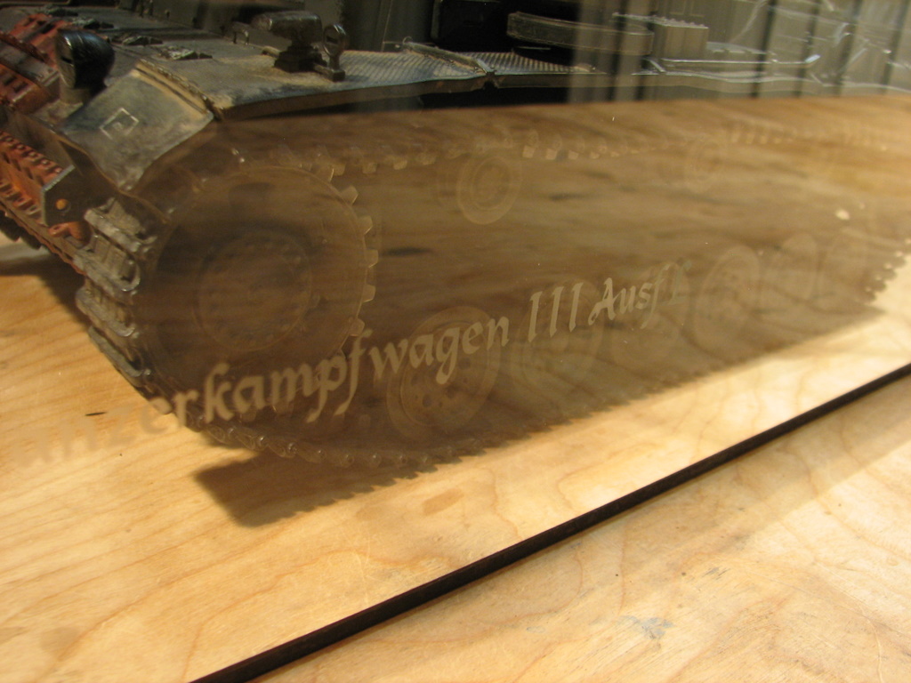

The etching was very simple, as I found out. This was the first time I've done any work with glass so it was all new to me.
I don't have a vinyl cutter but I just sent the design to Callie at [link=http://www.callie-graphics.com/]CallieGraphics.com[/link]. I ordered three copies so I could practice on some scrap glass, and it cost me $20 bucks shipped. She's very good for doing any kind of vinyl work. I just had to ask for them as a mask.
The eagle design is a vector I found online and just resized to my needs. The text was also from a font I found online, called "Heidelbe."
For the etching I just used [link=http://www.amazon.com/Armour-bottle-RECOMMENDED-CLEANING-GLASSES/dp/B0001DTWYG]Armour Etch cream[/link] and followed the instructions on the bottle. A bottle costs less than 10 bucks and will last a very long time. You can also find it sometimes locally at Michael's.
The results were surprisingly professional, I did not expect it to turn out so well. It does help to practice on a scrap piece of glass (if you build a case you will have plenty of scrap, I can attest). You learn that cleaning the glass really well first, rubbing the mask down real hard before applying the cream, and applying the cream in a uniform thickness is the key to a consistent result.
It's hard to take a good photo of the wording along the bottom, but in real life it looks quite nice.

The glass case looks great, awsome job!

This is the first time I have ever seen a glass case that impressed me as much as what was in it! Wow !!!!!!!!!!!!!!!!! [X(]
I think the way you did the top framework is great, and the etching is eye candy.

I agree 100% with Rex. I think a build thread is in order here. It would be great if you could do a thread on the case you plan on building for your KV-1. Case looks great as does the PZ III ( one of my favorites )
