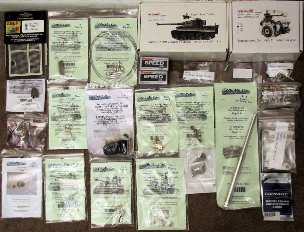

Next all the upgrades I was planning on using at the beginning, some I used, some I changed, more on that later on. Most parts were purchased from Bob at ETO Armor thanks Bob & Joe for all your help and shipping stuff so quick.
Here is the list of upgrades:
Aber engine and radiator screens
Schumo late model air intake
Schumo tow cable set
Graupner speed 400s
Impact late tracks
Impact gearboxes with drop down gears, #2 Hop-Up gears and 12 tooth pinions
Daryl's Steel Idler Arms
Daryl's IR LED tube
Daryl's Breech attachment
Schumo Metal Commander's Hatch parts
Schumo Driver and Radio Operator's Metal Hatch Hinges
Schumo Metal Headlight Set
Schumo Aluminum Gun Barrel
Daryl's Idler upgrade
Hull and Turret Machine Guns both with LEDs
Schumo POM Idler Bushing
Schumo Hex Screw Set
Schumo Metal Tow Shackle Set
Schumo Turret Mounted Spare Track Holders
Turnigy Inertia Control Chip
Upgraded torsion bars
Metal late sprocket guides
All the parts weighed about 10 pounds so this one will be as heavy as my Panther (13.5 pounds), maybe more, you'll see why.

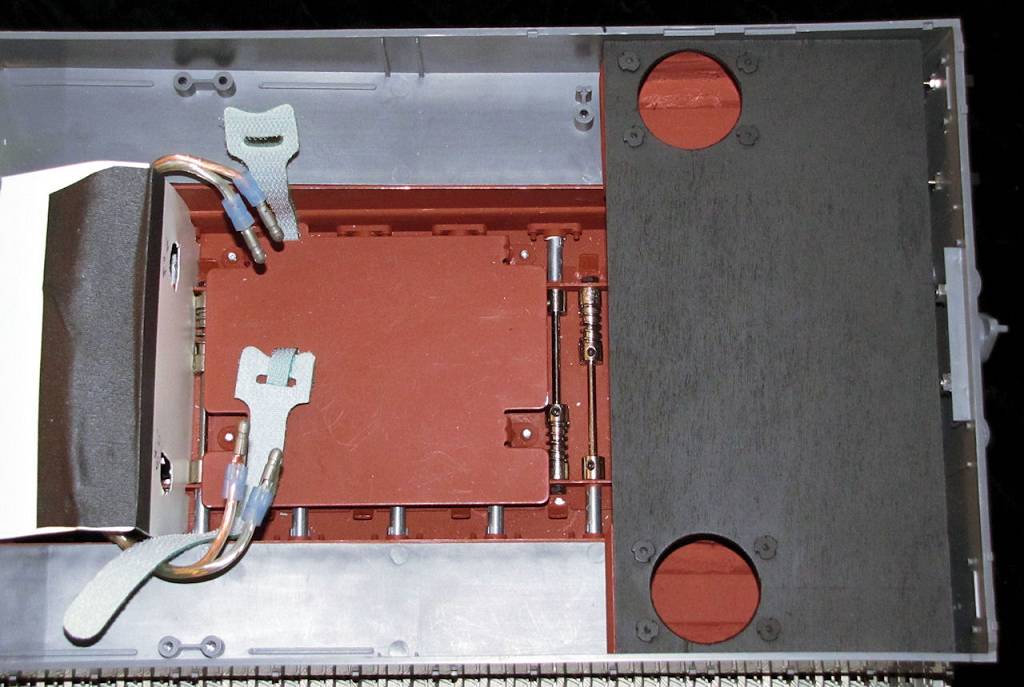

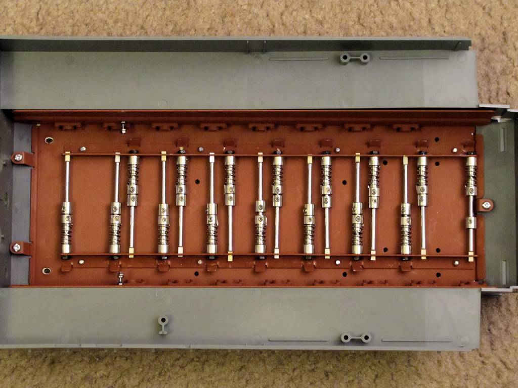

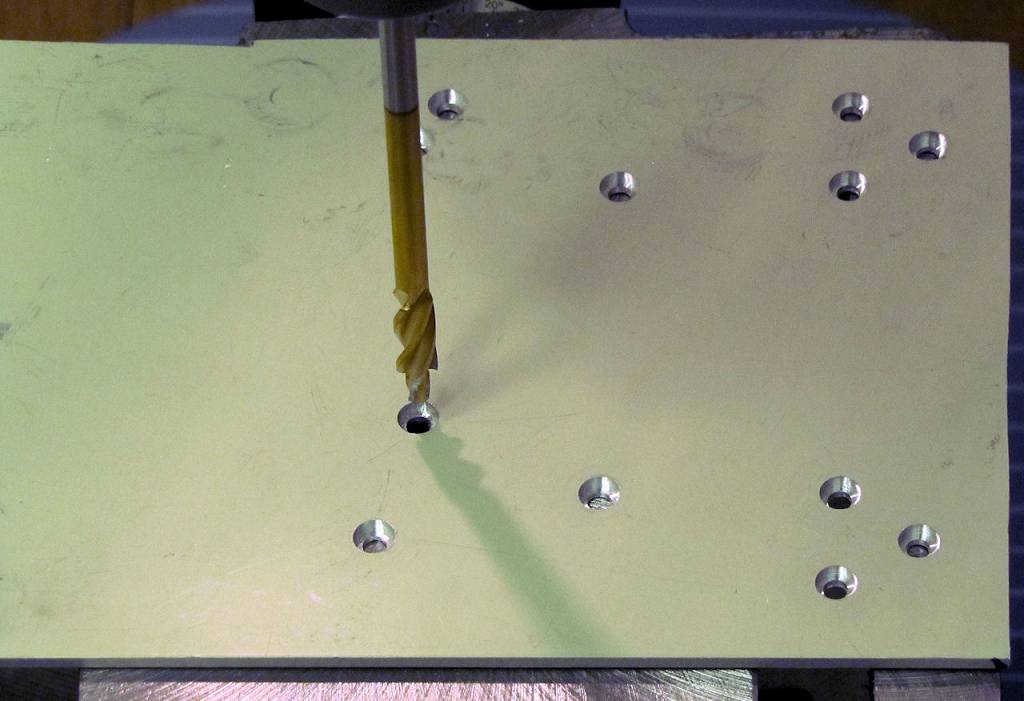

My first step was to reinforce to floor pan of the Tiger against flexing the same way I had done with my Panther, with the gear reduction I thought it better to be safe than sorry. Luckily I have access to some 3mm thick aluminum plate. I cut it down to basically fit the bottom of the hull including covering the plastic part of the hull. I could have opted to just mounting a smaller plate below the gear boxes but I like the weight it gives to the tank (keeps it from bouncing aroundunrealistically) and it would not be completely flat on the bottom with just a partial plate. Of course 3mm is a little thick, so my plan was to countersink the screw heads.
Originally I had intended to use the hex head screws I got from ETO but in order to countersink hex head screws the area around them has to be much larger to fit a socket on them. This fact wasgoing to cause problems where some of the holes in the hull were close together.

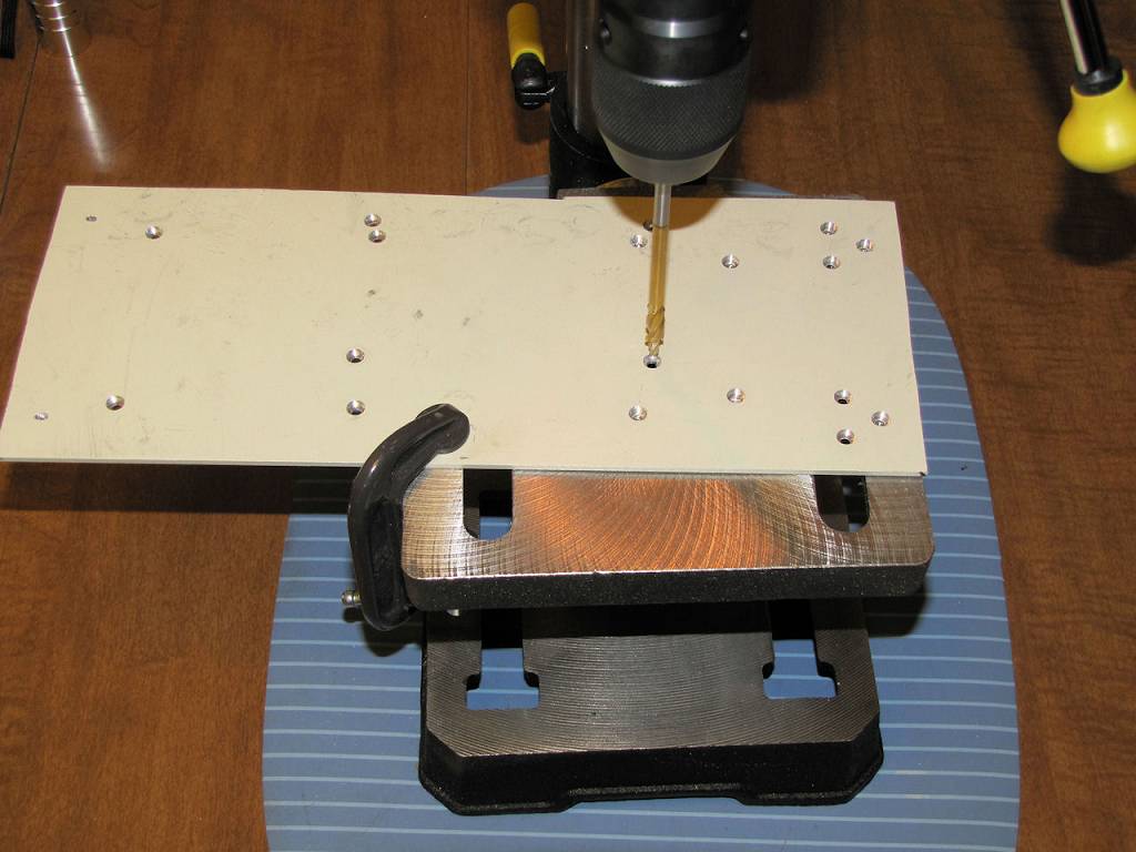

I marked my aluminum plate to match the holes in the bottom of the hull by making a paper template of the hole pattern, then I transferred it to the aluminum and drilled the holes with a 3mm drill bit. Afterwards I checked it against the hull bottom to verify the pattern, I had a couple of holes that were a little off, less than half a millimeter so I marked them where they were out of alignment and filed them to correct their locations.
I had purchased a counter bore bit, (creates a flat bottomed recess), sized to work with the Tamiya supplied Phillips head screws and set my drill press to drill 2.25 mm deep into the aluminum this would allow the screw head to be completely below the surface of the aluminum plate.

My next step was to make accommodations for Daryl's Idler adjuster since one method of installing it, (the one I had chosen), requires that holes be drilled into the aluminum hull I did that step before mating the aluminum hull with theplastic outer shell, since I didn't want to drill through the plastic hull later. I hadn't decide to use his system at thispoint but I wanted to have the bolts for the springs in place if I changed my mind later.
Next I installed aluminum hull into the plastic hull and attached the aluminum plate I had counter bored to the bottom of thehull and mounted the torsion bar rails, which were modified for the upgraded torsion bars I had purchased. If you are notfamiliar with these, they are totally adjustable and are somewhat softer than the Tamiya stock torsion bars. More on these later.

Several steps were done next I installed the metal suspension arms, originally I replaced all the Tamiya torsion bars with the upgraded spring loaded type, however after testing out the tank later with all the weight on them I found them somewhatsoft so I put the Tamiya bars back into the first four front and the two rearward most locations, as these are the ones thatneed to be stiffer. From my reading the Germans actually used beefier torsion bars at the front of the real Tiger tank too.Then I installed the POM bushings for the idler arms and then Daryl's Steel Idler arms along with the stock Tamiya idleradjusters. Then the gearboxes were installed and lastly the metal towing shackles on the front.
Next it was time to tackle the wheel bearing installation. It was necessary to modify all the locations where the factorybushings are normally installed by enlarging the openings to 7mm I decided to do this by hand rather than use my drill pressas I wanted to have more control over the process. I cut a piece of brass tubing to close to the length I wanted, and slid itover the drill bit to keep the bit from going any deeper than necessary. This was an important step as the drill bit wantsto keep going deeper, because it gets a very good bite into the soft plastic. After all the drilling was done I installed allthe wheel bearings.

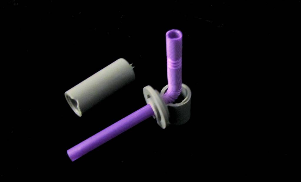

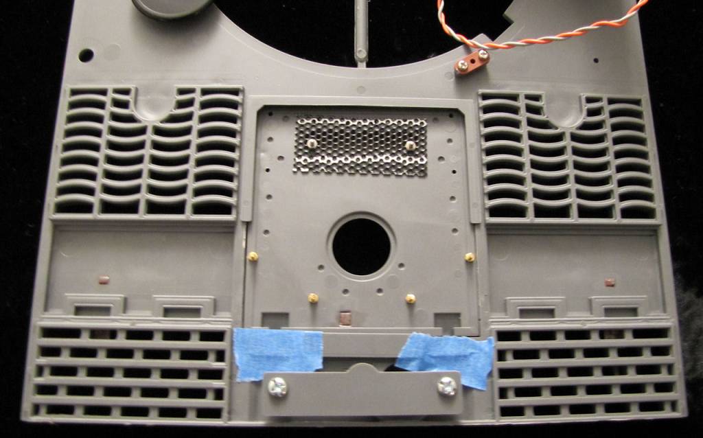

I decided I wanted to try to install a smoke generator in the tank and make it operate in prototypical fashion rather thancut additional holes in the back plate of the hull higher up as others had done and the way HL does it on their Tiger 1. Iwas using a smoke generator from RC Command, I had tested some of the Heng Long units and was unimpressed by the pump actionof the two I tested, neither pump would start reliably by itself every time. RC Command's smoke generator uses a largerdiameter pipe than the HL generator so I tried reducing the pipe down to a soda straw diameter which would easily fit throughthe actual exhaust connections that Tamiya provides.
I wanted to mount the generator as close to the rear of the tank as I could, I knew would get better results if I hadless restriction for the longest part of the run of pipe. Following the lead of some others on the forum, I modified theTamiya speaker box and routed some pipes through it.
I was able to make it work but I ran into several problems. The first was the Tamiya speaker box was configured so thatthe speaker mount was in the way of where I needed to route my plumbing, so I remedied that by going through at an angle.
The next problem to surface was the close proximity of the speaker box to the rear of the hull so the pipe size reductionand ease of removal were factors. The next problem which broke the camel's back so to speak was that being the smokegenerated was fan driven vaporized water and glycerine and the long plumbing run, the vapor was condensing inside thereduction pipe (flex soda straw) and after a short while the liquid would block the flow and stop the vapor from beingexpelled.

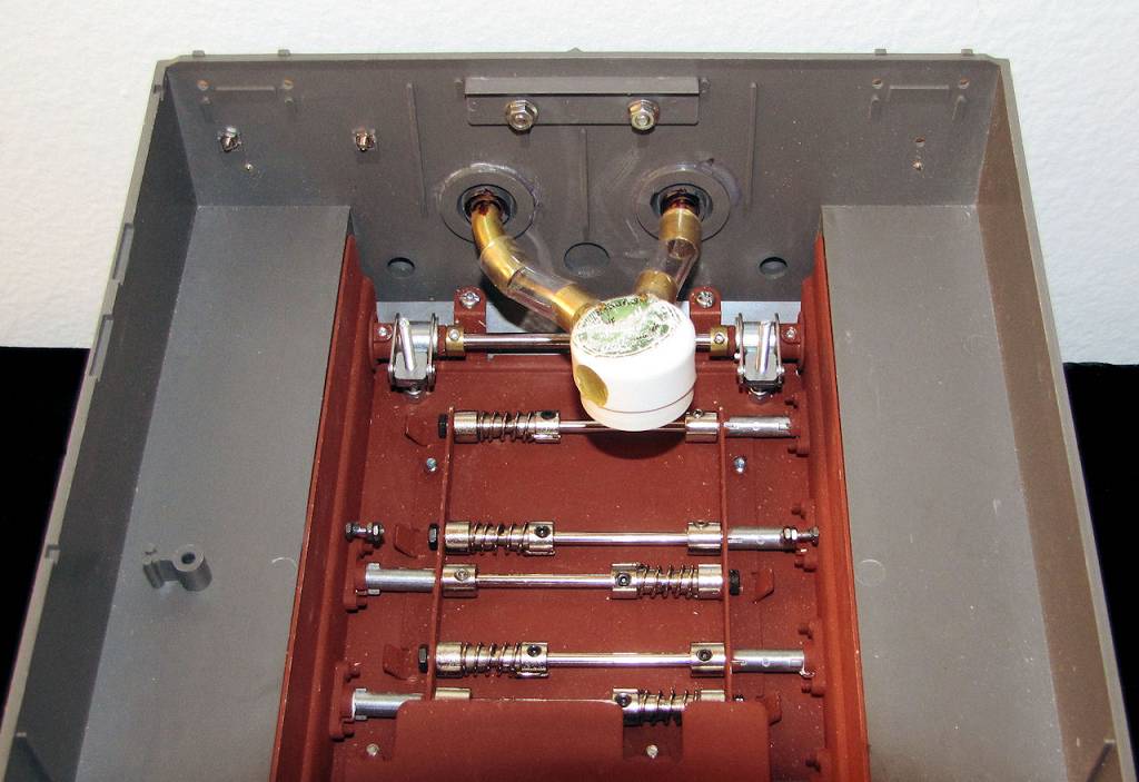

At this point I was ready to give up on the whole idea, but not to be bested by mere machinery, I thought of a solutionto my problem, I would bring the smoke generator closer to the rear of the tank with less chance for condensation to occur.My dilemma was the speaker. where or how to mount it and get it out of the way. In my previous life I was in the car audiobusiness doing engineering and supervising installations and training. After examining Tamiya's speaker enclosure and speakerI found they were nothing special, the speaker has a paper suspension edge and the enclosure itself for it's size is nothingmore than an open box. For most applications the best configuration for speaker enclosures are sealed or ported, the Tiger 1's enclosure is neither. The speaker sounds almost exactly the same if you mount it to a baffle plate and set it inside the tank with no enclosure. Not wanting to use the existing speaker due to it's size, I set about designing a new speaker enclosure for some Dellminiature speakers I already had in my possession.

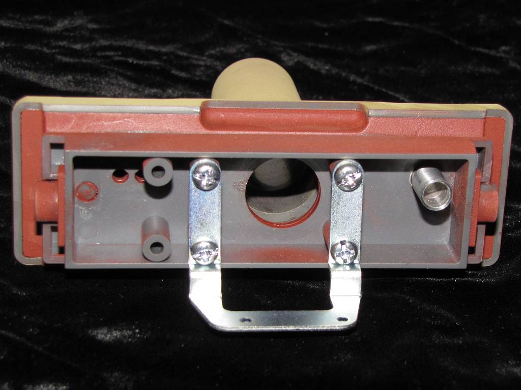

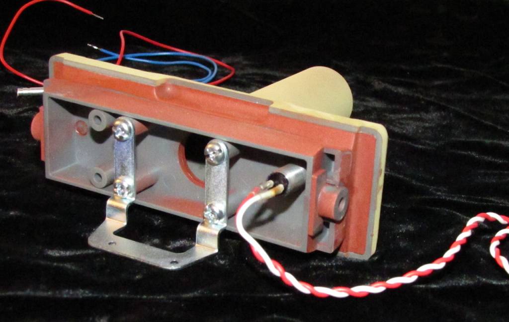

The first thing was strip the Dell speakers out of their original housing, which was ported by the way. I made note as to the length and diameter of the port. The speakers are about 1 1/4" diameter with a soft rolled edge. The next step was to obtain some model grade plywood to use as my speaker baffle and cut the openings for the speakers in it.The speaker location was important as I wanted the speakers only over the panniers on each side. Also I wanted the speakersunder the openings in the hull top.
I mounted the speakers to the baffle and built the boxes for the speakers to fit the panniers height was another restrictionas the panniers are deeper in the rear than in the front and it all needed to be low enough to still allow the upper hullplate to mount. I added some sound deadening material inside the speaker boxes to reduce the high frequencies bouncing aroundinside. I attached the boxes to the baffle plate with hot melt glue to seal them up and to allow disassembly later on ifnecessary.
I modified my original setup by enlarging the holes into the exhausts and used brass tubing, I also modified the outlet onthe smoker so that both outlets pointed generally in the same direction.

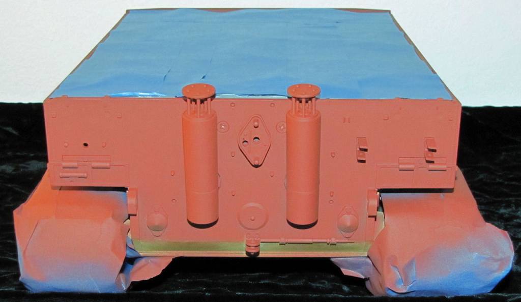

Next I painted the upper hull sides Glacis and rear plate I waited to do this as I didn't want the water/glycerine mix to spoil the finish while I was testing the smoker.
I had previously added the secondary starter crank hole for the engine upgrade the Germans made during the war.

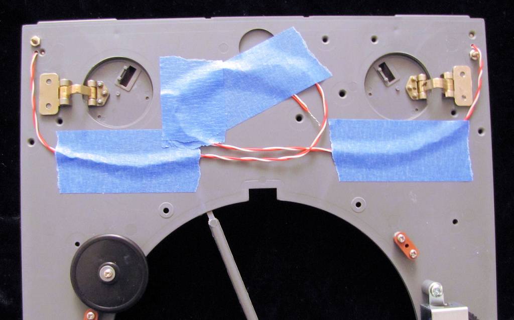

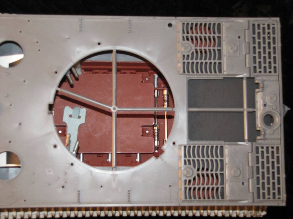

I re-installed the Tamiya electronics into the hull I had actually done this earlier for testing purposes. Back to adding the upgrades, I added the Driver and Radio Operators metal hatch hinges as well as the metal headlightupgrade, I'll eventually add the simulated wiring conduit at some point. I wired the headlights with LEDs, they are prettybright compared to 1940s era headlights but my 1:1 eyeballs still can't use them to drive it at night, my back story is theGermans upgraded to halogen lights (another of Hitler's secret weapons). :-)
The armored air intake came next, pretty straight forward I used mesh underneath to keep out debris and the occasional handgrenade, Filled the Feifel hose bracket holes with bolts. Also added metal handles on the engine hatch.
I added the mesh over the radiator air intakes and outlets. The switch inside the engine hatch is for the smoke generator.

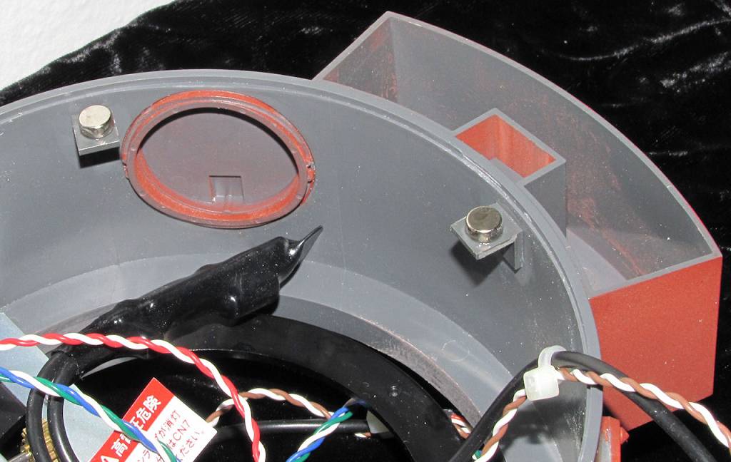

I installed three magnets to hold down the turret roof I may do the same for the stowage bin on the back, I figure I canthrow the parts that fall off during battles in there. ;-)
I didn't like the idea of mounting the power switch up in the turret so I made a bracket and mounted it to the pannier underthe radio operator's hatch, I hope he doesn't mind.

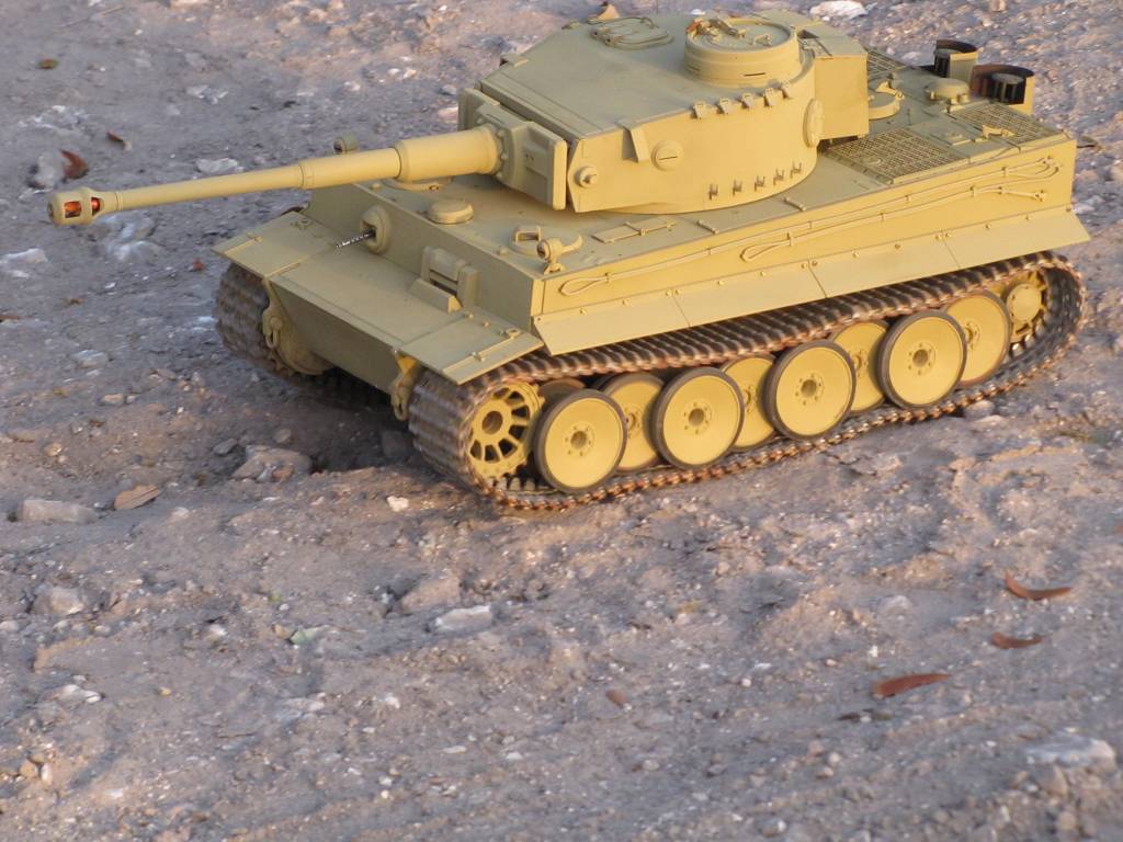

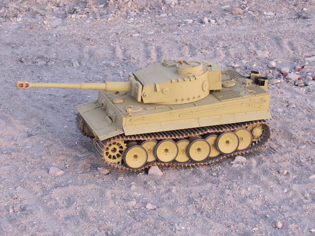

It took a long time to get it done especially with all the pictures but it turned out OK I like it. Still a few more things to finish like the tools and the paint but it is getting there.
BBCKT (Jimmy) wanted to see how I did my smoke generator after he saw the video I posted on You Tube with it running in Danville.
Enjoy the pics!
