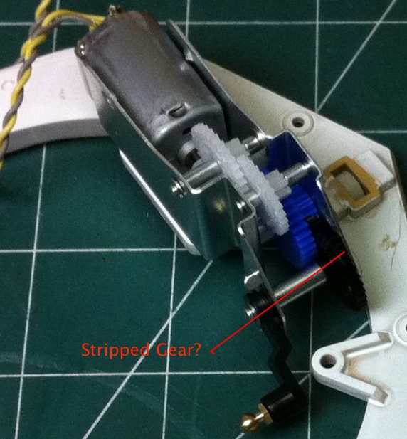

Does anyone know of a source of replacement gears for Tamiya elevation units?
The particular gear I'm looking for is the one on the shaft for the elevation arm.
That gear has a flat to to prevent it from slipping on the shaft.
I managed to strip the gear at this attachment point on my Tiger, so the gearwill no longersupport the weight of the barrel.
I replaced the gear with one on an extra elevation unit I had, but nowthat unit isshort a gear.
Any ideas?</p>

Is it the black gear you are talking about?
I picked up one of the Tamiya Gear set toys for the Blue gears that replace the clutch gear, but none of them seem to match the flat black gear.
You might check out some of the other Tamiya Set like this for spare gears.

Yes, it's the black gear.
I'll try and find some other Tamiya gear sets...I might get lucky.
It would be nice if I could find someone with a broken elevation unit with a good shaft gear.

The yellow gear is similar to the clutch gear without a hole and the orange gear has a round hole.
The shaft gear has a hole with a flat corresponding to the flat on the shaft.
The flat rounded off allowing the gear to slip on the shaft.

Try some JB weld I did this on my KT elevation mech when the slot wore out last spring and it still works today all my other tanks elevation mech are now wired up with limit switches on them now .
Jimmy

I wasn't sure that would hold, but since it worked for you and I'll give it a try...Thanks!

Make shore you get a good amount around the shaft .
