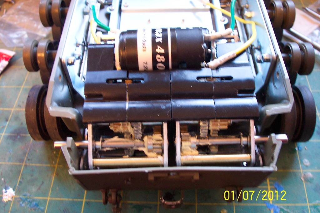

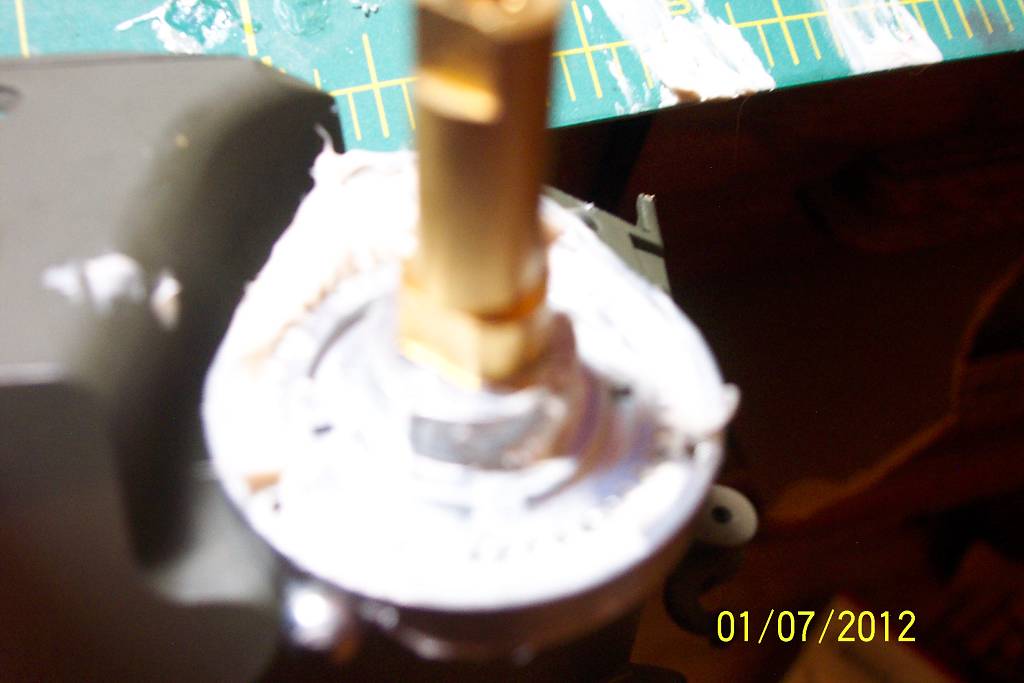

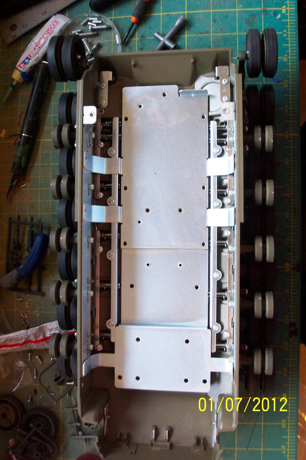

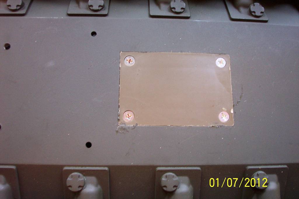

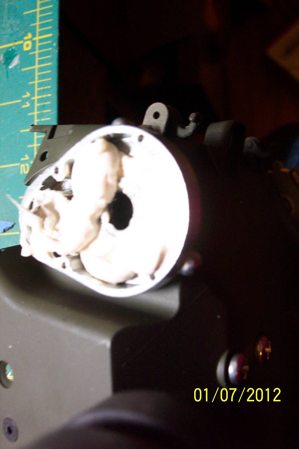

Here are photos of the lower hull, and gearbox/outdrive

Sorry but I have to say you lost most of the bass-reflex effect so most of the frequencies below 100-150 hz were lost with such modification. You still can save something trying to make some hole ( about 1/2 inch) in some place but should look for the best to get the resonance frequency of the speaker.
The size of a loudspeaker with his woofer is not taken at random, but perfectly calculated, more coming from Tamiya, in fact that's the reason they sound so good. If you had made the test whitout the plastic case would be realized the amount of loudness you lost.

Not really. I have already made the same modification to my Pershing and the sound quality is the same. These are not home speakers therefore this small change will not affect it.

cant tell a differance in the quality of the sound and the Bass is still good and if I turn the sound up all the way it is still too loud to run at Danville as it will drown out any tank that is close and revirb off the roof.

The lower chassis is finished and up and running . Speed tests averaged 10.9 seconds for 25 ft which is .01 seconds faster that 25 smph So I am at the historical sustained speed of the M45 though the documentation lists a 30 mph "dash" speed. I will post some pictures later of the layout of the completed chassis and the progress so far on the upper hull.

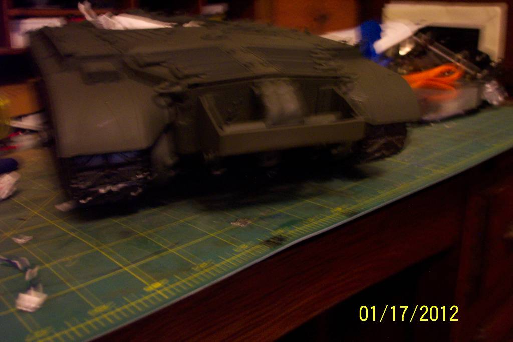

Here is a photo of the front hull.

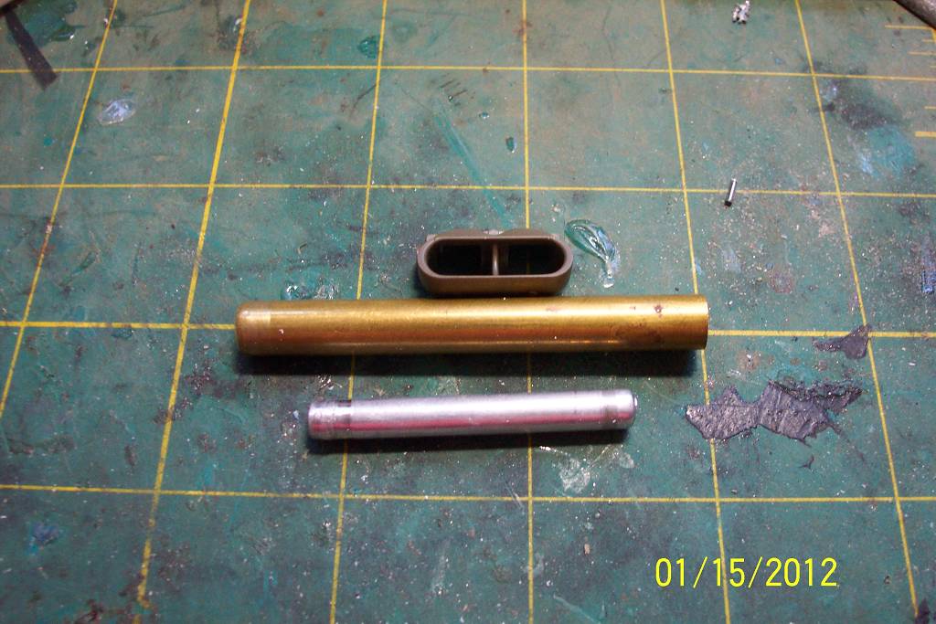

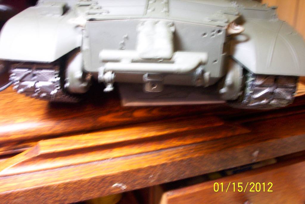

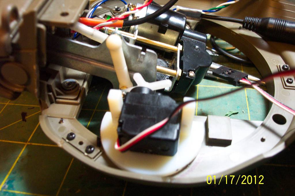

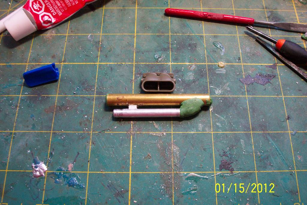

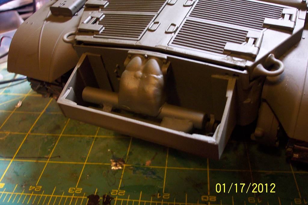

Here are some photos of the exhaust and the servo elevation unit I use. I don't care for Tamiya elevation unit and using a servo allows me to seperate the elevation and firing the gun onto differant channels. The white servo holder is something I designed in a CAD program and then have 3D printed from Fastproto a prototyping service.

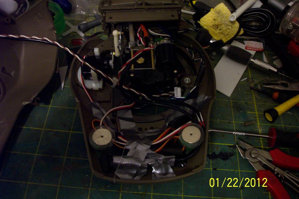

here are some shots of the inside of the turret

Are those magnets holding the turret together?
~ Jeff
