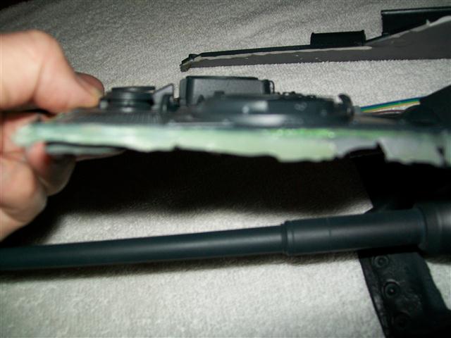

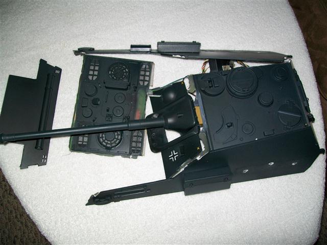

well here it goes...got my tank the other day..hmm. I'll try to keep it short and sweet:
pros: 1.) excellent body kit(fitstogethervery clean)
2.)based on aJagdpanther chassis
3.) good packing
4.)metal tracks and other accessories(tools,boxes,barrel,etc.)
5.) led/metal machine gun and barrel flash unit
cons:1.) EVERYTHING glued together with some kind of "composite glue' that looks and feels like a glue-gun in consistency..... which didn't hold and caused everything to fall apart in shipping

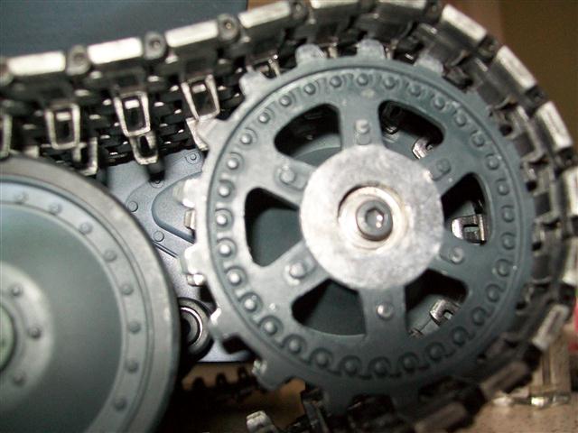

2.) metal sprockets are incorrectones as they are for a Pantiger and don't quite fit the Jagdpanther metal tracks(Teeth are too far apart)....you can see where he filed down about half the teeth to make it kind of fit unless you turn the sprocket, then it just jumps the tracks.
3.) plastic idlers(I was told they were metal)
4.) suspension springs completely dead and won't come back up(not sure if this is common with Jag's)
5.) wire soldering was very bad as he melted off a couple of copper solder pads from the boards due to overheating and a couple were broken off in shipping due to tension.
6.) every nut and screw was loose(not a big deal)...also a few missing screws here and there
7.) paint was suppose to be a german style gray, but is actually almost black in color and has a ton of dust and other crud in it.
8.) he melted the mantlet to fit the hull(clever idea,and did ok job), but still needs a little heatgunwork and some sanding to get it looking better(never sanded and just left the bubbles in it)
conclusion: It's not very good...Warwick is a very nice guy and even with some serious health problems going on he emailed me back and offered a 2/3 refund..which I think is very fair as I will have to spend some money and time to rebuild it(get ready Phil lol). I do think the body kit is extremely nice and would have no problem ordering parts from him in the future(the onesI can't get anywhere else), but based on this example I don't think I would purchase another built tank. Had I known I just would have had him putall the parts in a box soI could do a clean build...but it is what it is andI had to have this tank and I got it so in the end I'm not really bummed...Seems surprising as he has some really nice builds he's selling on his website that I would be proud to owne..maybe it's just this body kit he has problems with..who knows..

Those aren't Pantiger sprockets either. The pantiger lower hull is the same as the Tiger, thus it's name. Those are Jagd/Panther sprockets, it's the tracks that are different, not the sprockets.

yeah, he does sell a kit for like $110 (excellent kit and I highly reccomend it)..The kit appears to made out of fairly thick plasticard 4-5mm. I think If I use a good plastic epoxy and pre-sand the mating areas that it will get much better adhesion then as is. Sprockets&amp;idlers,heavy duty springs,2.0's,and track tensionerswill be the first order of buisiness,,then it will get the full elmod treatment, plus a custom paint job. only took about 4 hours to peel out all the gooey clue crud that was everywhere. yeah it was supoose to be fully assembled but when i got it parts where everywhere..fortunately it was all glue joints so will be easy to rebuild(nothing busted). he did a great packing job, it was just the glue-job that killed it.

Trust me Perry they are Pantiger sprockets, they were available for a short time along with metal wheels(painted tires)back in the day. But they(tankzone)just came out with similar wheels for the Panther G/Jagdpanther chassis that even have bearings..they look almost exactly the same as the old versionsexcept that they fit thethe different series tracks, which is why the old versions won't fit the newer style tracks..

ahhhhh. I am enlightened. Pantiger upgrade wheels. I follow now. I thought people were referring to the stock Pantiger sprockets. This new tank of yours is a conundrum.

I think Warwick just had some laying around the shop and just tried to make em work...they're close but not quite! It's basically a Jagdpanther with Pantiger "Panther" sprockets and a body kit that uses the top, engine cover,and gun/mantletsections of the Jagdpanther body.
