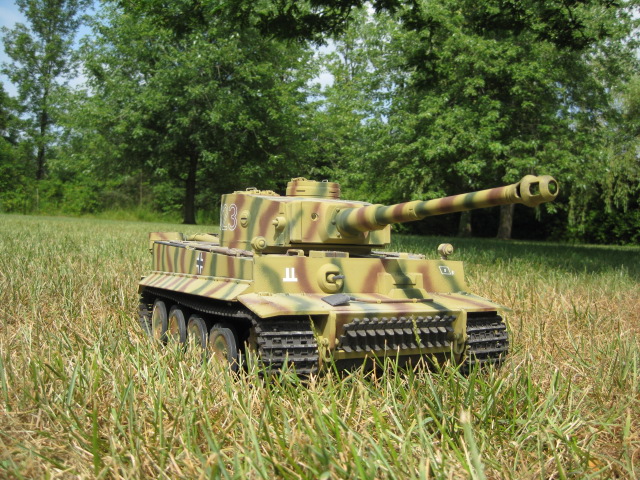

My two HL Tiger I's are converted using SLU's.
I am working on a HL Panther G that is a conversion from airsoft to IR.
