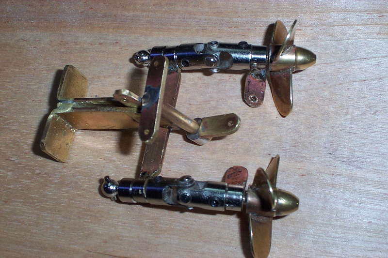

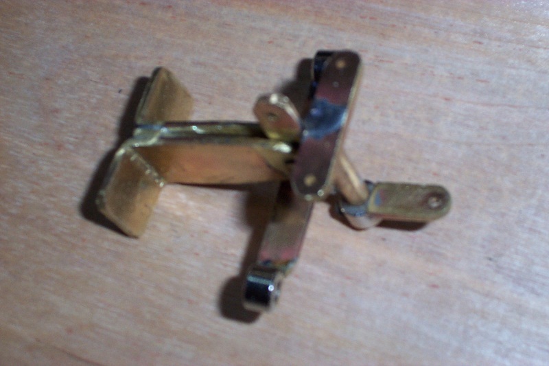

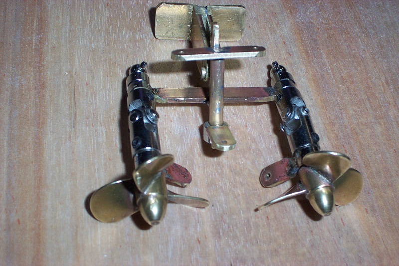

Here are some pictures of the Lift and Turn bracket I designed for this thing. It has been doing exactly what I thought it would do, fight me every step of the way. I do believe I have it licked now though.

How many RPM's and how many AMPS have you figured will be necessary to propel this "anchor shaped" boat through the water Herman? Are there bearings there in the outdrive system? Hope so.

Bushings only. The bearings are in the stuffing boxes. I am still going to have to get with my local electronic guru on the amps, but the RPM's will be the same as the tracks, proportional.

Well, I'm sure it will need to be "proportional", but the amp load and RPM need to be significant to launch this thing.
I raced electric boats and your weight to drag ratio is staggering, to say the least.

Yes, but all I need it to do is to move while in the water. The real ones only did 5 or 6 knots in a calm sea. I will be happy as long as it makes some forward progress in the water! On land the propeller motors will have no load on them, while in the water the tracks will have a minor load from the suspension and weight of the tracks, which is minimal. The only time that they both will have a load on them is entering and exiting the water.

Where is the water-line going to be? How much of the propeller is going to be submerged and even, what size and pitch are they? You don't want the props to cause any cavitation by one, too fast an RPM, too small in size and not deep enough in the water.

I have seen that before, and it is a really cool video. Not sure where the water line is going to end up. I know I am going to have to add ballast to get it down anywhere near the normal waterline. My props are 1.5 in. dia. and will be completely submerged, they are normally used on slower vessels. I started out with boats too. I only have 4 at the moment. 1/32 S-100 schnellboot, 1/35 Revell PT, 1/12 PBR, and a Springer tug. The S-100 has working torpedoes and 3 brushless motors, the PT has been converted to a mid war boat, the PBR has brushless powered water jets, and the Springer is the stand by rescue boat.
