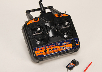

Hey John if your wondering about radios Freakydude at http://www.shop.immortalhobbies.com/...1212121203.htm sells an upgrade system
Johnny

By the time you faf about with all the addons you may as well get a Clark board with a cheap hobby king 2.4ghz radio. Or a second hand dx5e

I am trying to keep the cost down. I have a bunch of futaba radios and I saw one time that there was a motor controler they could use any TX. My motherboard in the tank seems to be out and I noticed there was a company on the net called RCCOMMAND that sold them but they appear to be out of business....
