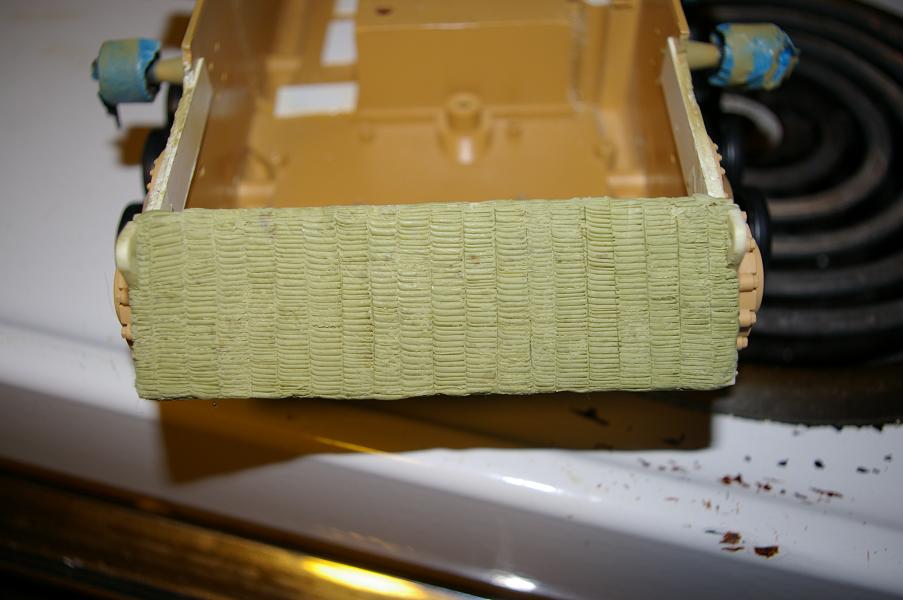

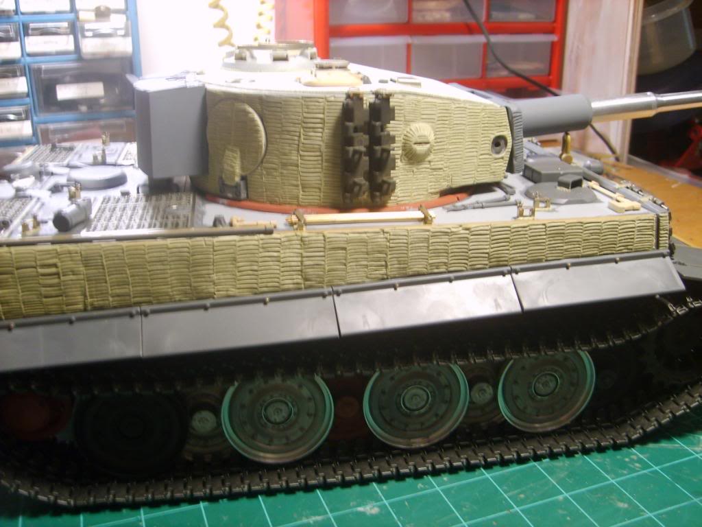

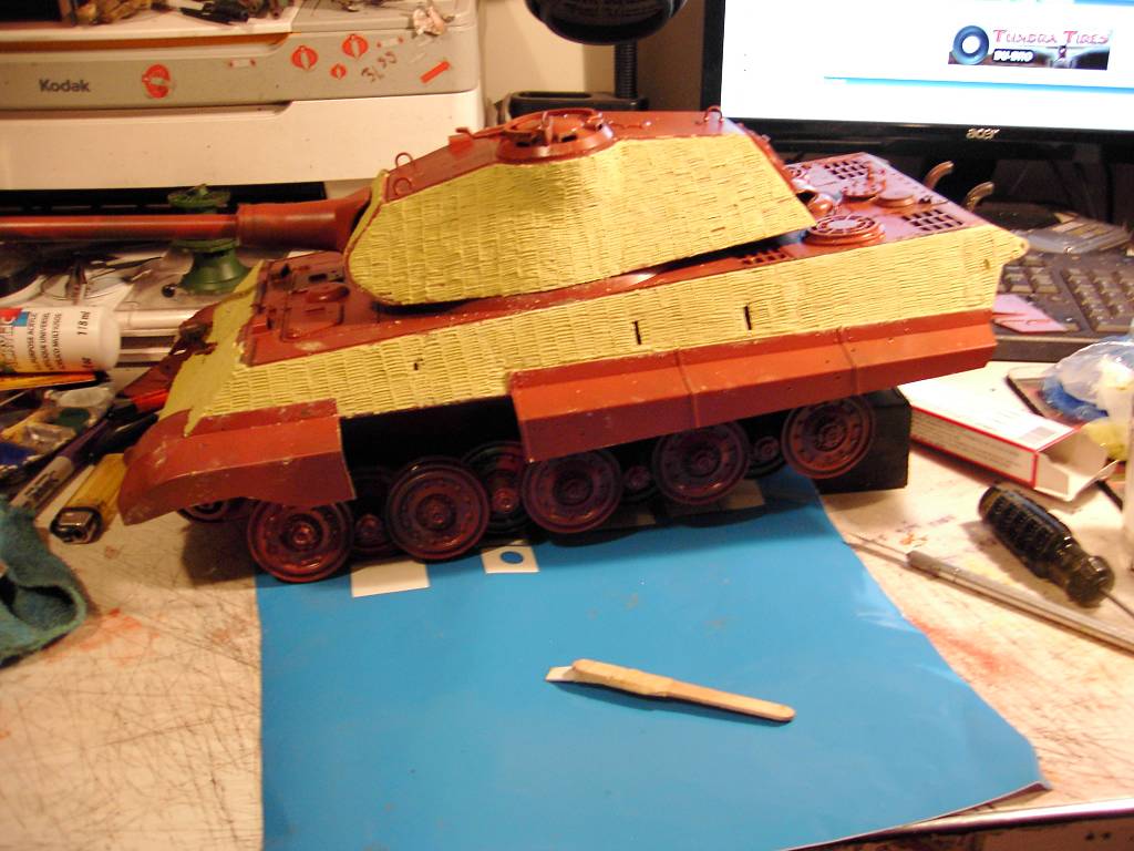

doing a King Tiger for one of the Can-Am Brothers
adding Zimmerit to it using Milliput works good took a bit to get this far i have a fractured hand and arthritis in my hands so a few breaks were necessary
i hope he likes it when i'm done going to do an extra special job on the details and weathering
man this stuff is heat resisting 130 degrees C that's 266 degree Fahrenheit.... hope it don't get that hot.....lol

great job airbrushler,  what are you using to get the lines? I use old dental picks my dentist but my zim is quite as consistent as yours.

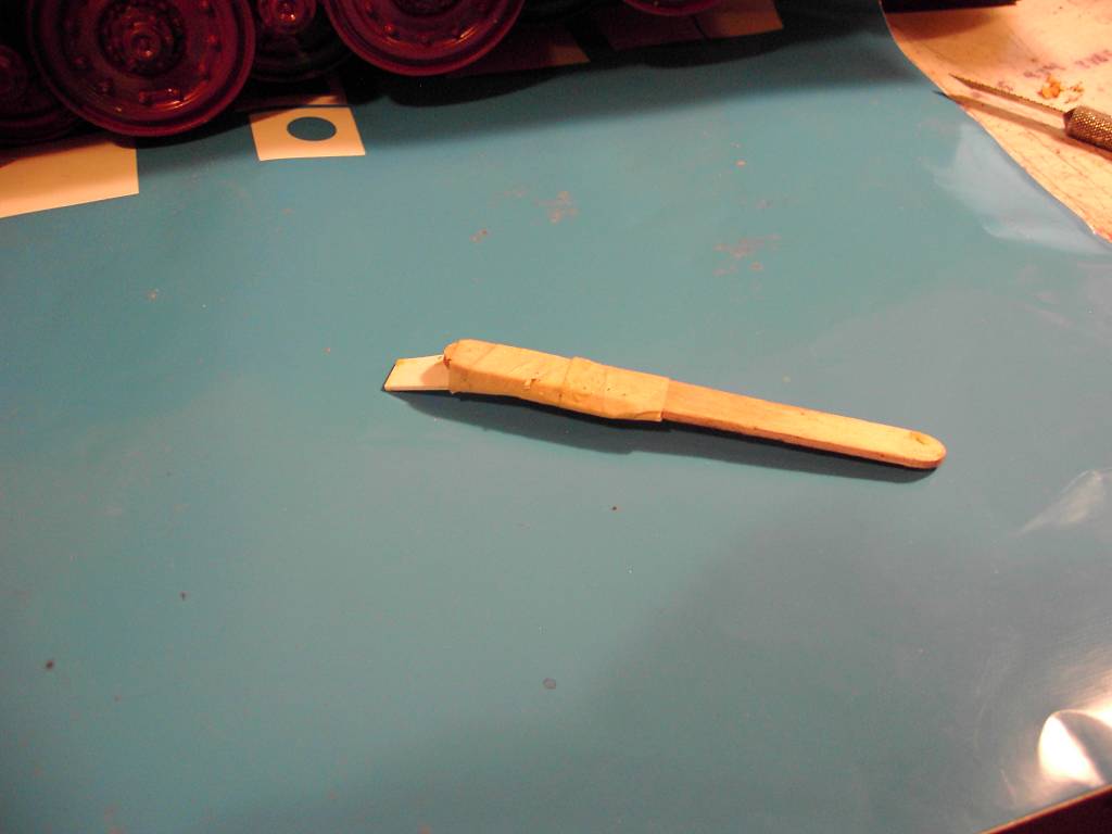

i'm using a piece of styrene taped to a popsicle stick

High-tech! <div>
</div><div>What thickness and width? It's spot on.</div>

not sure on the thickness on this styrene it's about 1/32 thick and 1/4 wide

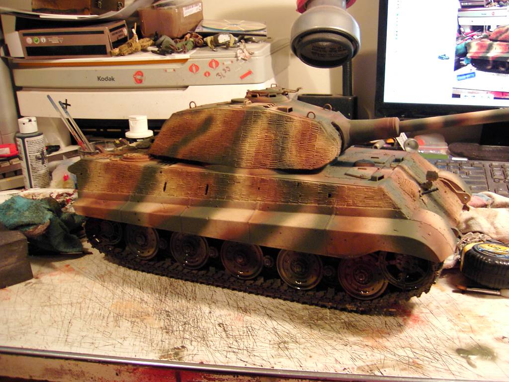

started paint

milliput i think is the best way to do zimmerit. it just looks more realistic to me. attached is the milliput zimm i did on my Tiger I.

Great looking Zimmerit Airbrushler!!!!! I used a gear on a wire handle I made to do this with Milliput.....

A #16 exacto blade works well too but the popsicle stick costs a whole lot less. Nice work airbrushler.

I thought you cleaned off the stove. Zimmerit looks good anyway.

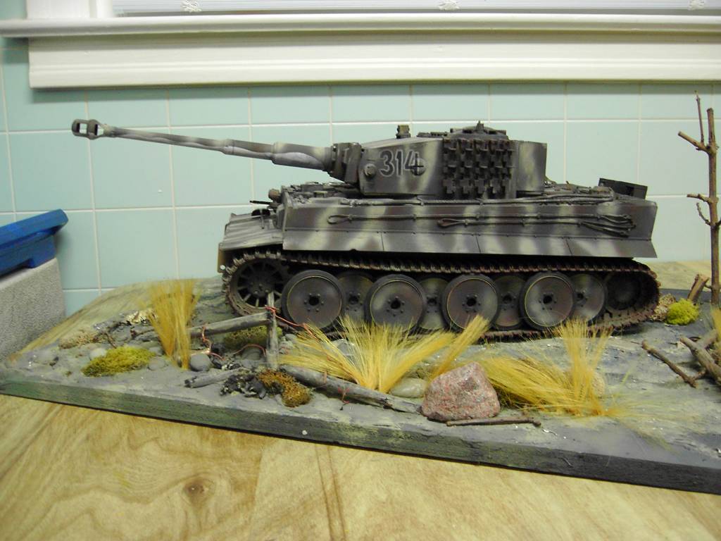

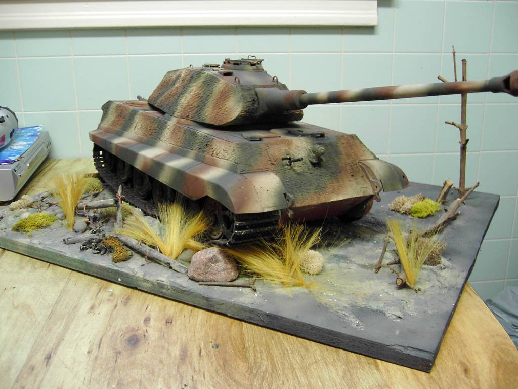

Nice Tiger manchu9inf zimmerit looks great ya i like the late wheels just makes it a bit different i have a WSN tiger still stock no zim with the early wheels not sure what i will do with it yet just fooled around with the paint so far

Also on the zimm, i roll out the milli put like a pie crust to get it thin, then i apply it to the side of the tank and use a flathead screwdriver to indent the milliput. i do usually lay out like a 3 inch long section and do a little bit at a time. I think it looks more realistic than appling the milliput straight to the tank and then scribing it.
