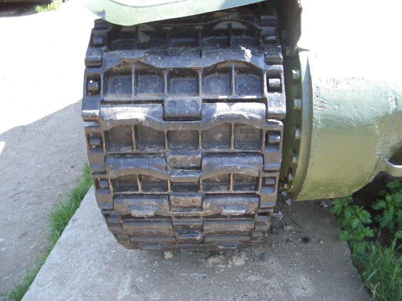

Old 02-12-2013 | 06:39 AM
Joined: Oct 2008
Posts: 178
From: singapore, SINGAPORE
Default RE: M26 Pershing to T26E4 Super Pershing Conversion Help
huge differences between T66 and T81
T66
http://www.axels-modellbau-shop.de/k...eel::3005.html
T81
http://www.axels-modellbau-shop.de/k...els::3010.html
