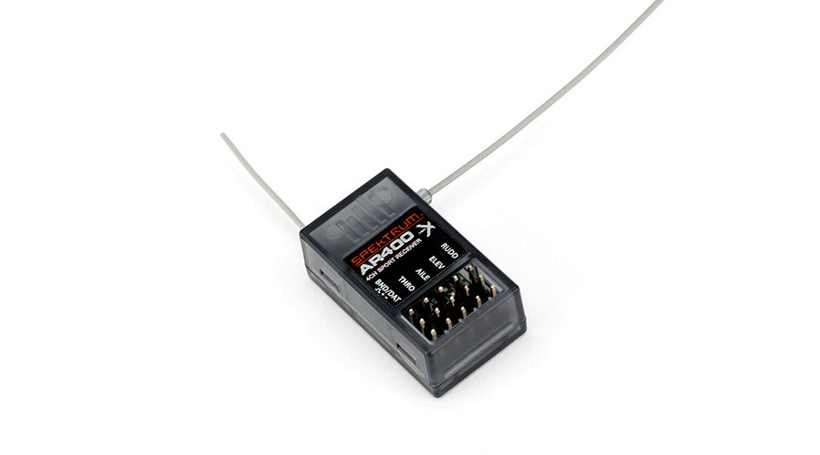

Well i have run into a small snag with my tank's set up and would be i don't have a Receiver for my radio! Which is a Spektrum DX5E however i am not sure which tpye of receiver a tank needs....... Any suggestions\help would be great here guys! I have been eyeing this baby so far since it is in stock locally!

AR400 4-Channel DSMX Aircraft Receiver by Spektrum (SPMAR400) will work with the radio I have 4 AR400 and a AR600 recievers

Your DX5e Transmitter is DSM2, and the AR400 is DSMx, but they should work together. From Horizon Hobby's website...
quote]<h2>Is DSM2 and DSMX equipment compatible?</h2>
Yes! DSM2 transmitters are forward compatible with DSMX receivers and DSMX transmitters are backward compatible with DSM2 receivers. And because DSM2 and DSMX share the same wideband DSSS foundation, all Spektrum users will enjoy superior range, speed and precision whether they're using DSM2 equipment, DSMX equipment or a combination of both.</p>
It is important to note, however, that the only way to experience the full benefits of DSMX (wideband DSSS plus frequency agility) is by pairing a DSMX transmitter with a DSMX receiver.</p>[/quote]

Ah ok thanks! So now the big question i forgot about how many channels would i need since the tank does this..
-Moving turret
-Recoiling gun when fired
-Gun elevation\depression
-Normal Movements
-Machine Gun firing
So ya.... i am worried about how to make a switch on my remote fire the cannon\machinegun maybe i need a 5 or 6 channel?

You only 'need' 4 channels. The cannon and MG work off of the elevation channel (they work off an exponential signal generated when you flick the stick quickly to full elevation/depression).
Extra channels (more than 4) are nice to run lights or other gizmos, but the Persh lights don't need an extra channel. They are run off the turret channel via the dmd.
One of the best things I use for understanding radios and receivers is to get a cheap servo and 4.8v battery pack. That way, you can plug the battery into the receiver without it being in any vehicle, and move the servo from channel to channel. You can verify the rx works, and visually see just what the transmitter's sticks correspond to on the rx.
Fire buttons are very nice for battling, as they let you shoot on the move.

Got a really good deal on these so i just have to figure out how to make my Clark TK20 board fire the main gun with one of the extra switches....
Radio
<a href="http://www.spektrumrc.com/Products/Default.aspx?ProdId=SPM6610">http://www.spektrumrc.com/Products/D...ProdId=SPM6610
</a>
Reciever
<a href="http://www.spektrumrc.com/Products/Default.aspx?ProdID=SPMAR6115E">http://www.spektrumrc.com/Products/D...dID=SPMAR6115E
</a>
Any suggestions? i got 6 channels to work with

Tiger plug your reciever into the clark board as follows, this will have all your tank functions working<div>

what does it mean by Throttle and elevator are reversed?

It means that you must set your radio to reverse the throttle channel and elevator channel. Done with the little switches at the bottom of your transmitter.<br type="_moz" />
