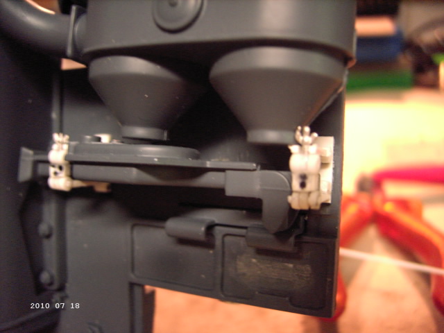

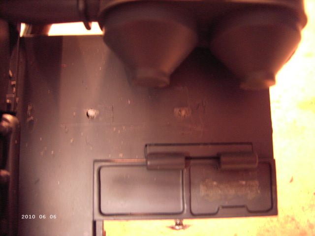

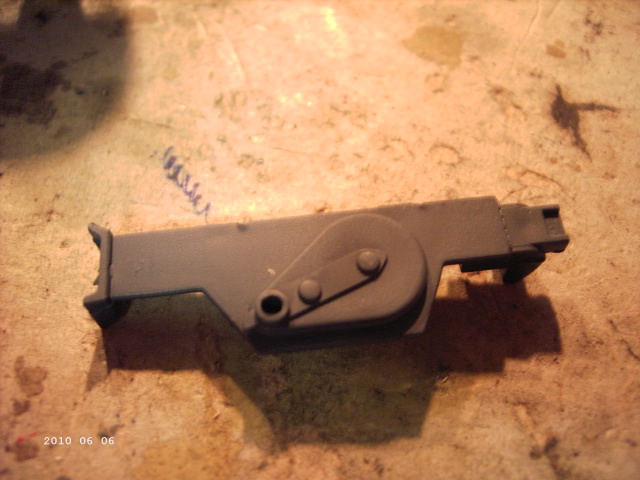

Hi guys,
as you can see, the lifting jack of the Tiger does not have a mount. But it should have one, shouldn´t it?
Well, if there is none, we have to build one. And we will. After finishing, it will be working, too.

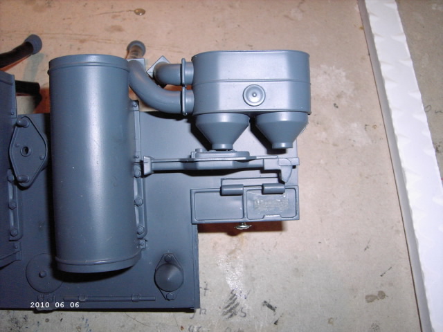

Here is what it should look like.

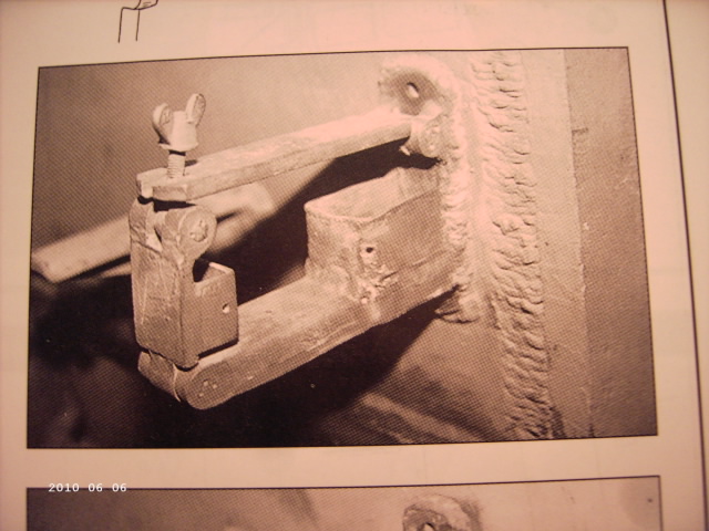

The next picture is an original picture of a Tiger lifting jack mount. Yours should look alike.
Ok, let the games begin.

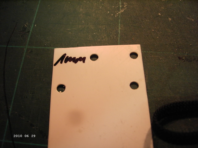

Take poly plates or stripes. You need thickness 1 and 2mm.
For the first component you need to create two peaces as shown on the next picture.

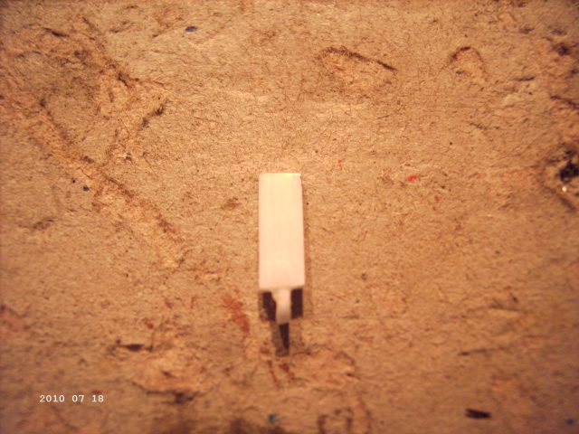

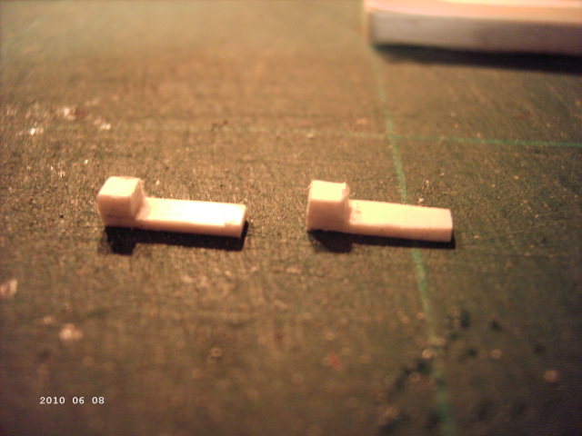

For the second component you need a poly block 2x2x3mm.

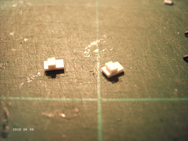

Because this report was created by testing, some parts might show up different than yours. Next picture you´ll see. There should only be a small block without the thinner parts at the edges.

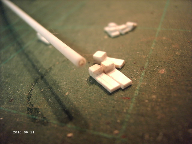

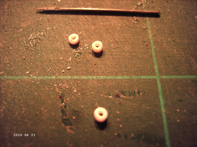

Next we need a poly tube, diameter inside 1mm, diameter outside 1,3-1,5mm. Everthing smaller should work, too. But it will be much more difficult to build.
To adjust the hinch parts, use a needle or a pin with the same diameter.

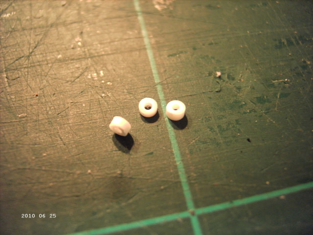

Cut off three slices from the tube, 1mm thick.

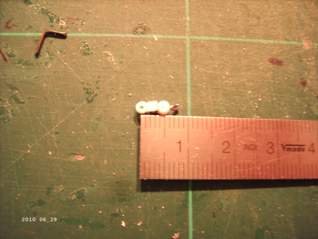

Glue two slices to the edges of component one, as shown. Make sure that the third slice fits between.
Glue the third slice centered to the 3mm edge of component two, as shown.

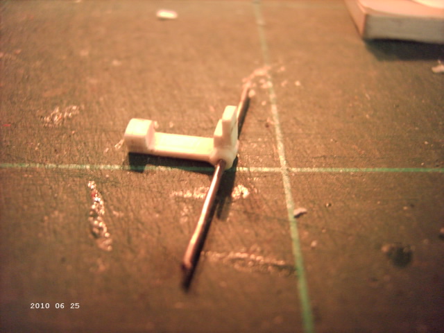

Assemble both components. You might need to do some rework on them to make them working. Then it should look like this:

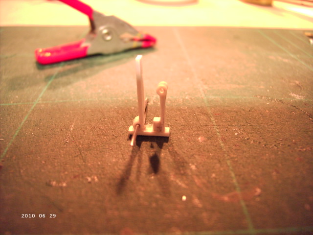

Now we finished two of the needed components. They should look like this:
For fixing the mount we draw a reference line direktly to the mudguard mount.
Fix both mounts in a position the jack fits in without problems. You might try first a little bit before glueing the mount. Remember to leave some space to the exaust system. See the original picture to check out the two still missing parts. And also watch the position to the Feifels.
As a hinch pin we finaly use a 1mm poly pin. You also can use wire or something else, of course. Assemble the mount as shown.
