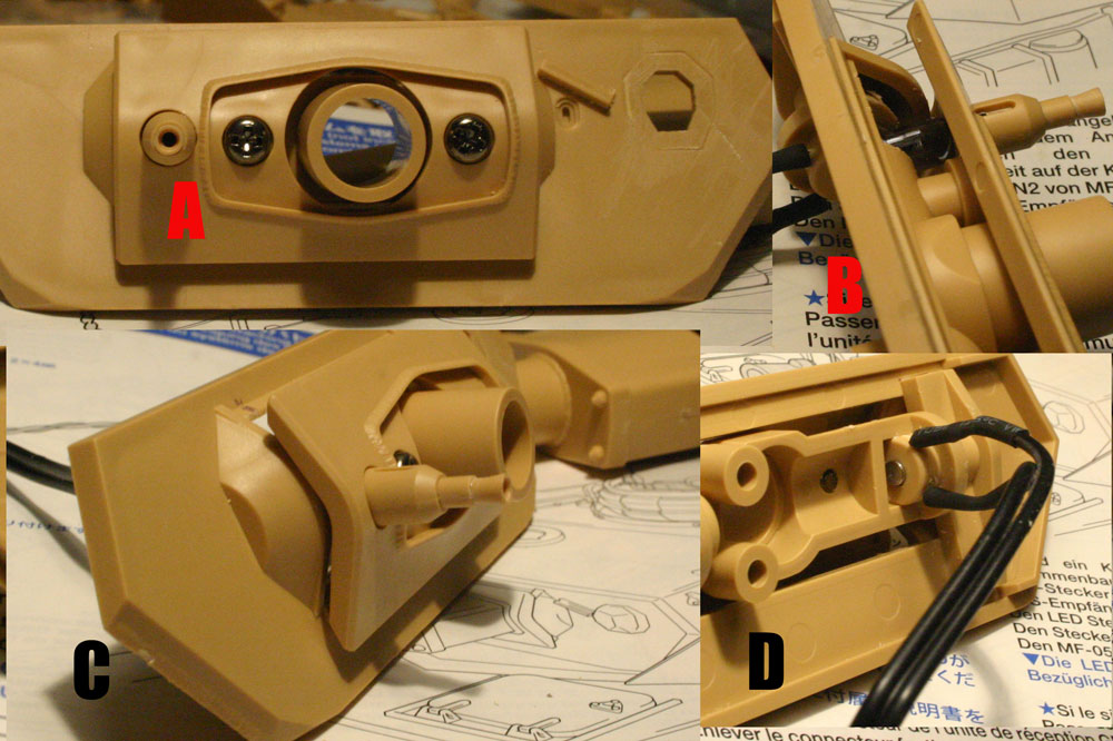

I tune all my IR systems down to hitting the width of a tank @ 30 feet. It's easily accomplished by using a smaller tube than club rules, usually fit into a coax MG barrel or gunner sight so it travels in the direction of the main gun.
The emitter has to be the correct frequency to work with the sensors (I believe it's 940) so I'm not sure if grabbing another type will do. The emitters come in all different angle spreads, but they're primarily meant to activate something like a stereo or TV, so having proper aim isn't a priority in design, hence controlling by physically narrowing the beam.
Keep in mind clubs frown upon too strong an emitter, some guys here have experimented with controlling distance with a potentiometer to imitate range.
Here's my installation on a Tamiya Pz IV:
